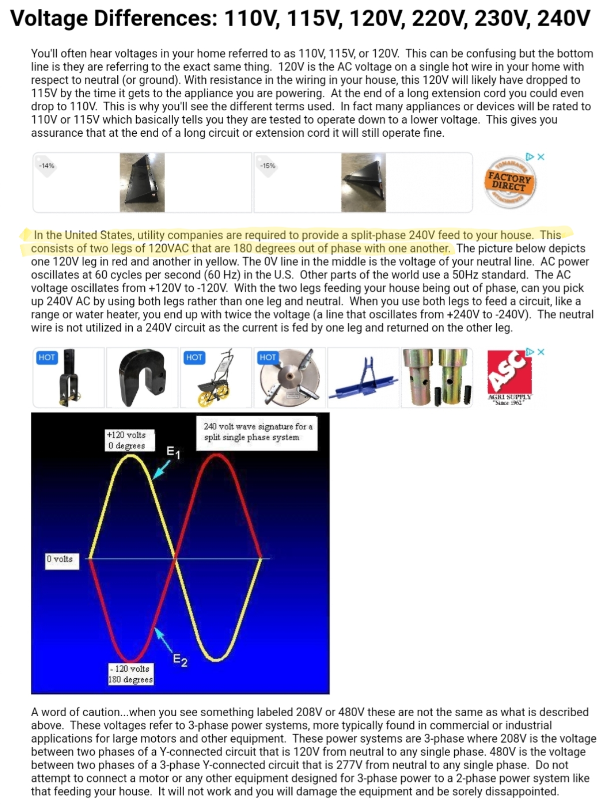

In the United States, utility companies are required to provide a split-phase 240V feed to your house. This consists of two legs of 120VAC that are 180 degrees out of phase with one another.

This sites does a good job explaining.
I knew got that from somewhere, but I'm ready to believe anything.

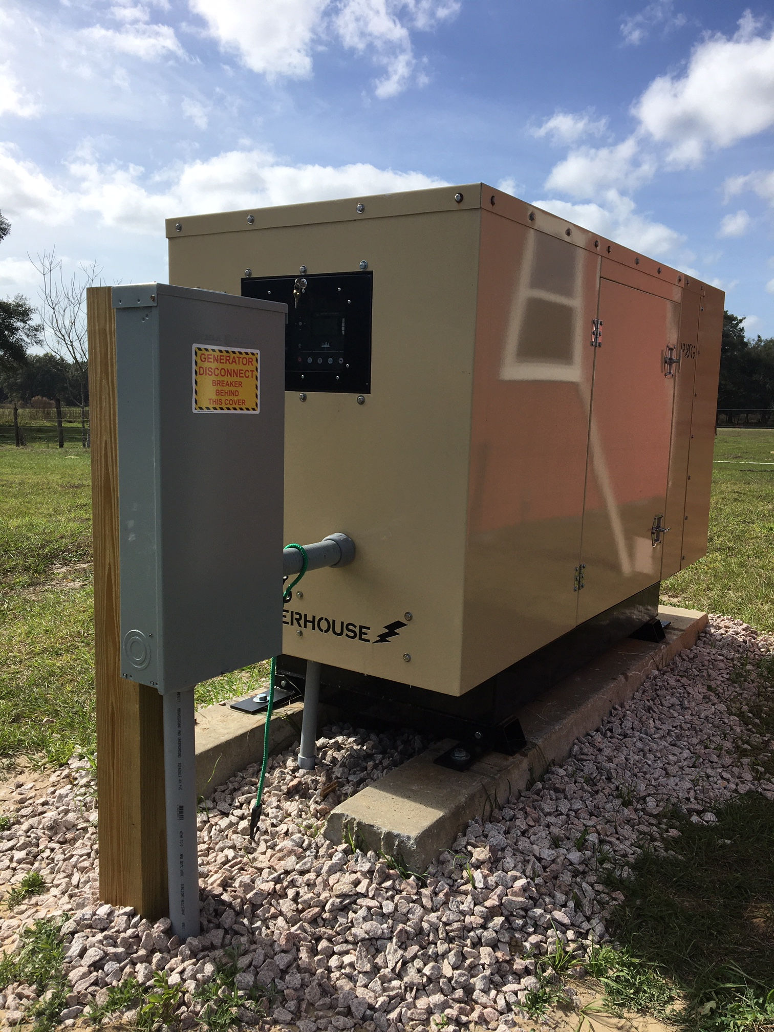

For average home you buy a 4 wire dedicated single phase alternator with digital voltage regulator. Mecc-Alte site will explain the different types available. You can get any size diesel gensets. The one I spec'ed for friend was small turbo charge perkins engine, 36kva mecc-alte 4 wire full size alternator, in a level 2 aluminum sound enclosure on a 60 gallon tank, run by deep sea 7200 line monitor with 200 generac ATS. There is no reason these days to buy a 12 wire head if you will never need 3 phase. Just more cost for more windings.ATS2.jpgOutside1.jpg
