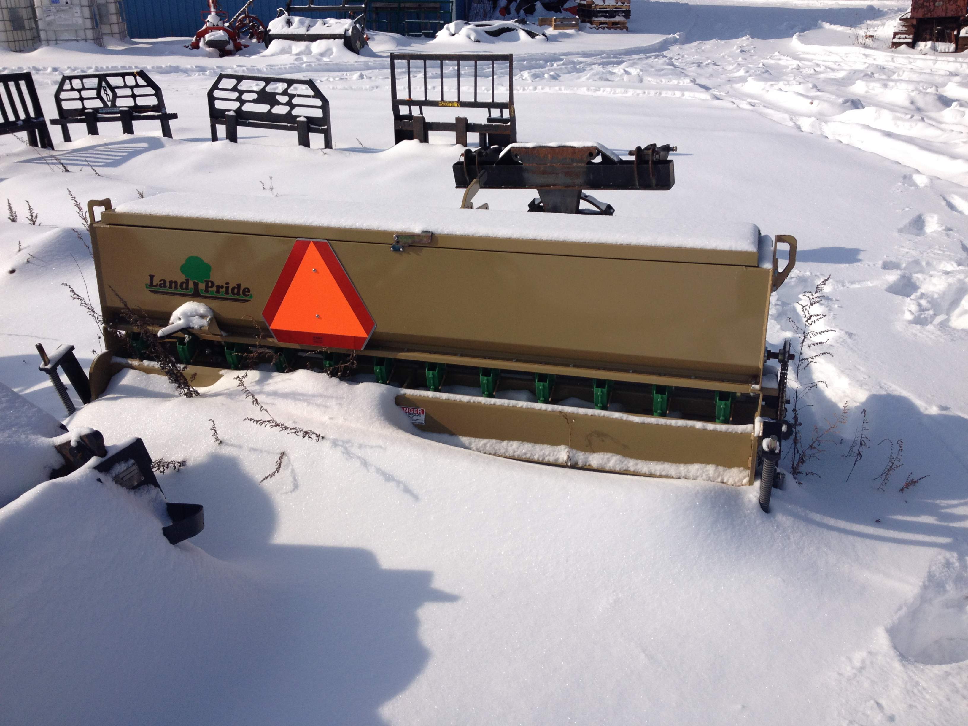

Well I found another Landpride PS1572.
hesistant to pick it up because there is no grains, peas or corn listed on the seed charts. Only does alfalfa, grasses, clover vetch etc.
Up here we have old grain drills, but a small seed box is hard to find.
Would this thing be too small for the tractor in my sig? won't quite cover the tires tracks.
I dunno, need to move on it pretty soon if I decide to pick it up.

That Landpride is a set up for small seeds (grass, alfalfa) and is pretty much identical to the Brillion seeder like my neighbor uses for his 30 acre alfalfa field. For grain you need a grain drill. Here's mine.

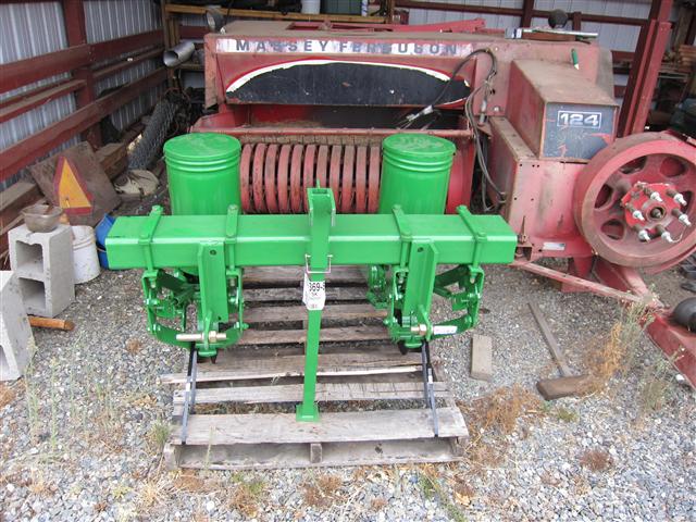

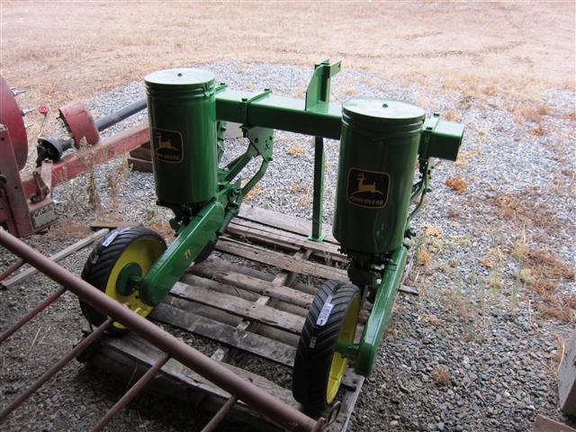

For row crops like corn and beans I use a John Deere 71 Flexplanter, two-row with variable spacing capability.

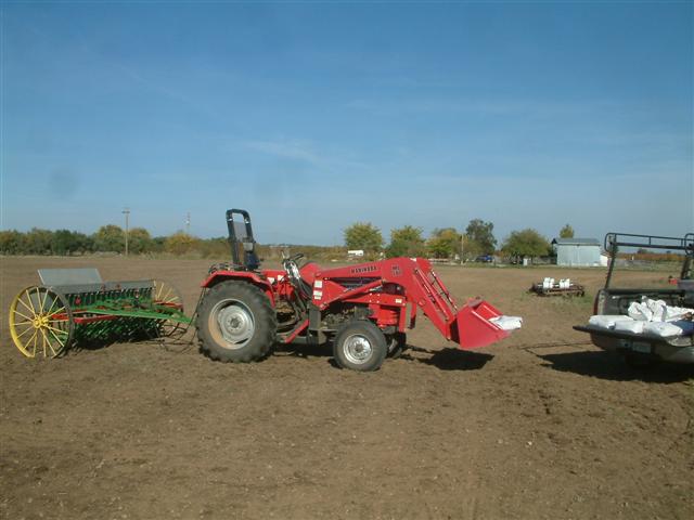

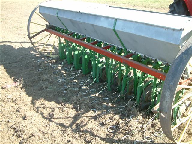

This is our rig. Oliver Superior Drill with grass seed box. We plant wheat, soybeans and oats in the large box and alfalfa and clover seed in small box.
Old but works well.

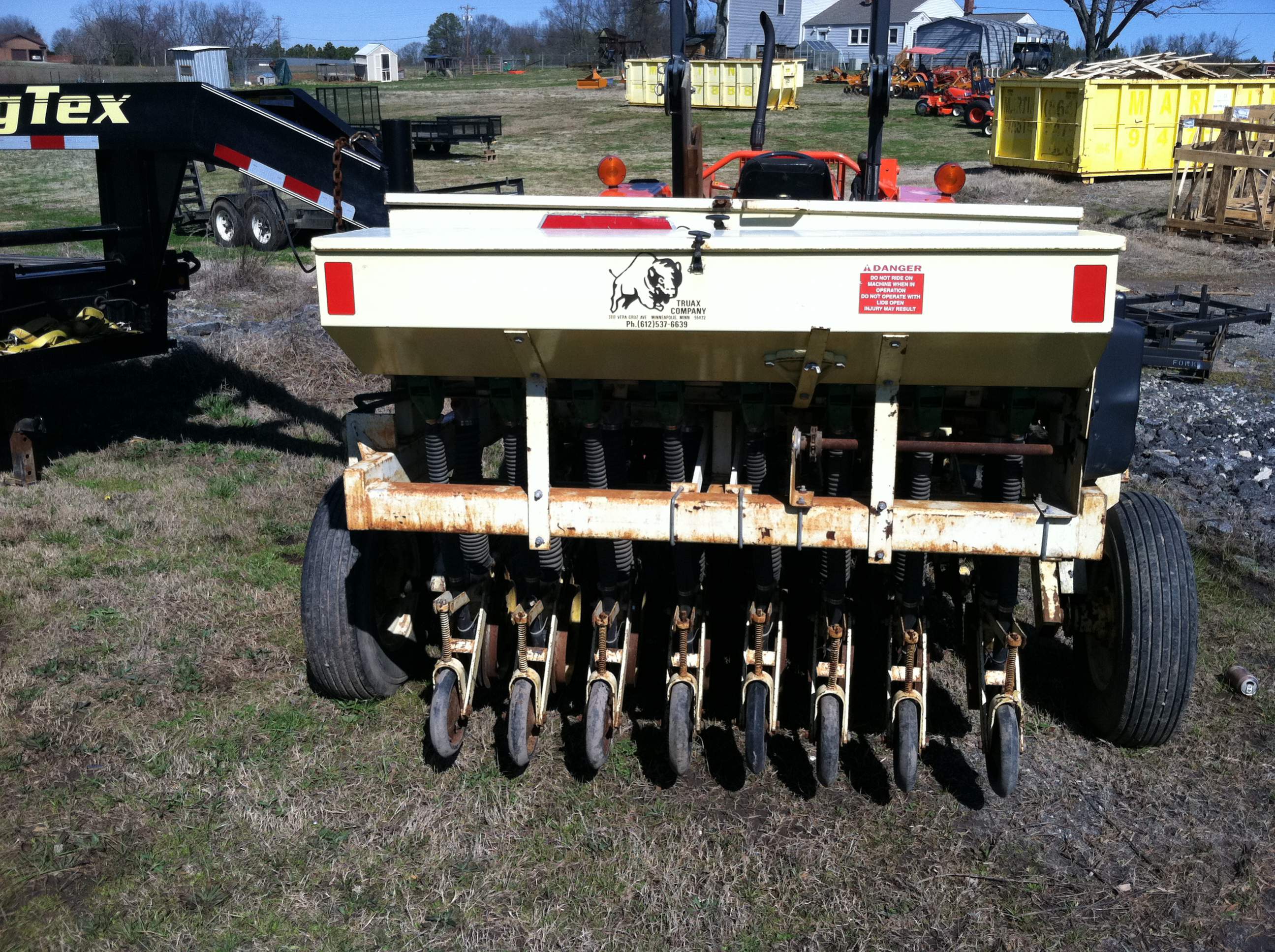

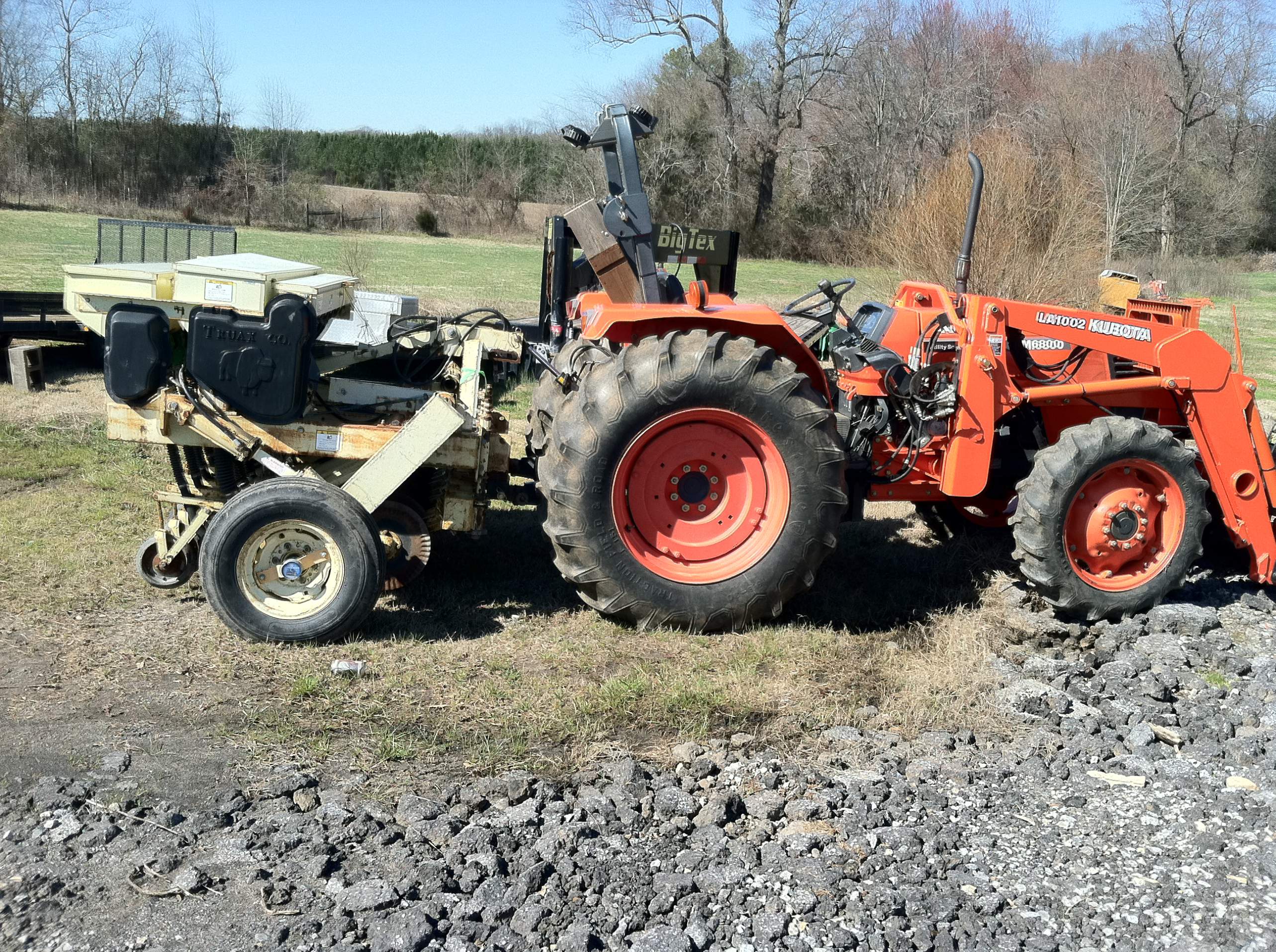

IMG_0111.jpgIMG_0108.jpgI am using a Truax 6 foot no till drill behind my Kubota M 6800. It has three seed boxes that allows for planting all types of seed. It is similar to the Great Plains from what I can see. I bought it on Ebay for about $5000. Works quite well. It can either be towed or used on a three point hitch, but I tow it as it is too heavy for my tractor on the hitch.
