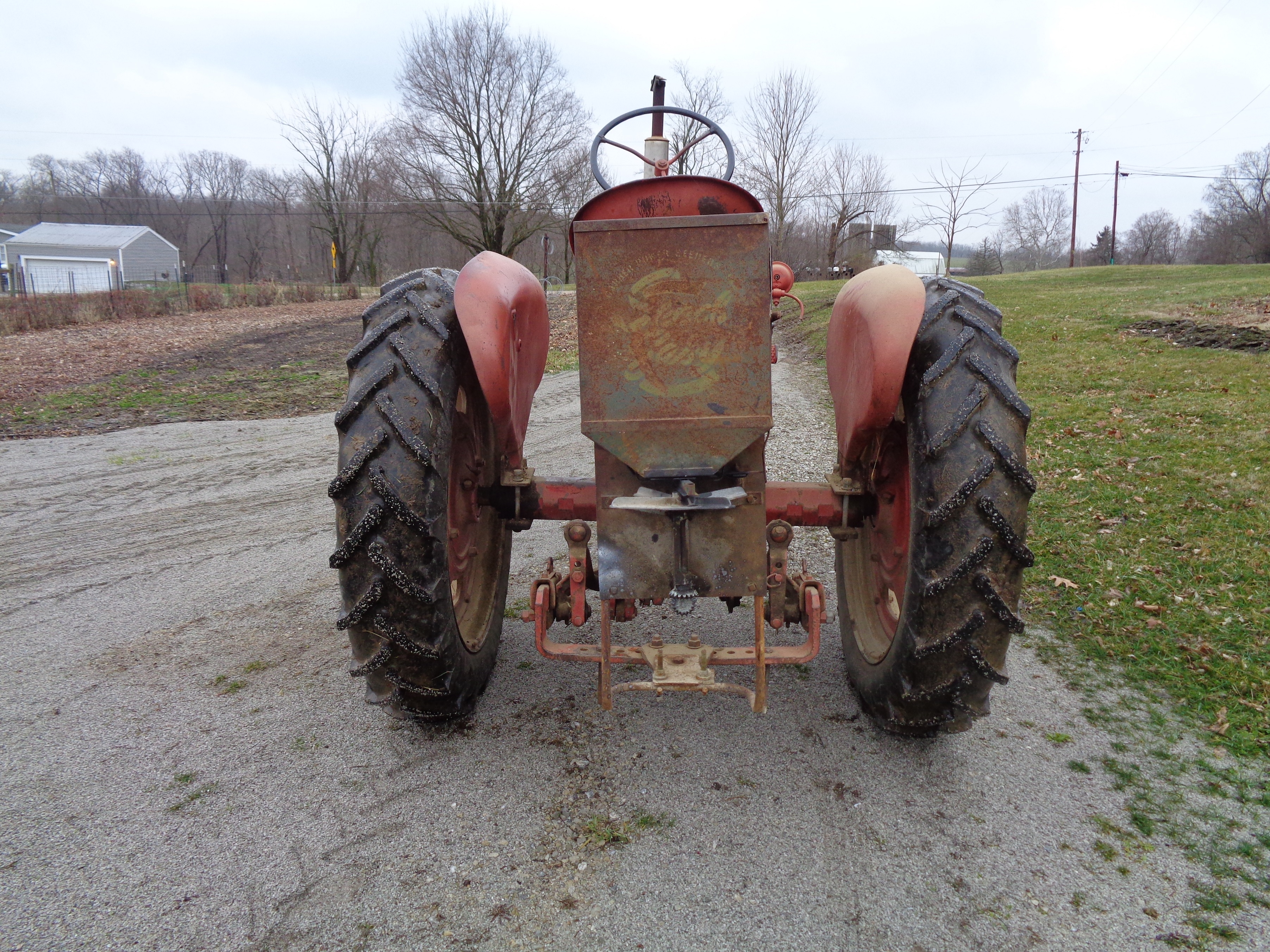

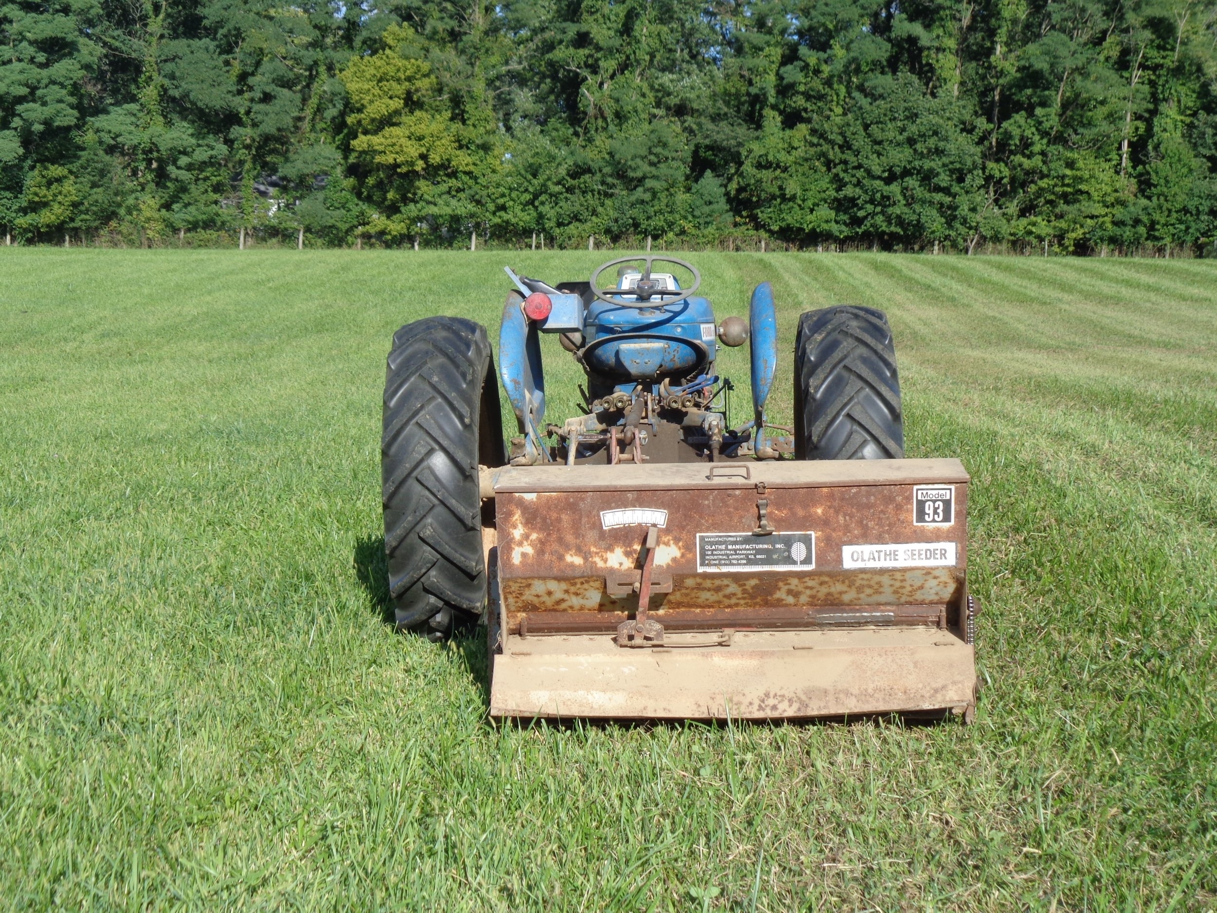

I use frost seeding to sow any pasture or hay seed except Timothy here in central Ohio using my Garber Seed Easy PTO driven seeder. I got a deal on this one for $20. They can be used on any tractor with a drawbar and PTO. A straight section of radiator hose is the PTO shaft. I have a tendency to set it to spread a little light, then run crossways of the first passes to get good coverage. They do a great job. Here in Ohio, it is the perfect time for frost seeding when the ground honeycombs from frost/freeze. When it thaws the honeycombing will close up covering the seed. You're basically mimicking Mother Nature.
For Timothy I seed in Sept, I use a TORO slit seeder. It is PTO driven with cutters to open a slit to drop seed, and small discs to cover the seed. I have it set to a 1/4" planting depth and also does a great job. Much slower than the broadcast spreader, but it can plant seed up to 7 mph. A $100 creampuff I got at a local school surplus sale when they went to artificial turf.
The slit seeders can be rented from equipment dealers that handle them. Last I saw was $175 a day, and it was a Woods brand. This one has paid for itself many times over in rental fees alone.

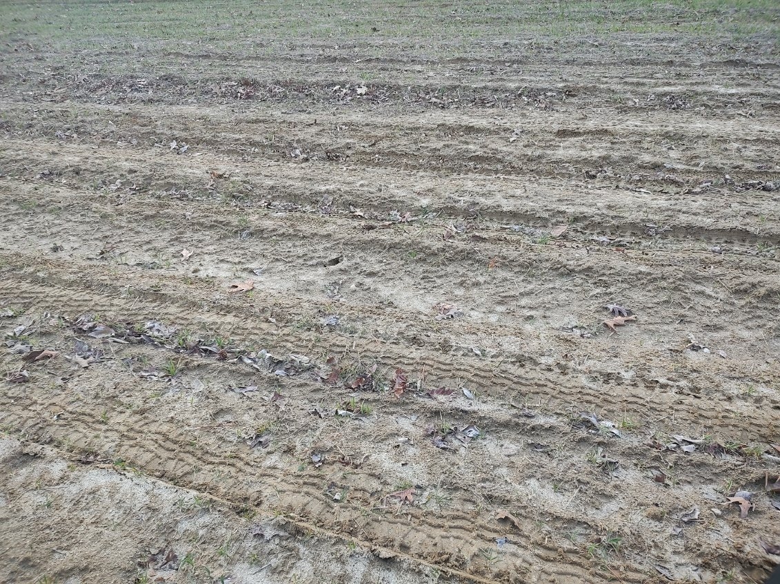

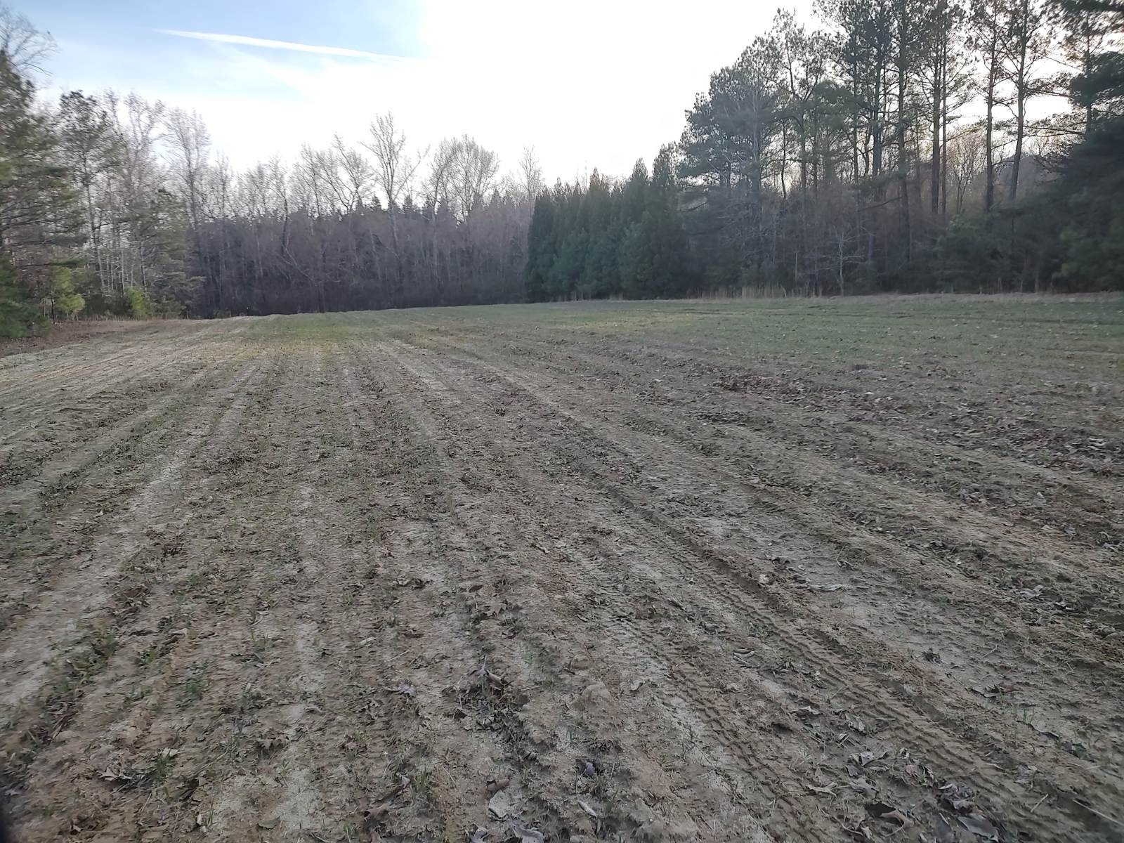

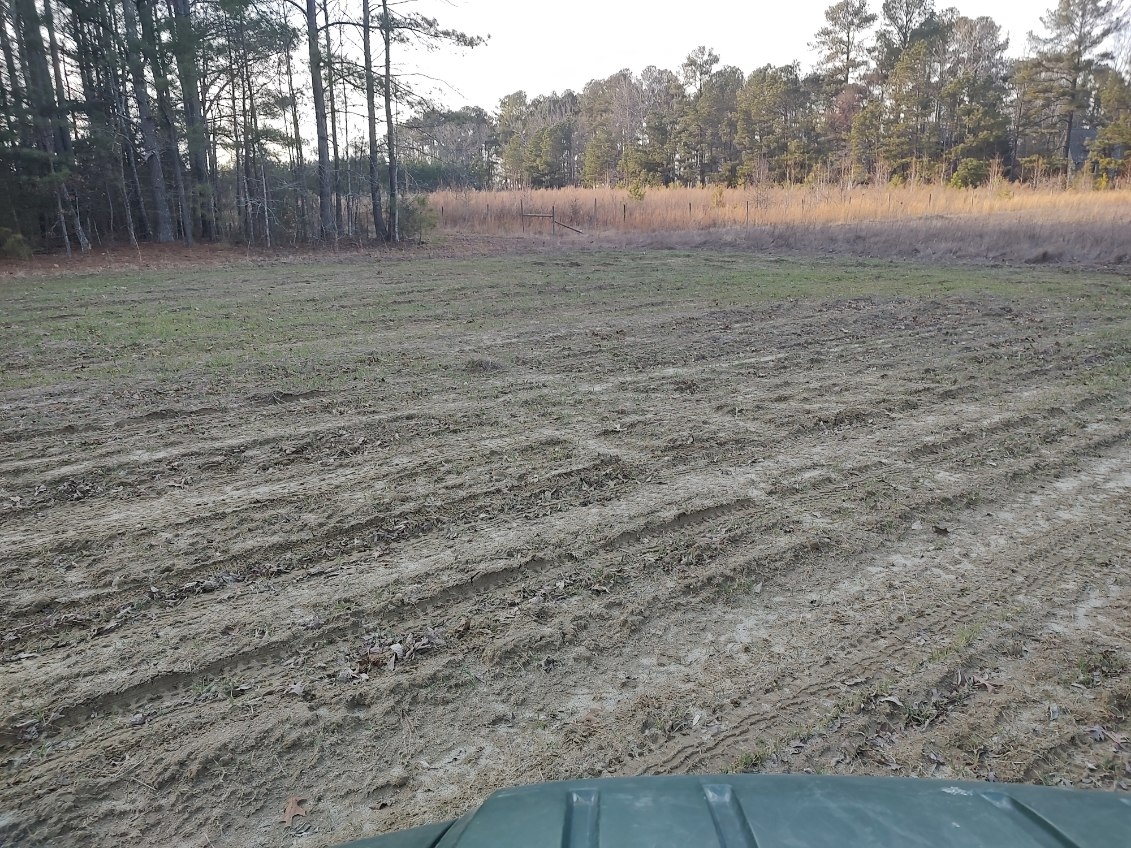

Yesterday I went ahead and sowed the durana clover mixed with some daikon radish and some left over blend of food plot seeds. Put down 240# pelleted lime. I wanted to get it down before the snow/sleet coming later today.
Saturday I plan to do similarly to my hunting property food plots.
Below are some pics of the food plot as is. It actually looked a lot better than I thought it would. When I was hunting it late season it didn't look as good as it does now. Lots of browsing been on it. it had a mixture of wheat and oats. I'm hoping because its so short it won't matter too much with the clover coming up around it.
Gonna go back over it in a couple of weeks and add some fertilizer. Waiting for the soil sample results to determine how much/ratios etc.
My ground stand (sitting behind a cedar tree) is to the left on picture foodplot2. They usually enter from the right anywhere along there. On foodplot2 they enter the plot from the left upper corner. In that wooded section is lots of pine, creek and thick tangles. Has always been a great bedding area. I can only hunt it with a south or westerly wind. Its about 70 yards across and 130 ish yds long. There is more field left to the upper right (foodplot2) that I will disc up and usually don't do a lot with it. There is a subdivision that borders my property on that side. I never shoot past the corner in the foodplot2 pic. Occasionally one will slip by me. Love using my black powder, crossbow there.
