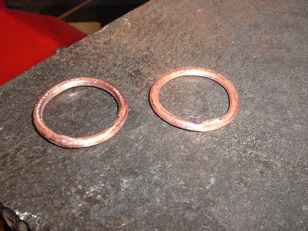

I am not knocking in any way any of the other welders or ideas presented here, but I have had good luck with my little Everlast PA160 amp stick welder. Yes a Chinese inverter welder I purchased well over 5 years ago for $269. I have done all sorts of welding and fabrication with it thru the years. I can also do scratch start TIG with it with a simple TIG torch I picked up for less than $100. This welder has easily paid for itself, and a buddy and I plan to use it soon to repair a radio tower he acquired on the cheap in the next few days. Below is a picture of the little welder and some examples of a few things I have repaired or fabricated with it. I would say I have my moneys worth out of this little stick/TIG machine
/ I have a question about welders... #13
The only welder I have right now is a TIG. I chose TIG because a lot of what I weld is thin aluminum. If you want to be able to weld thin aluminum there are not many options. Some of the new MIG machines with computer controlled multi pulse algorithms are rumored to do it but I don't know much about them. TIG is the most versatile welding process and I wouldn't give up my TIG machine for anything. But it's also the biggest pain in the butt to learn and to run. While I wouldn't give up my machine, I also wouldn't recommend a guy try to learn welding on it, lest he give up in frustration. IMO your first machine should be a capable good quality MIG machine. You can skip the 120V welders and the flux-core-only welders. Your intro to welding will be a frustrating experience if you buy a crappy low amp machine.
My welder is an Eastwood TIG200. I can vouch for this specific welder but I don't have experience with other Eastwood products. I'm considering buying one of their MIG machines. What I really want is a Millermatic 252. Best welder ever, IMO. If you find one used, buy it.

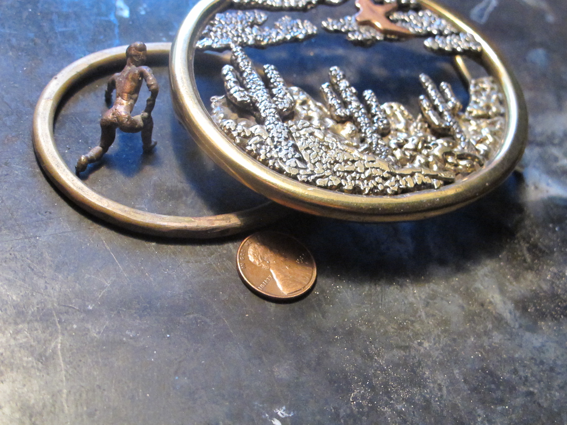

/ I have a question about welders... #14
James, that is beautiful welding on everything you show. And very nice work on those copper alloy? rings...
Newbies take note: those are photos from a real master welder.
But I've also got to say that that just because the master welder can do a scratch start TIG fusion weld in stainless the thickness of your thumb nail without blowing things apart.... and all the while using nothing but a cheap Chinese box..... doesn't make necessarily make it the best machine for the beginner. The beginner profits from the most stable arc possible. And while anyone might get lucky and find stability in a cheaper box, super stable arc is one of the things we tend to find in the more expensive welders.
My advice, start with a good known-brand MIG. Get that one evening lesson. Avoid low end 110 volt machines if you possibley can; go 220V. And avoid the kind of wire feeds that rely on flux-coated wire only. As you get better you will very quickly prefer to use solid wire and inert gas for shielding. The millermatic does all this well.
Of course there is always the torch. Don't forget the torch. It's trickier, but versatile.
An oxy-acetylene torch can do many kinds of exotic metal work.
Here is some tiny torch welding in non-ferrous metal. All welded; no solder.

Well, Scotty, I am a far cry from a master welder. When I go fishing I have been called the Master-Baiter. But that is about it :)
The Everlast was my first DC stick machine. I did have an old Lincoln AC buzzbox which I have since traded off. The little Everlast that I can throw over my shoulder with its included shoulder strap does all that I need to do. I have a few hours on an Oxy/Ace torch, which might have helped a little on my TIG work, but mostly it was all just trial and error. Lots of error I might add. In truth, I only post my better work. I hardly ever show my "crap work". :)
For every chain I have made, or copper crush washer I have fabbed up with TIG, I could show you a dozen things I have blown holes in! :eek:
But the point is , you (anyone really) CAN learn to weld with stick and to do TIG, it is JUST a lot harder, and the learning curve is longer, and the chance to be frustrated is bigger. I don't frustrate easily. And if I do, I just set it aside and come back to it later after I have cooled down.
Many guys have come to me with getting their radios interfaced to their computers, and it isnt that I am that much smarter than them, it is that I will stay with it longer when they given up in frustration, called it a dirty name, and stomped off for a beer. I will sit and "screw with " things until I defeat them.
Stick and TIG welding is kinda like that. Don't expect good results real quick. Of course that varies by person. The neighbor came over a few weeks ago and wanted to stick up some nuts on the end of rebar to use for drive rods to hold down a metal garage. I welded up one and showed him what to do, and he took off from there. He didn't do too bad of a job for having never welded before. He jumped a bit at the arc strike, but overall he done well. Of course I started him on 7014 rod, which just about welds itself, but hey, I was proud of him and his work. Welding on nuts is not the easiest task anyway as it is not straight line welding.
Anyway, enough of my ranting, but my point is I sure don't consider myself a "master welder". but I have glued some things together, and most of 'em stayed glued!. :cool2:
