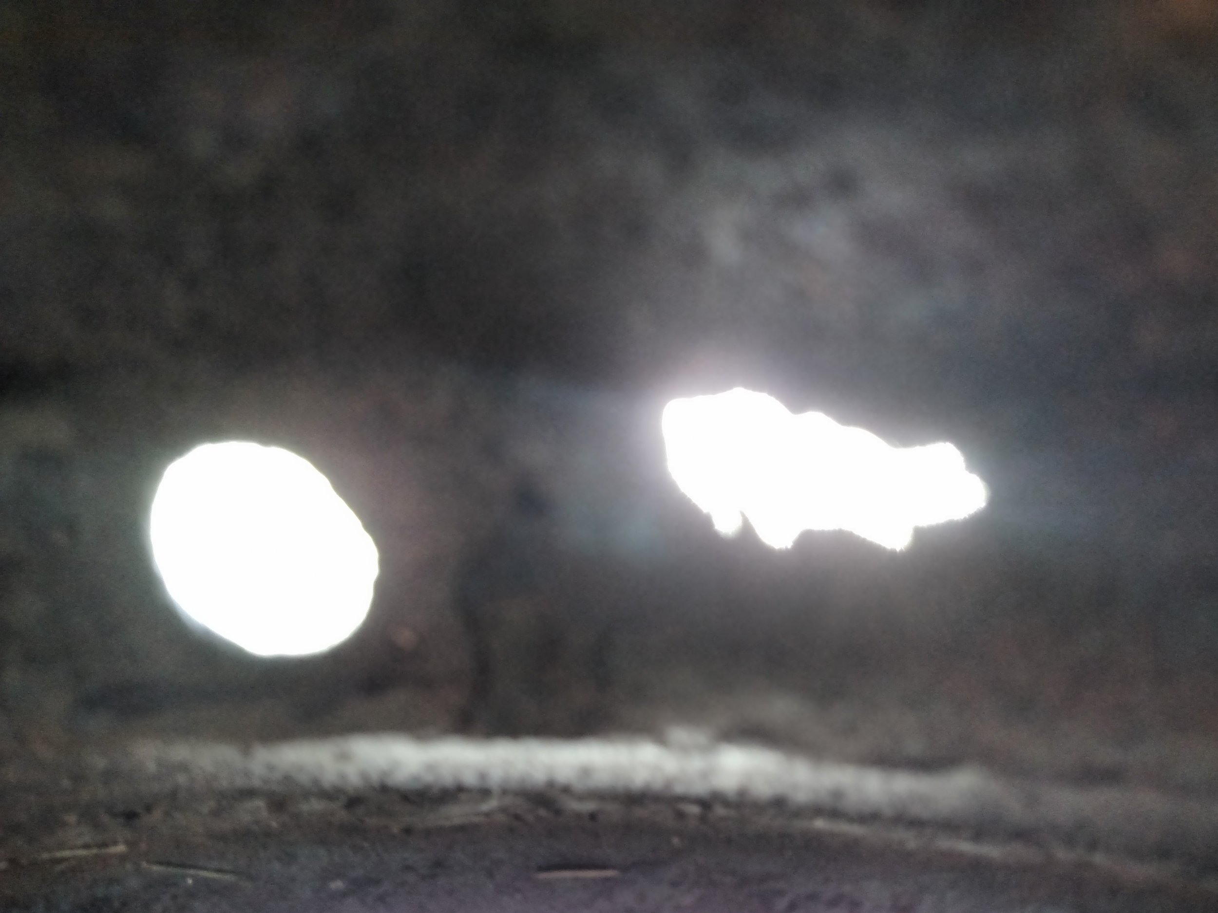

From the picture posted it appears the rims are not showing that bad of damage ..so far... The leak seems slow enough to buy you enough time to find options.. Be that new, used rims.. Tubes, clean and bondo bad spots, what ever is available in your area to solve the issue... It appears you have time, use time quickly and wisely... Do they still use bondo in auto body repair work ??

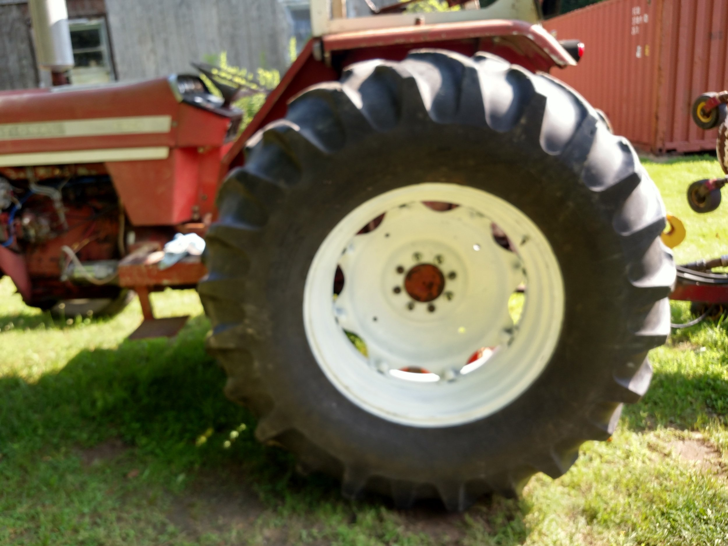

Tractor is 11 years old and I believe they were filled (Calcium Chloride) by the original owner at purchase. How scr*wed am I? Both rear tires are like that. I doubt it's the valve because on the other side, the valve is not even at the bottom. It has a salty taste.
Deal with this sooner rather than later. If it has a salty taste, then you are likely correct in your assessment of fill material. It was one of the most popular until recent years.
The longer you wait to deal with it, the more damage to your rims. Calcium-chloride was death to rims frequently (rusted out to the point of unsafe). Call who you bought it from, you might get lucky and have sometime of warranty (although I doubt it as rusted out rims often require replacement).
as others have said, pump it out (ag tire shop is best bet) then get the tire and tube off, wash down the rim good. Let it all dry, then wire brush the rust, check the rim closely for damage. Assuming the rims are usable.
I now suggest good careful metal treatment. Start with a rust convertor. Many brands are available. Then a good primer, I like self etching. If you want paint feel free, this is a great time to redo the externals of the rims as well. If doing so paint it all.
Use new tubes and clean the tires up carefully as well.
Consider if you want filled tires, if yes use an environmentally friendly option.

As to why they are leaking sooner, if your tires don't have tubes (check the valve stems) that would be a reason. If they've had a puncture and the rims weren't washed before remounting or if they were reassembled with calcium left between tire and tube, ect. Variety of reasons.
A set of tires and rims for a tractor as small as yours are not going to be that big of a bill, these things happen, it's just part of owning equipment. I've had repair bills of more than a machine cost in the first week.

You can drain the fluid out of the wheels into buckets. Just get plastic tubing that fits tight over the valve stem and a valve core removal tool to remove the valve stem. Try to put the tractor above the bucket - you may get several bucket fills per wheel so need to have a place to store or dump it - large plastic garbage can will work to hold it. I dumped min on weeds. A year later the weeds are back.
You can take the wheel to a tire shop - google your are for places that deal with tractor tires or truck tires. Or you can check youtube how to remove it yourself - you want to have good long tire irons and it is a PIA but doable if you have a bit of muscle or leverage (And a friend).
Once the tires are off, check the rim for rust - brush loose rust off and use rust restorer to turn the remaining thin layer of rust black. May need a couple applications. Then use good metal paint.
While you may be able to go tubeless, I recommend using tubes once you have the wheels off. They cost a little bit but provide isolation of any fluid from the rim. You can have the wheel shop order inner tubes or get them online. WalMart sells them if you can't find them cheaper elsewhere.
You can re-use the Calcuim Chloride in tubes but the valve stems will corrode after a few years and start a slow leak you may not notice until the rim is rusted through. You have to watch for leaks and get the valve replace regularly or replace the inner tube. If the stuff leaks on your rim you could get significant corrosion. I got a 2 inch hole and very rusty rim. Yes, you can have it welded ... or buy a new rim like I did. 2 part rim so only $125 US for the . :) After the 2nd rim in 25 years I decided to get rid of the CaCL and find other options, for now, nothing in the tires. My implements are heavy enough for my 8N and the old tractor is happier going up hill.
When you have the shop remount the tires on the rims (with inner tube?) don't have them fill it. Lots of youtube videos on how to fill the tire yourself... What works for your area depends on freezing points. In some areas tire shops will send someone to your place, but in urban areas that can be hard to find. You just have to have patience to do it yourself.
Not filling your tires can give a better ride if they are "just right" and absorb shock but metal weights can be expensive. You can get inventive and make your own balast to go on the 3 pt hitch.
Of course if you have a truck you can rent a trailer and take the tractor to the shop and have them do it all ... much easier.
