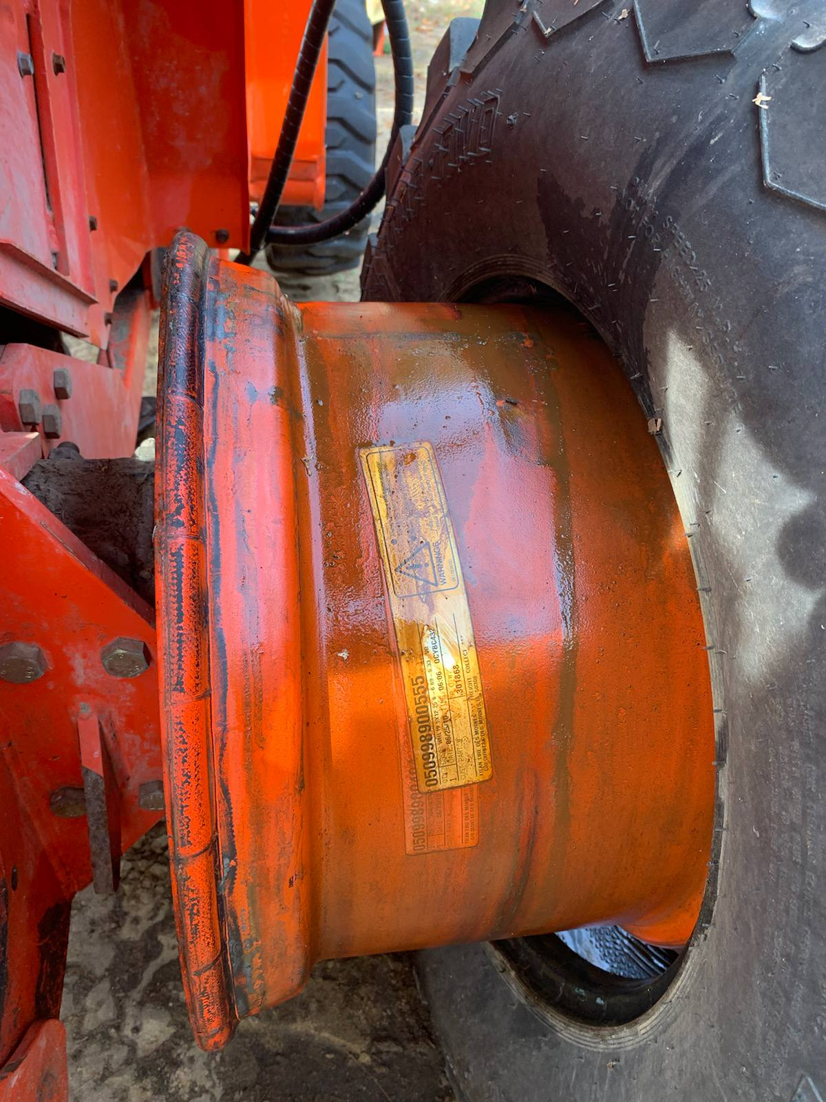

Got a quote for $535 to come here (45 minutes away), empty the NaCl in bins, remove tires, grind the rims, install tubes, reinstall tires, refill with original NaCl. They are coming next week.
/ I have a bad feeling about this
#79
This is what the rims looked like. Awaiting the final bills. Tires were patched and according to the technician (I wasn't present unfortunately), they fell off and needed to be replaced. They now have tubes and topped up with NaCl since one wheel had less than the rim height. Thanks all for your help.
/ I have a bad feeling about this #80
F
Those pics show the old tires still had the vent spews. Doesn't look like a tire that would "fall off the rim".
Did they save the "old tires"?
Or did they say "well they were so bad we had to charge $100 disposal fee".
And the rim looks like it got the original paint worn off in places.
