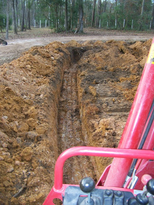

Eddie,
In the photo I am removing the short concrete that is joined to a 12 inch black plastic culvert. This spot , as you can see, could be enlarged to 18 inch culvert. The driveway is clay with concrete wash out over it. Tilt the culvert up a little and it should be at the right elevation.
We get a lot of rain water coming down the road and ditches. Don't really want all of that going into the pond. It goes through a culvert right next to the dam. I have some wet weather springs near my work shop and barn. But I don't think I have any near the pond. We will see. I can see how it can be a fun game trying to either keep water out or searching for more when it rains and how to divert it into your lake.
hugs, Brandi
