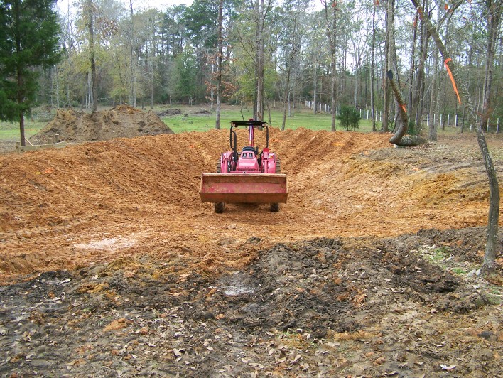

It took my Mother dying to get me off my butt and dig my pond. The cementary she is buried in has a large pond with an island and several ducks and geese. Even a Mud Hen! So I told my daughter it was digging time. We had mallards when I was little and now I will have them again. Along with Channel Catfish. I thought I would be digging a lot of the pond with my backhoe. But too my surprise, I have dug down to about 5 feet with my 84 inch wide loader bucket. When the bucket gets full of clay, I see it just rolling over and over as I creep forward in low 1st gear.:cool: I could go deeper just using the loader bucket, but the pond basin is too small to turn around safely. I don't even have a tooth bar.:rolleyes: The ML 275 KMW loader on my Mahindra 6520 4WD is absolutely a tough mule.:D I have heard all kinds of noises coming from it while moving full buckets of damp clay.:eek: Every day I rinse off the attachment welds and check for cracks........none so far. ;) So I am now in the process of backhoeing about half the 30 x 60 foot pond out to a depth of 10 or 12 feet.:) I really haven't decided. I keep reading conflicting information on small pond depths.:confused:
hugs, Brandi

Hey Brandi,
A few things that I've learned about how deep to make a pond. Most of the fish spend their time at 4 feet of water or less. Since ponds drop in level during dry times, the deeper the pond, the longer you can go between rains and still have enough water in the pond for the fish.
Then there is the 6foot rule for plants. If the pond is less then 6 feet deep, water plants can take it over. Water more then 6 feet deep stops just about all plants from being able to grow in the water. My big pond is 8 feet to 12 feet deep. I wanted that depth to control the plants more then I was worried about the fish. In my area, there are ponds and massive lakes that are choked full of water lilies. Once they get established, it's a better to keep them under control.
The steepness of the bank also has allot to do with keeping the invasive water plants under control. The quicker that the water gets down to 6 feet, the less shoreline plants that you will have.
How will you fill the pond? do you have good drainage to it? Or can you improve your drainage? I built roads that catch water that would have gone past my ponds and now that water follows the ditches along the roads to a culvert that feeds into my pond. This is an ongoing process that I'm constantly looking for ways to make even better.
Keep us updated and thanks for the pics,
Eddie

Eddie,
I am planning on 3 feet deep shores, but now may go deeper, from what you mentioned above. The pond is so narrow, if I sloped everything 3:1, I would not have any deep water. I might have screwed up. With the dam at 3 feet or so, I came away from the dam 3 feet and then went down 10 (max depth) straight down. I have only did this on half of the deep end. Did I screw up with my hard packed clay?
This is shown in the first photo. Also, the non-dam sides will be cut down straight with no slope to around 5 feet. The second photo shows the leveling device I am using and the third photo is on the bulkhead around the cedar tree and pet graves. The slow steady drizzling 1/3 inch rain the other day put 6 inches in the basin about 12 x 16 feet. I think that was good. I can divert my road ditch to fill it, but the water company purges their system in it and I don't want chlorine in the water after fish get stocked. I have also been thinking about berming around the yard (it is really in my back yard) upsteam to divert water into the pond.

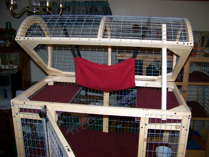

Ultrarunner,
Thanks! Glad I can inspire at least online. I have been busying building a ferret cage for a Christmas present.

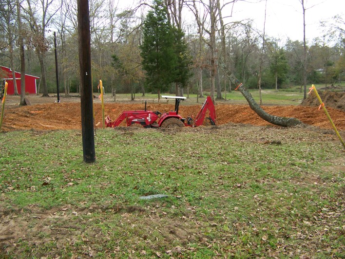

Ctpres,
Tell the Mrs. that a pond can be a place for quiet times for the two of you and also all the romantic full moon nights y'all can have there. Ponds designed and landscaped properly will increase the value of your place.
Here a photo to give you an idea of the size of my pond. My loader bucket is 7 foot wide. The bent oak on the right will be able to sit on and fish. The bulkhead for the cedar is on the left.

Just a couple of quick points. I wouldn't advise going any steeper than 2:1 on the inside of the pond slopes. The sides will eventually cave in. Dirt just doesn't want to stay in place if it is that steep. 1-1/2:1 is even pushing it. You look like you have good sandy-clay soil,which should hold water well. The other point is you are better off to actually divert any water run off around your pond. The reason being that this run off will carry large amounts of soil in a hard rain and eventually over time silt in your pond. If you have a spring that can feed it thats the way to go. Of course maybe the run off is your only source and techneques vary regionally throughout the country. Run off water might be an acceptable way to keep your pond filled. From you pictures you can go steeper on the one slope,but not as steep on the other slope. Also the dryer you can keep your pond while under construction the easier it wil be to build. Once things get wet sometimes you won't be able to get in to move material with the machine you are using. Sounds like it will be nice once completed. Keep the pictures coming and work safely.
Good luck and enjoy your pond!
Sincerely, Dirt

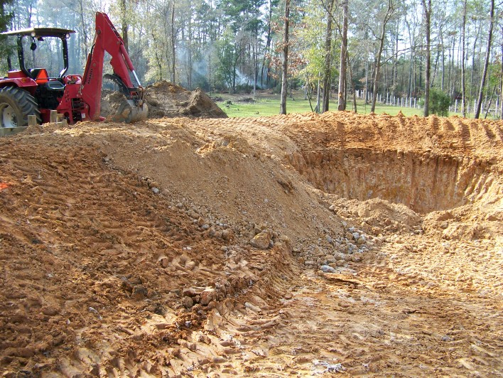

I dig down 6 inches here near the house and hit solid clay. Never the less, I dug down two feet into the clay to cut a keyway for my 3 foot high dam. My backhoe bucket is 24 inches wide. I think this is overkill, but I did it. Then I filled the keyway with clay and packed it in with my loader bucket full of clay and kept running over it, adding 6-8 inches a layer. Then packed again. I did the same for all of the dam also. The pond basin is in solid clay, so their is no need to pack it down.
Here is a photo of me digging the dam keyway.
