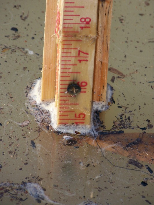

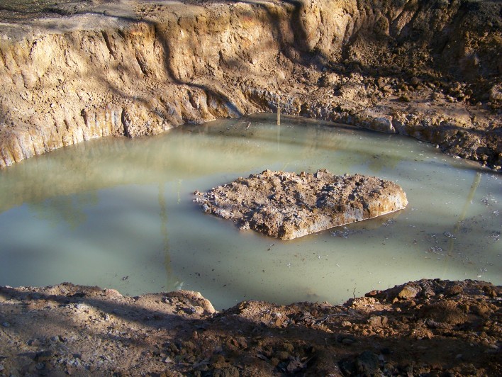

Your right on about the water table. I have mixed emotions over that. My pond looses a lot of water, but it comes back faster.:(:):(:);) It took two months to drop down and only 3.5 inches to get it back almost full. I have thought of using bentonite. My size pond should be small enough to not have too much "sticker" shock on the price of bentonite. I really want to keep it as full as possible. Normally down here we have a wet June and that, along with summer thunderstorms should keep it full. I am still thinking about daming my road ditch and diverting that water into the pond.;) I would have to convince:rolleyes: my water company to not purge the water line on my side, but run a 3 inch or so water hose across the street.
I got a hold of Advanced Drainage Systems' product catalog and will be buying a waterproof elbow for the overflow pipe. This will raise the water level 12 more inches when full.:cool: Maybe then the water loss with dry spells will be acceptable.:)

Is the water level steadily dropping? Most ponds will lose water for quite awhile when they first fill up with water. I takes some time for the soil to get to that point where it holds water. While Betonite will sometimes seal a pond, you have to really mix it in with the soil after draining the pond. How much to use and how far up the banks, plus how well to mix it with the soil is all a big part of getting it to work.
