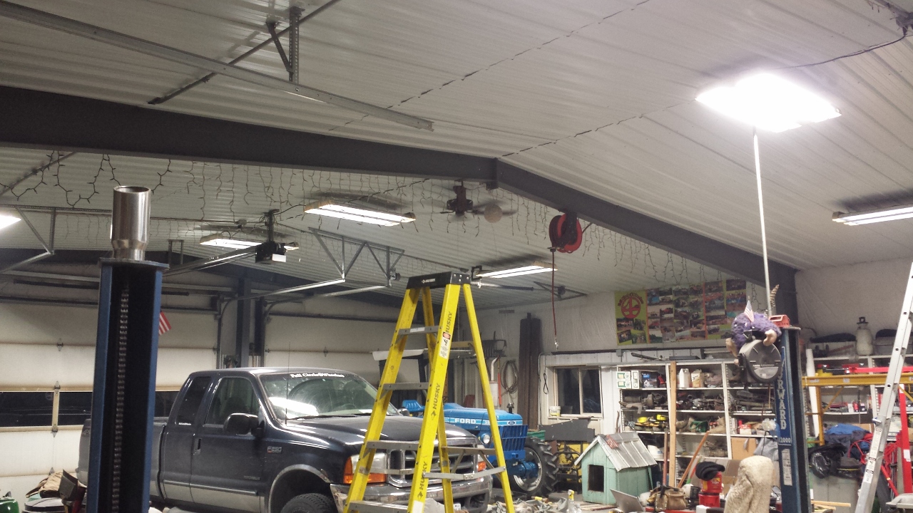

Also, think about metal buildings built with I-beams. LOTS of them use a tapered I-beam, where the center of the span is a lot deeper section than than where it connects to the walls or posts. Same for the vertical columns. Might be small where it attaches to the floor and much larger at the top.

Yep, my shop is all metal. I-beam frame. Center beam is clearspan 42'. Vertical wall beam is smaller at the floor. But roof beam is larger where it fastens to vertical beam and smaller out in the center of the building where they bolt together.
Thats just the opposite of how most of them I see are. But given the pitch of the roof, about the only way that center connection at the ridge can fail is if it pushes the wall out. Most of the ones that I have seen are flat or near flat roofs. And the beams always seem to have a deeper section in the middle of the span, where it is needed for the deflection.
But steel aside, look at any type of wood truss. The "deepest" section is the middle. The end supports where it sits atop the wall, not so much. Only have to be strong enough to overcome the shear.

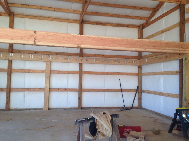

Lots of good info in the replies from everyone. Here is a glulam i just installed in my building.
Nice job on all the joist hangers. I've found that it's easier for me to install the joists first, then come back and install the hangers after they are in place.
/ I-beam size 30' span #57
Are those hangers the top mount kind or face mount only.
On the top mount kind, I like hanging all of them first with ONE nail in the top. That way you dont squeeze them too tight. Drop the joist in and add the rest of the nails.
For the flush mount kind, I agree with eddie, easier to go back through and add later
