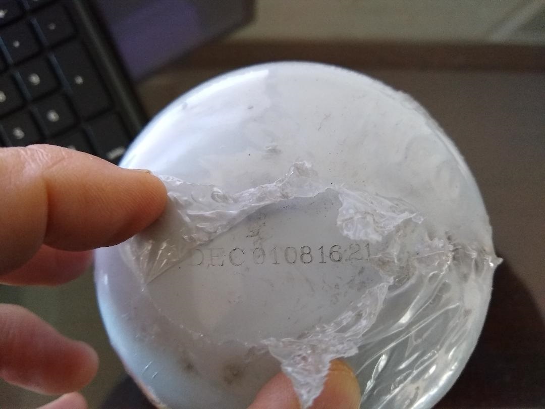

Ordered a filter and got this one. Asked for a new one or refund.

Your money If it was me , Send me a new one or lose a customer......
Yeah, I agree. They replied saying they will look for one with good date code. They have 12 in stock. Otherwise they will refund.

That is likely NOT an expiration date but a Manufacturing date. I'd use a new sealed filter were it fifty years old, without concern.
I dont recall anyone saying it is an expiration date.
It is a manufacturing date with a shelf life of 5 years.
