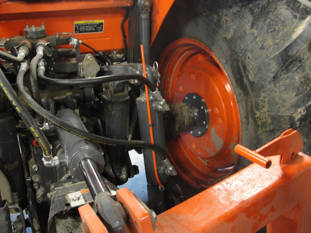

I rigged up this sliding rod, similar to a bucket level indicator. I never pay any attention to it. I instead pay attention to the finished product behind the BB or rear blade, or whatever else I'm using. And I still have Dual Action on the cylinder.
Looks like you just need to add port to the top end of your 3PH cylinders. Then you WOULD have down pressure.:)
I didn't realize that any of the Kubota's had external 3PH cylinders.
/ HYDRAULICS--WHAT IS IT? #25
I rarely have a need for down pressure on the 3pt. But yeah, I guess you could rig up something like that.
A lot of the Utility models and up have external cylinders to boost the lift capabilities. That picture is of my M9540.
