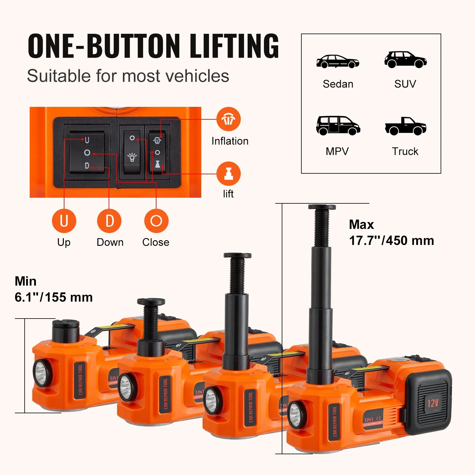

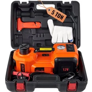

/ Hydraulic #7
Is this for a specific purpose, a school project perhaps? It would not be an invention however. You can buy them on Vevor for $75.
yes please this is for a school project and the main aim is to generate data from the setup and make some comparisons
