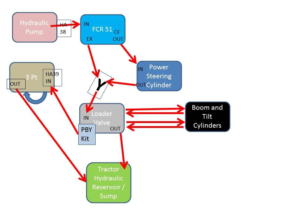

Hi Gang....An update....much success and a costly mistake....
But first...To answer Wooly's question: Yes I can raise the loader and raise the bucket at the same time. I got the LV22 Valve from Brand that also includes float. I did not get regeneration as I just didn't see the need. There are lots of configurations of the LV22 Valve I don't want to confuse anyone because each mounting location might be different therefore change the part number. I will be happy to provide pictures of my set up if anyone is interested.
On to the work I have done on this...
So, the issue I wanted to fix is the loader not being response at low RPM's and having a either or situation. Either my loader function quickly and strongly and I lost Power steering, or I had great power steering with no loader control. I could find a happy medium but that meant good power steering and loader control only at high rpms. This may not seem like an issue, but when you are going into a pile and reduce your rpms/speed, I would lose loader functioning. If I get the RPMs up so I would have loader functioning, I would come into the pile way to fast. It was a mess and just begging for me to break something.
I have a reputable local hydraulics shop somewhat nearby and I took my drawings down to them. They agreed that taking the out flow of the power steering (instructions say to go to the tank) and combining it with the EX port of the Flow Control Valve would not hurt anything. Instead of a Y like Jtullis did they suggested I use a T.
So that’s what I did and it gave me the following:
1. Loader response was much quicker at lower RPM's - Just like it was before I added Power Steering
2. Power steering response was stronger and easier to steer with.
3. The wheels turned to the left constantly.
4. Loader and power steering worked together and didn't cut each other off
5. 3pt does not work when using the loader - That's normal in my opinion because my 3pt is plumbed using Power Beyond so the loader valve has to be in the open center (not being used) position for oil to flow to the 3pt.
When driving the tractor it would noticeably pull to the left and wasn't difficult to hold it steady, but if you let go of the wheel it would turn to the left pretty quickly. I adjusted the FCR and regardless of the adjustment it made no change. This makes perfect sense because the FCR is just splitting the flow and I am combining it back, so the sum is the same. Honestly, at this point I was pretty happy but I took a trip back to the hydraulics place and they felt I was having back pressure through the system and we agreed adding an inexpensive ($13) 5psi one way check valve on the Out port of the Power steering might fix the problem.
After Installing the check valve, It was better but not perfect. It still pulled slightly to left but I noticed another issue. When I bottomed out the curl cylinder, my tires pulled hard left. I assumed and another trip back to the hydraulic shop, these guys agreed that I was getting back pressure back from the loader valve into the power steering cylinder. So I suggested I install another check valve on the Ex port to the T. The logic here was that now all of the oil would flow to the loader valve and none would go back down to the power steering cylinder. And so...here is where it gets interesting and costly. After I installed the second check valve, there was no change whatsoever. There was still the slight pull on the tires to the left. Which is interesting because now the only pressure its getting is from the pump, but there is no adjustment on the power steering cylinder so it just wants to extend the rod. So, I decided to change the adjustment on the FCR, and WHAMMO! I blew apart my brand new 9cc pump's case. I was spitting nails. As a reminder, The good folks at Hoye had let me purchase a new 9cc pump when this all started. The thought here was that maybe my 7cc stock 30+ year old pump was tired and not pushing enough fluid. Hoye allowed me to buy the pump and return if I didn't make any difference. I decided to keep it anyway, but it didn't make much of a difference. More on that in a minute.
So, I removed the cracked pump and the whole time I was asking why the key didn't shear and save my butt and when I got into the pump I saw that the key had broken but not enough to allow spinning the shaft. Additionally there is a nut that goes over the pump shaft and shaft key and is retained by a smaller nut. The larger nut fits into and drives the pump gear. That nut cracked on mine - I can't figure out the part number yet, but will need to order one. So, I grabbed my original pump, reinstalled the cracked nut and made some gaskets and reinstalled and waited 24 hours to let seal up. I had no choice but to reuse the cracked nut as I needed to get the tractor removed from where it was parked when the pump blew. So this morning, with some hesitation, I started her up....no leaks. OH - VERY IMPORTANT. I removed the check valve from the hose running from the FCR’s EX port to the T at the loader. This way, I have a path in case I ever over pressure the system again by accident.
So, At the moment I have noticed:
1. The 7cc original pump is so much quieter than the 9cc pump. The 9cc pump just squealed and whined. The original can't be heard.
2. I cannot notice any difference between the two pumps - which is odd because I should. I wonder if the whining and squealing were indicators of a bad pump? No way to know now.
3. This is what I have; Loader responsive at all rpms. Power steering that is very easy to turn. A slight pull to the left constantly. IT doesn’t fight me to turn left, but you can feel it. I have a suicide knob on mine so it’s a snap to control the steering. Hydraulics folks told me that I am not wearing out anything or damaging anything by it doing this. So I am pretty happy. I will say I am hesitant to make any more changes because of the cost to me of the pump. I would like to get a new 9cc pump at some point but not sure when and will report out if it changes anything - it should but didn’t so far with me.
Lastly, I have been working with Jtullis on this. I hope he chimes in because I believe he is also going to make these changes and report out with his 2210 and a Koyker loader.

Here is the diagram of how the hydraulics are hooked up with the new power steering and loader valve.
This was done according to the Hoye instructions except for the fact that instead of my loader out port going to 3pt (as it was originally) it now goes to the sump and the loader valve power beyond fed the 3pt. In the Hoye/Fredrick's Power Steering system is a FCR-51. The FCR is a Flow Control block allowing adjustment of flow to the power steering cylinder and the loader valve.
It is clear that since the Power steering is first in the flow that it takes priority and works well, however the adjustment in the FCR is very sensitive and you need to strike a balance between power steering and loader functionality. An adjustment a little one way or the other stops one of the systems from working correctly. I adjusted the FCR to a point where the power steering just barely works as it should. This setting is a 2.5 on a scale of 1-10. I believe this means, 25% of the flow goes to the PS and the 75% remaining goes to the Loader Valve in this set up. For example, adjusting the FCR to a setting of 3 and higher and you lose all loader functionality regardless of rpm and anything below 2.5 you lose all PS and the loader works at all rpms. At the 2.5 setting and at full rpm, I have both power steering and loader valve functionality. However, the loader response is slower and I lost all loader functionality at low idle where I had it before. I then upgraded to a 9cc pump (per the recommendation of Hoye) over the stock 7cc pump. With the new larger cc pump the loader hydraulics were quicker in response but still nonexistent at low idle. Another serious issue experienced was the loader dropped very quickly and violently when a heavy load was in the bucket. It makes finessing a load downward a delicate operation and risks damaging what is in or attached to the bucket and the platform you are dropping it onto. Before Power Steering and the new loader valve this was not an issue.
Now on to my partner in crime; Jtullis13, who has a Yanmar 2210D with a Koyker 120 loader and I have collaborated via PM and on the phone. This all started because he was installing the Hoye PS kit and I offered to lend my experience from installing the PS kit. Based on my shared experiences and what he experienced with his install, he began making a series of configuration changes to the hydraulic routing with varying results. After multiple changes, what he ended up doing is interesting and created a solution that is about 95% perfect. As he made port and flow adjustments certain results were experienced, like the 3pt not working when the loader was being used and the Power steering stopping when raising the boom arms and so on.
What he ended up with is this (his flow diagram is below). Instead of having the flow go to the FCR first per the Hoye Instruction, it flows to the loader Valve IN port. The loader valve power beyond AND the out port connect to a 1/2" Y valve (Purchased off EBay and rated for 10K psi) and the out port of the Y valve feeds the IN Port on the FCR. Let's discuss this logic here. We believe the flow to the loader valve (when the Joy Stick is in neutral (and not being use to tilt or raise/lower) flows through to the Power Beyond. When the Loader valve is being used the excess flow from the cylinders travels out the valve OUT port. By connecting these two independent streams they flow into one stream and provide fluid and pressure to the FCR at almost 100% flow. He set his FCR flow control valve at 7.5. The EX (Excess) port on the Flow Control valve returns to the Tank. The CF port feeds the IN port of the Power Steering. So 75% of flow goes to Power Steering and the 25% excess flow to the tank. Power Steering Out Port feeds the 3 PT. 3PT flows to the Tank.
Now, back to my YM2020D with Power beyond feeding the 3pt, we believe there is no back pressure (like there was when it flowed out through the Loader Valve OUT port to the 3PT) and is why I see the violent dropping of the loader when carry a heavy load. Jtullis13 also experienced this when using Power Beyond supplying the 3PT, but he has eliminated that because his system has some back pressure (we are guessing here) and therefore has much better loader control when lowering heavy loads.
Jtullis13's results are these: He has full use of the loader at all times and rpms. Lowering the boom or bucket with a load is controlled. Power steering works perfectly except he loses partial power steering when lifting the loader (makes sense to me because flow needed to fill cylinders) AND using power Steering. His 3 Pt works and has lifted upwards of 1000 lbs. with it. No whining at the pump. He plans on adding a gauge to his system which I am sure he will share his results if there is anything odd going on. I have one in my system and that's how I found out I was having spikes upwards of 5000 psi when the loader and 3pt were used at the same time. An adjustment of the 3pt fixed that.
So, Jtullis13's results are terrific and I am seriously considering making these changes but a bit hesitant because of my limited experience with hydraulics and not wanting to blow a pump out or worse. We both realize that not having Power Steering first in the hydraulic flow is a No No when it comes to cars, but we are not concerned about losing power steering in the case of a hydraulic power loss. At that moment we have more pressing issues to consider. Plus the steering will still work manually. The question is - is there something glaring that comes to mind that may cause issues with a set up like this?
