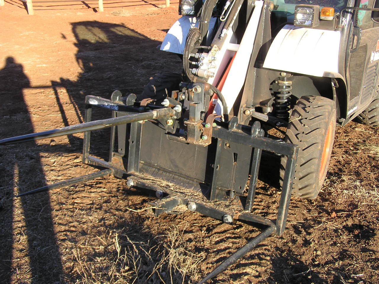

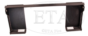

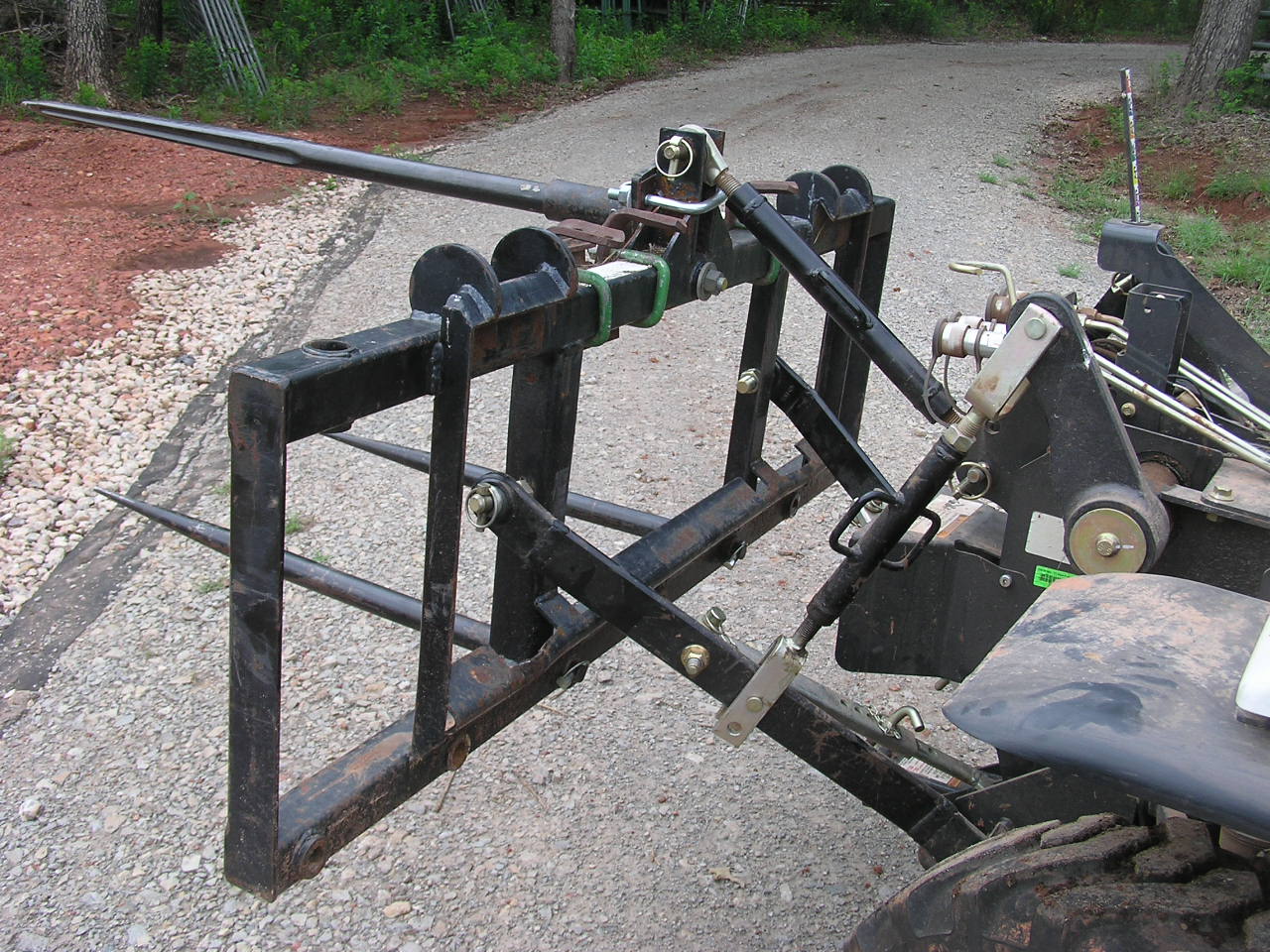

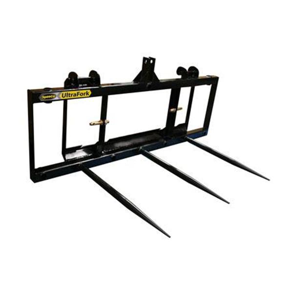

You don't need to swap the winch from one side of the plate to the other. There are many threads about mounting pallet forks on the loader or the 3 point. You can make a frame to do that.
Here is how my Speeco bale fork does it.
If you use a solid QA plate, you can cut slots in it to let the 3pt lift arms come in from the back.
Or use this from EA and add the framework to it.

Xfaxman, I didnt think I would be able to do that because I use a quick hitch on the 3 pt arms. After a closer look, I think I will be able to fab the QA plate so the winch can remain on the front side of the plate at all times. Thanks for your idea and photos.
