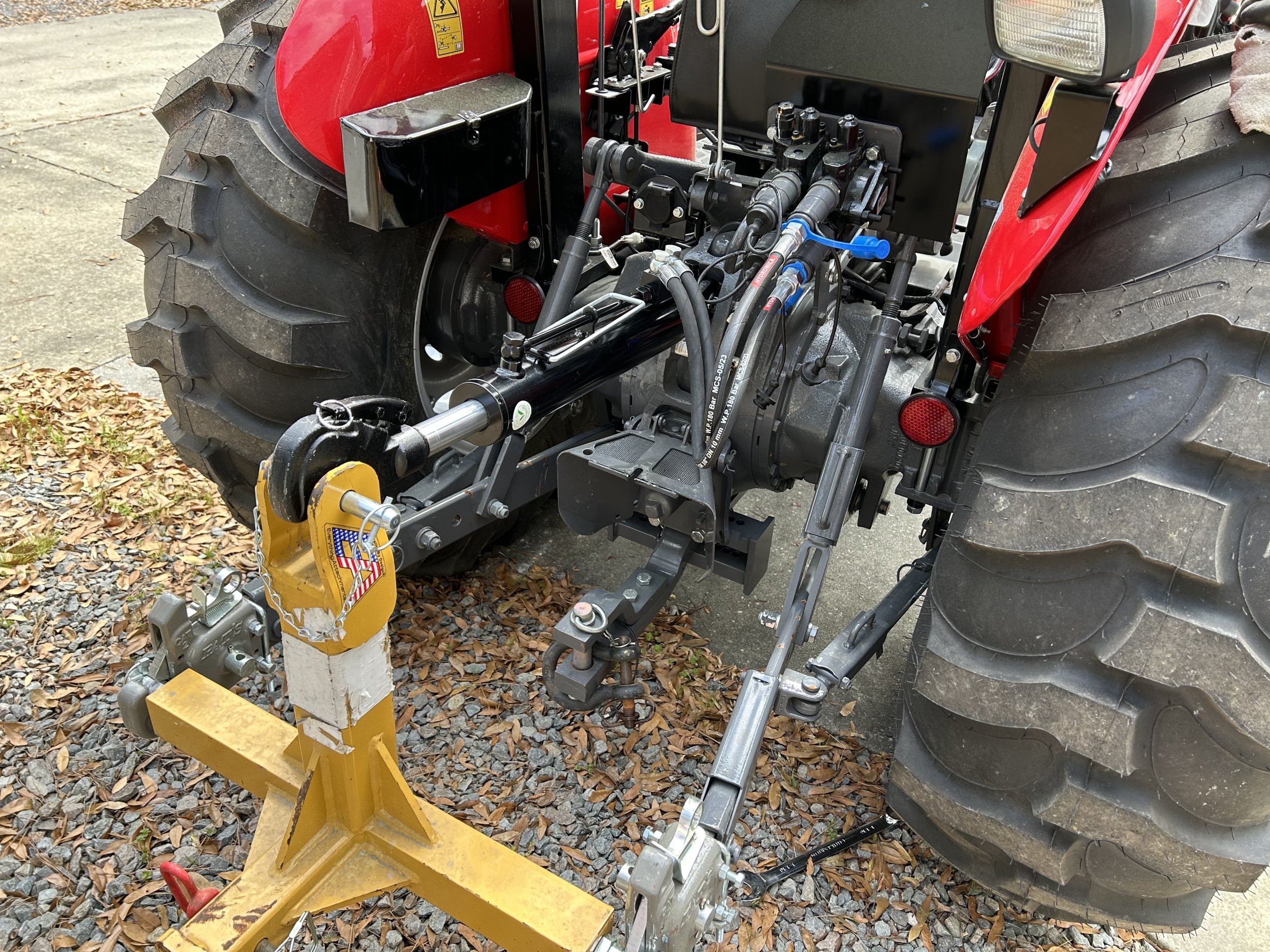

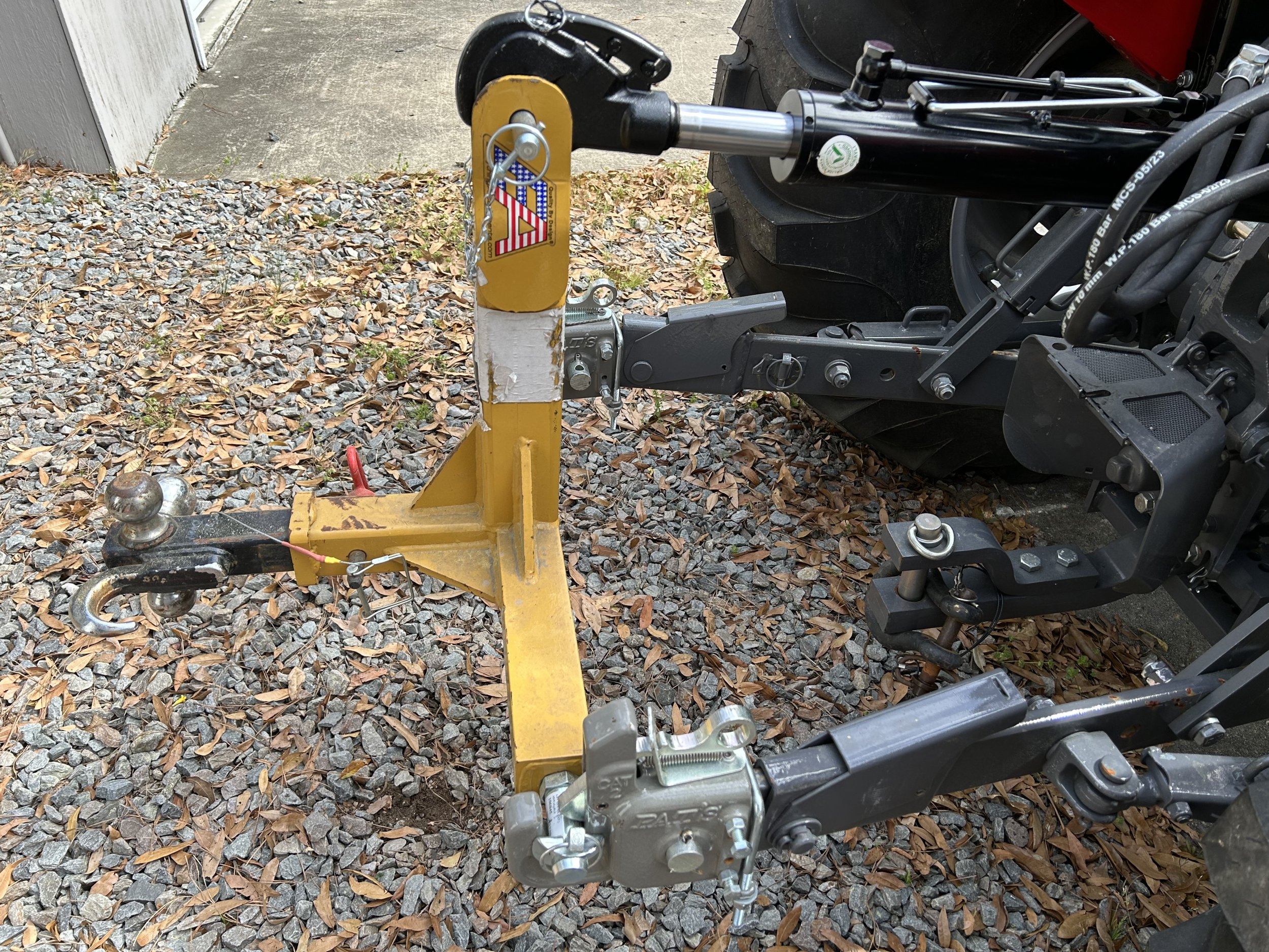

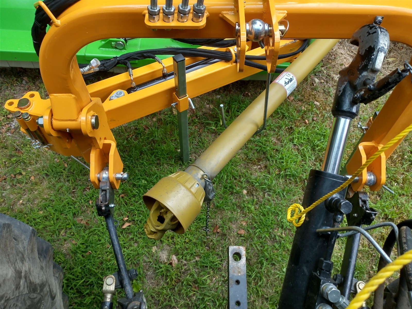

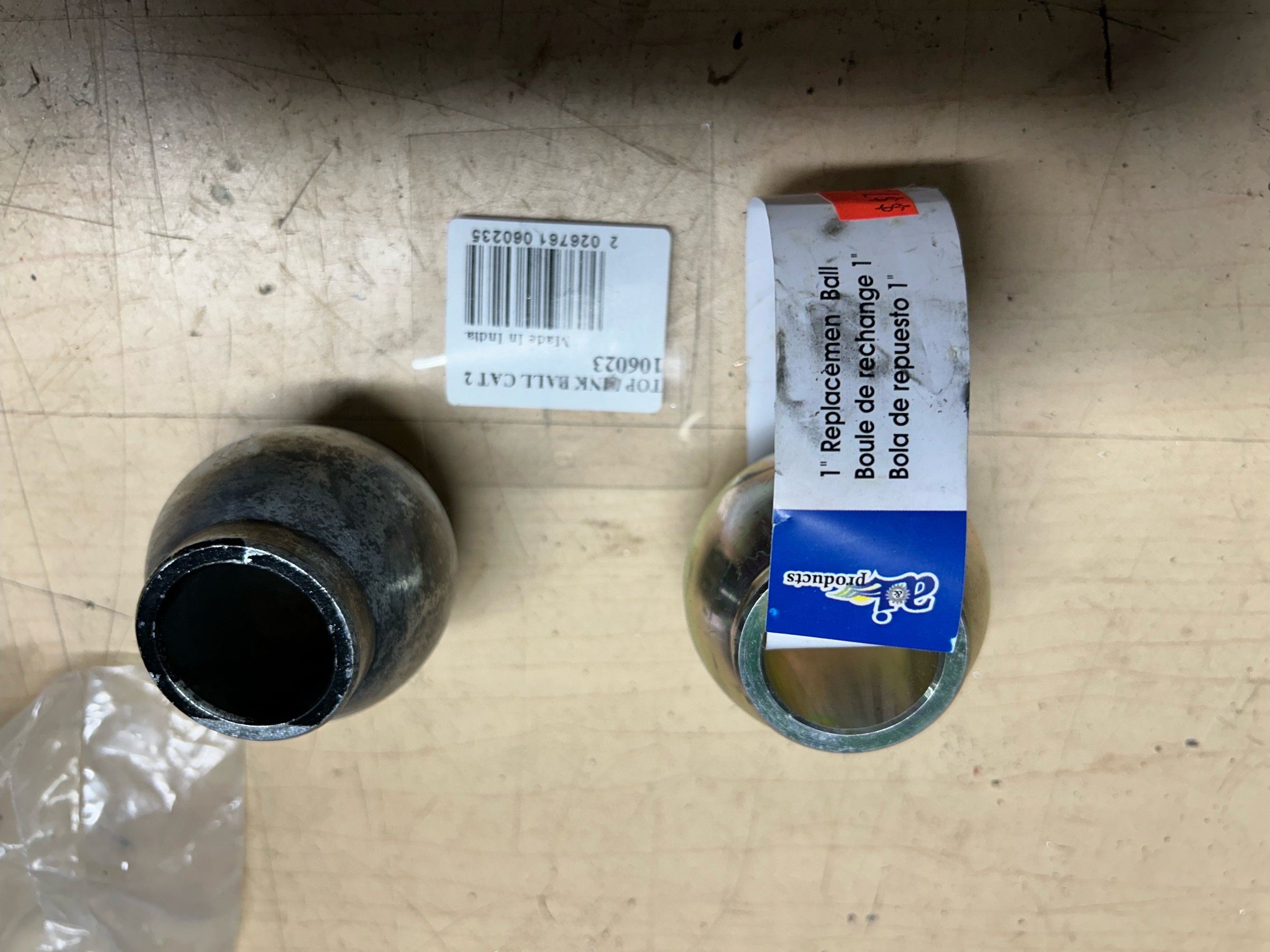

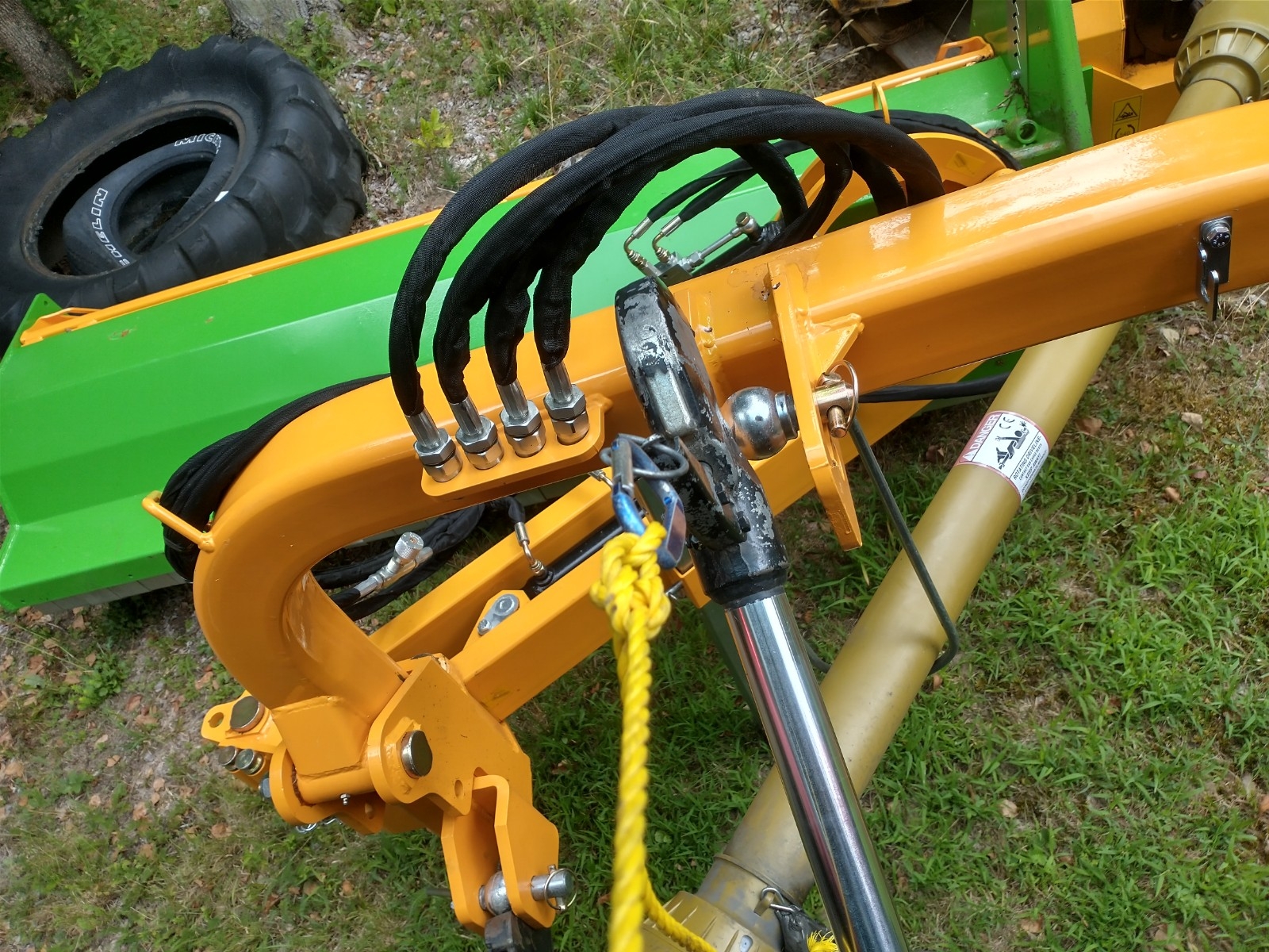

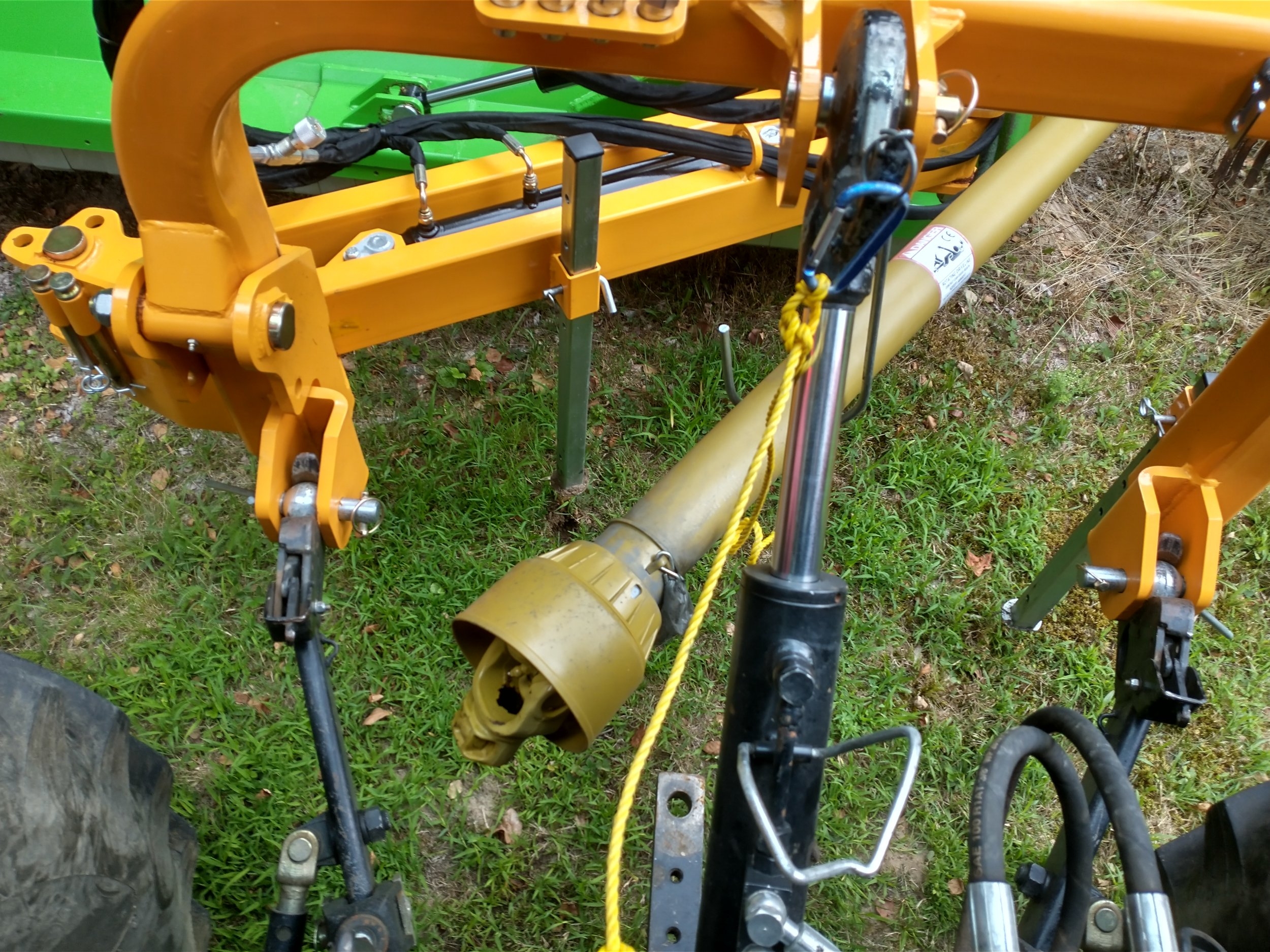

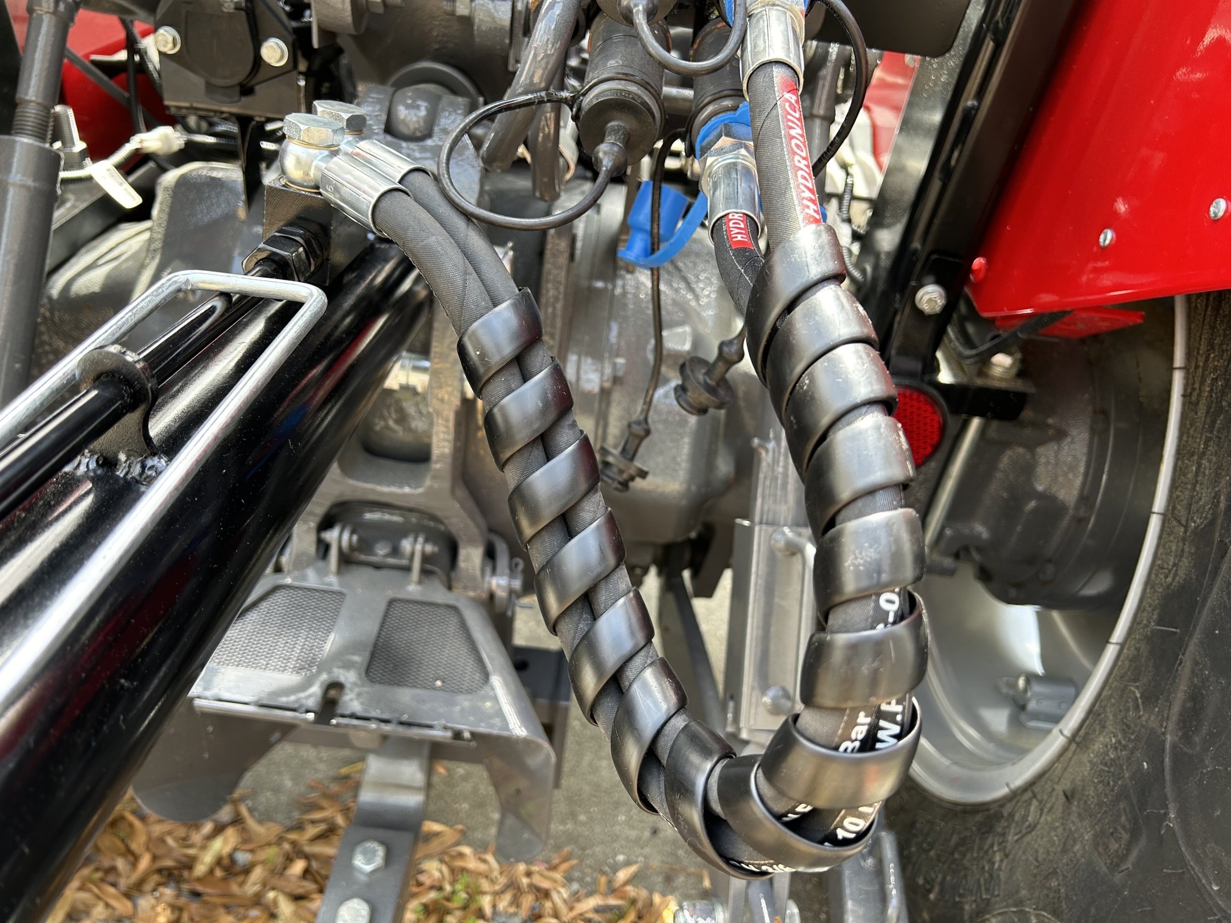

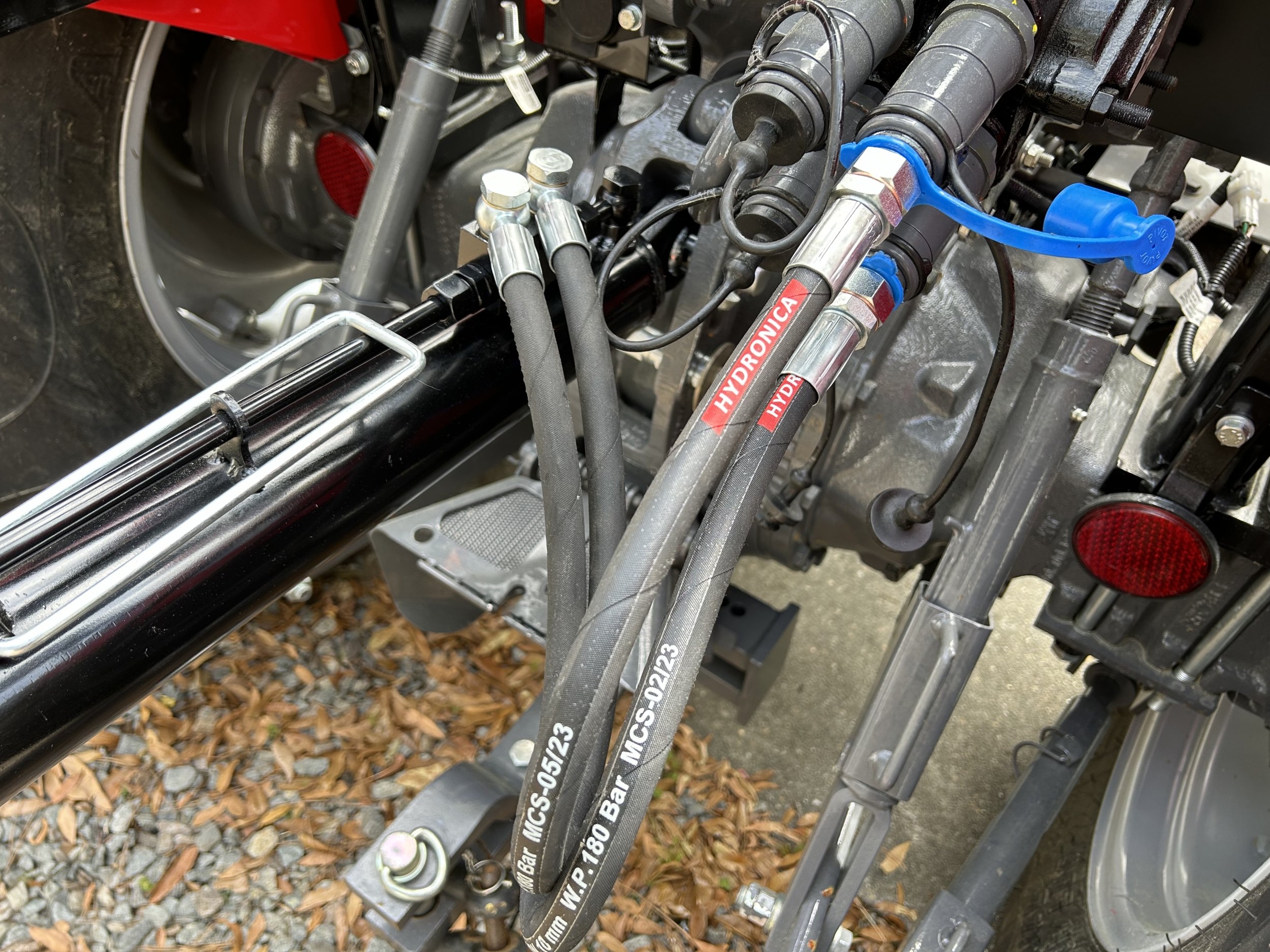

This was certainly worth the research effort… Besides the hydraulics, I wanted something that would compensate for the Pat’s quick hitch extension, and add a quick-attach to the top. Also, found I can use the inexpensive, locally available, top-link balls by doing a little grinding…

They do work nicely, I have a rope attached to mine so I can pull and disconnect while adjusting the top link to release it, then I hold it with the rope and adjust to drop it in place while connecting.
Hmmm......it's great that this works for you. All my 3-point implements are HEAVY. Meaning they can not be "josstled" around to make the top hitch attachment. No matter what I would have there for the top link - mechanical or hydraulic - it DOES require exact alignment.
OR.... am I missing something.
I can extend or retract my top link till it drops right on the ball that is left on the implement from when last used. With the Euro style hooks and the top link with a hook it works much nicer for me than a quick hitch even thinks to be.

I have euro hooks on the 2 lower points they were very expensive but also very helpful. The top link is hydraulic so it’s fairly easy to hook and unhook. I usually have to get on and off the tractor a couple times in order to get hooked up.
Quick hitch doesn’t work worth crap for my PTO equipment.
Pats quick hitch seems to work good for many folks, I never had any interest in trying one myself.

I DO use a rope on my hydraulic top link. With the rope I can guide the top link right into proper alignment. I still must get off the tractor to push the pin thru and complete lock up.
The reason for the rope. When I'm behind the tractor - holding the top link up - I can not reach the hydraulic top link activation lever. It's simply too far away.
