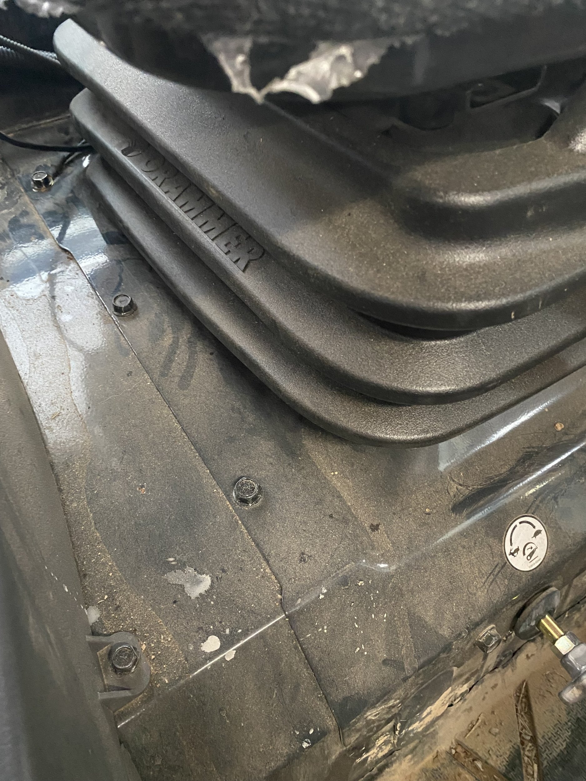

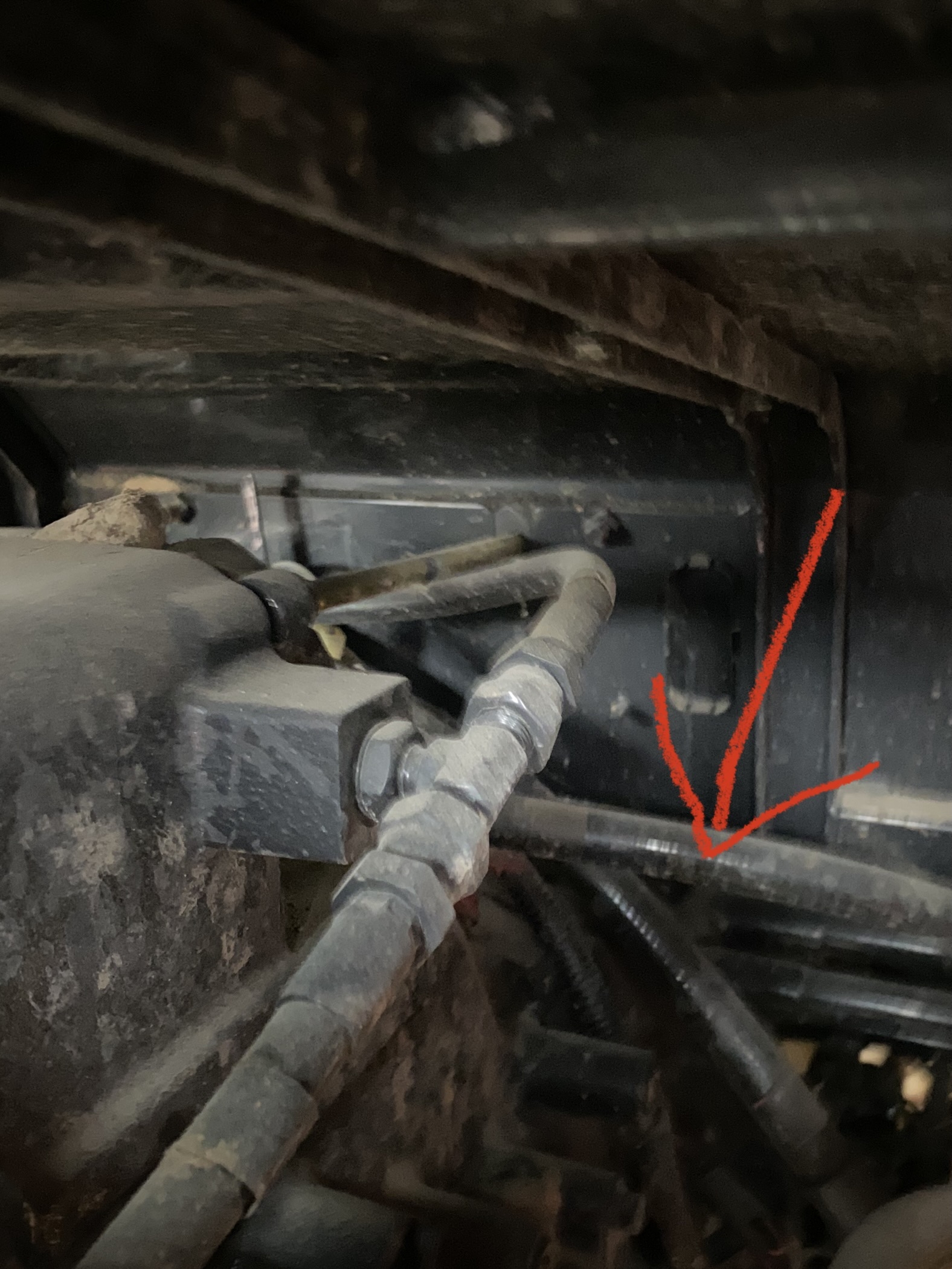

There is a tank port on top of the transmission housing. You can tee into it. It is BSPP thread so you'll have to order the fittings if you don't have a dedicated hydraulic shop nearby. The return to tank line from your loader valve will be running to it. I'll try and take a picture of it later this evening when I get home and post it back here.
/ Hydraulic return port location #9
Circled in red. This is being photographed from the right side imagine it directly below the seat.
It’s not under pressure so you could cut this hose and tee it with a brass or stainless hose barb tee and run a short hose to the back to connect to your pounder.

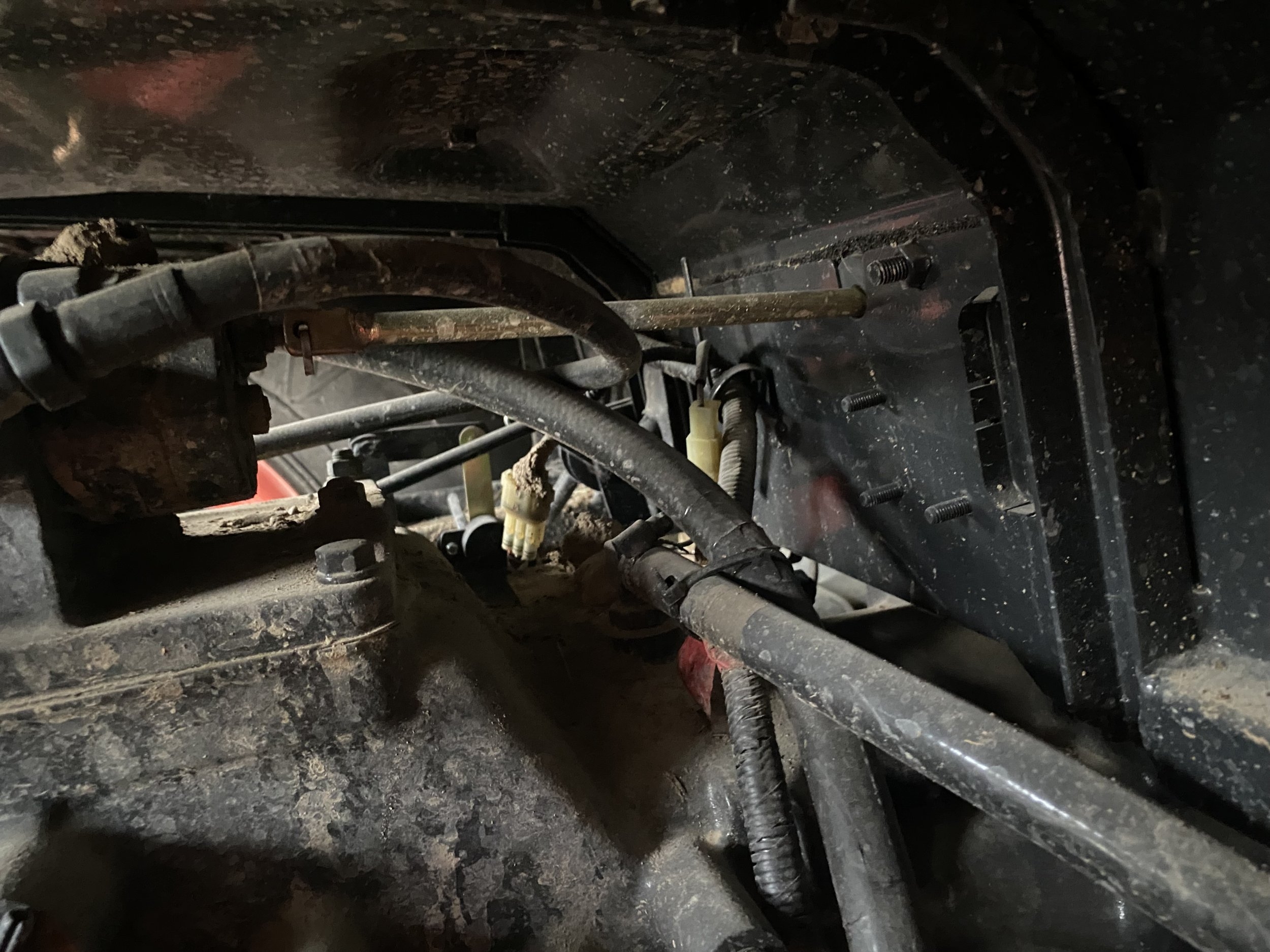

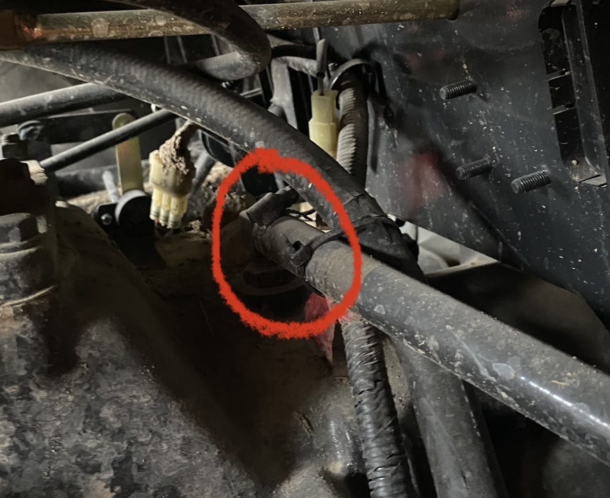

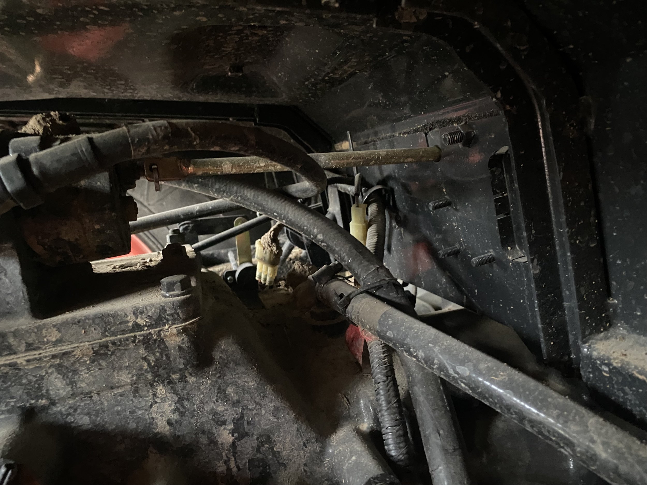

/ Hydraulic return port location #10
Looking at it from rear it is the line in red. Just remove your seat pan and you will be looking right at it.
