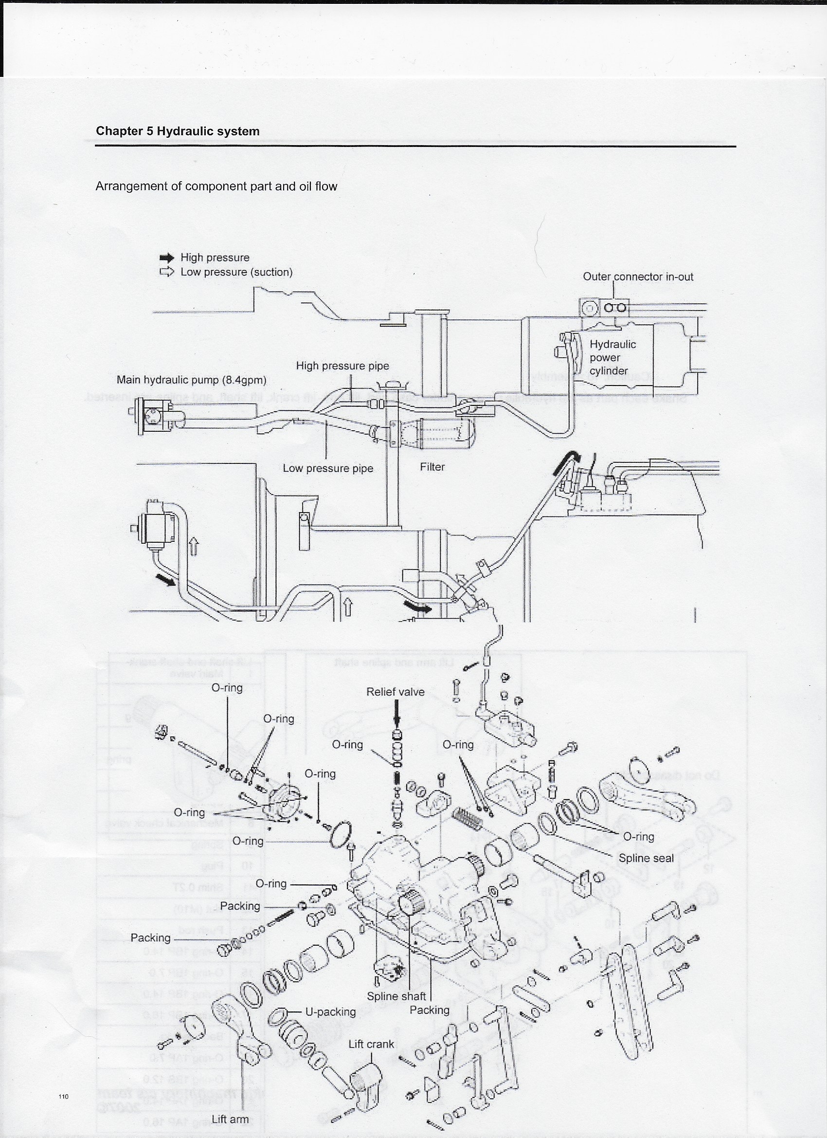

I don't want to waste any ones time but this is the "nozzle" that has a connection to the case of the lift arm and another connection to the hoses I replaced. It is 7 feet long and goes to a connector on the joy stick.
I got the hydraulic system from Branson schematic and it clearly shows that the high pressure line ends up at the Lift arm case and back to the joy stick.

/ Hydraulic Problem After Hoses Replaced #31
Are you getting pressure past that quick disconnect? Reason for asking is that they have been known to fail.
If you have schematic can you post it? That might help us understand your system and also aide in suggestions on where to look for the problem item.
#32
Here is the requested schematic.
/ Hydraulic Problem After Hoses Replaced #33
Actually that's pretty much worthless in this situation. It's merely the basic tractor layout, and shows the pump output going straight to the three point. It shows absolutely nothing in regard to all the valves, changes, and additions that you have. The one component labeled "outer connector in - out" may be a supply port for externals, and COULD be the source for pressure flow to the loader valve. That's about all I can make out from this. Maybe someone else will have better luck.

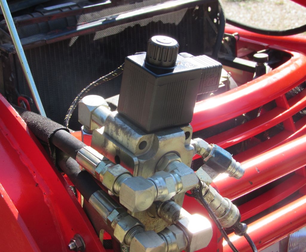

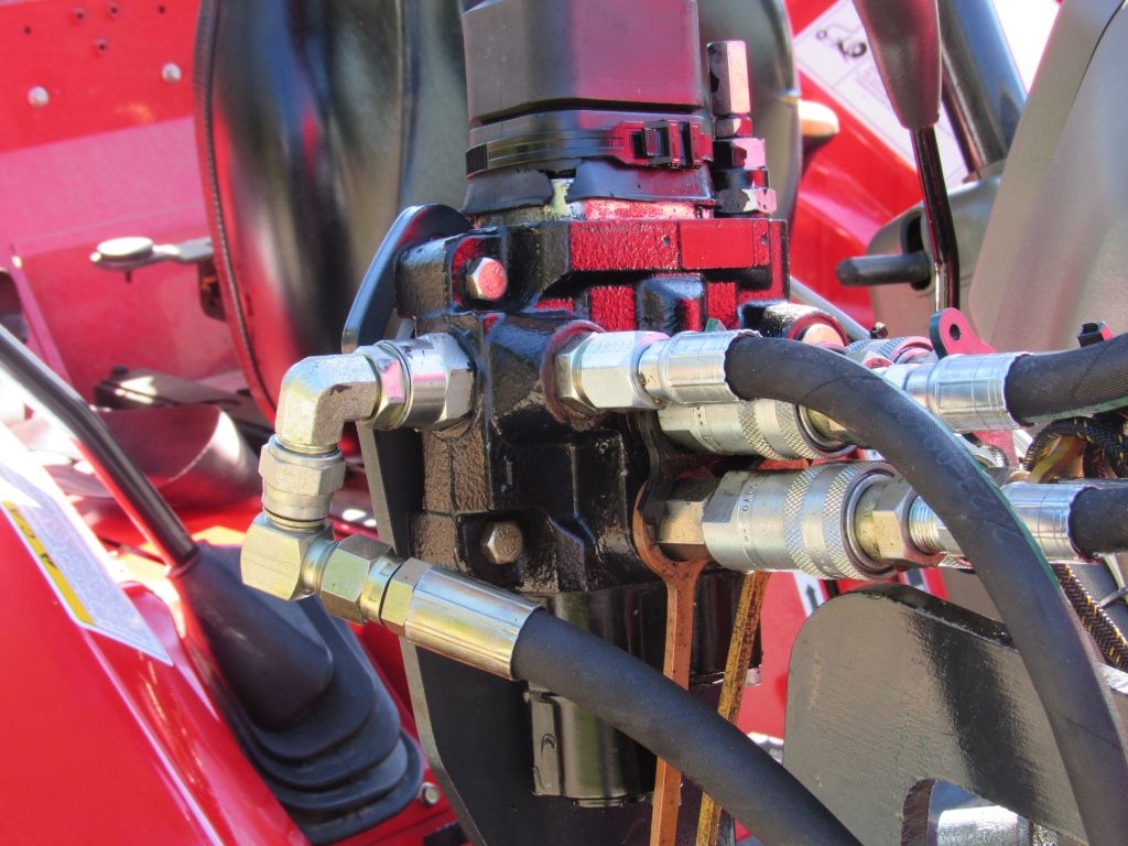

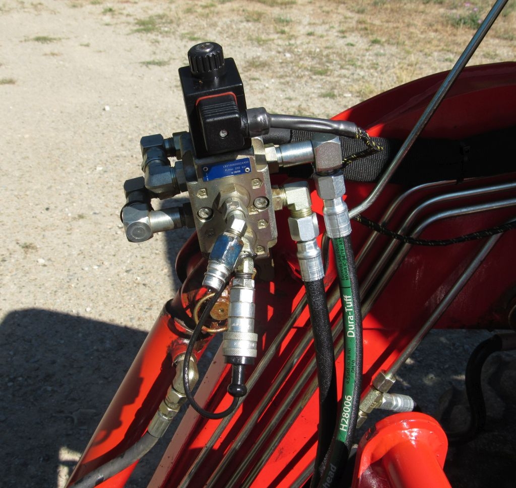

I have a 2007 Branson 3510i tractor with front and rear remotes on a BL10S loader. Had it for 14 years with no loader problems, recently found a hose with a leak and since I'm not near any place for service I decided to go ahead and replace 5 hoses that showed wear and potential for problems.
Got replacements made, brought them home and installed them exactly as others came out. Now, attempting to raise the boom, one of the output hoses from the remote spews out hydraulic fluid below the coupling and the rockshaft won't raise.
Nothing works, what to do?
A few photos might help.View attachment 1045788View attachment 1045789View attachment 1045790
When there is more than one operation, like front-end loader and rear hydraulic outlets one or the other will have power beyond. track the oil flow from the pump and the flow will either go to the rear controls or too the loader control. If it goes to the loader control you will see pressure in, then power- beyond, and back to the "tank". You may have power-beyond and tank hoses back to front. Do the rear hydraulic outlets work? this will tell you if the flow is correct. Hope that makes sense and helps.
