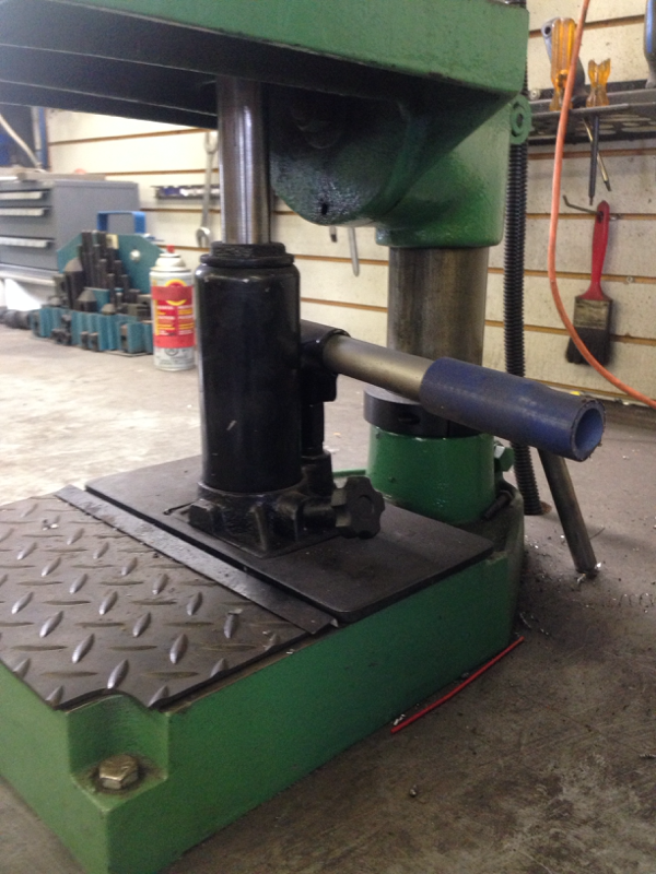

Didn't build it, bought it at an auction about 28 years ago for $75. 30 ton jack in a 40 ton frame.
I like the innovation of welding a bracket at each end of the table to keep the table from
falling off the pins when changing height. Yeah, it's happened to me. I should add those.....

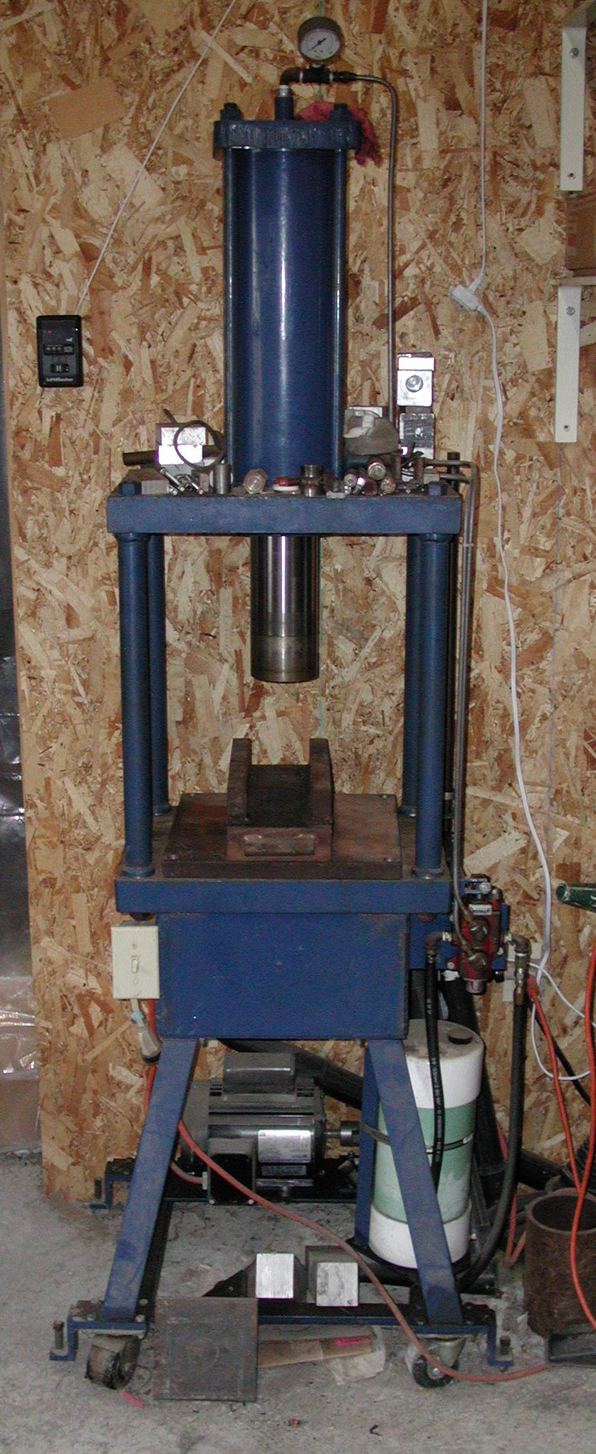

/ Hydraulic Press #25
For those of you thinking of building your own, this is how I lift my bed with the double acting cylinder.
Terry

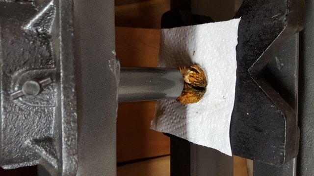

Very happy with my 20-ton HF shop press that I bought with a coupon last year for $150. :thumbsup: Still looking for neat projects to use it for, but I know they'll come along. In the meantime it works great cracking walnuts. Thanks to another TBN member for that suggestion. :laughing:

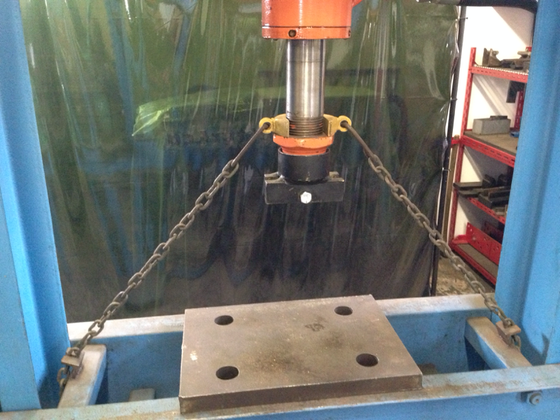

/ Hydraulic Press #30
Looks like the ones at Princess auto have jumped a bit in price.
Powerfist 2 Ton Hydraulic Shop Press | Princess Auto
On sale their a couple hundred less.
That press is a much nicer one that the bottle jack style that HF sells. I have one that's identical to it from Greg Smith except mine has both manual and air power. Several other brands are sold in the US (like Red Torin) and they all sell for around $400 the last time I looked. That has the movable hydraulic ram. You can slide it from one side to the other to help making lining up the ram on your project. That comes in handy if you are working on something that's not centered. Another nice feature is just the ram moves, not the whole jack and guide plate. This gives you more room to work. Plus the end of the ram is removable. So if you are handy you can make (like I did) inserts that can be swapped out when you need to press something small in diameter. I had a 1/2" extension for a ratchet/ socket that the end broke. With just a little welding I turned it into a 5/8" diameter press pin. It also has a large dial gauge to tell you how much pressure you are exerting. If money is tight I don't think I would spend the extra money but OTOH having more options is always nice.

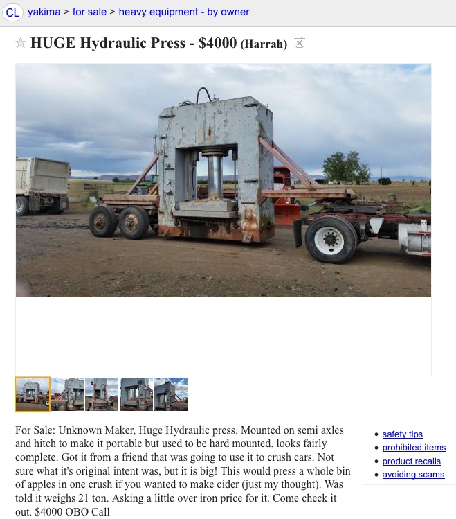

/ Hydraulic Press #32
I have a HF 12 ton A-frame-top press that meets my needs, but I thought I would see what is on CL this afternoon.
This is the only interesting one, but I don't think I need it. Maybe someone here does. :)
HUGE Hydraulic Press
Here is a screen shot, in case it is snapped up quickly.
Bruce
