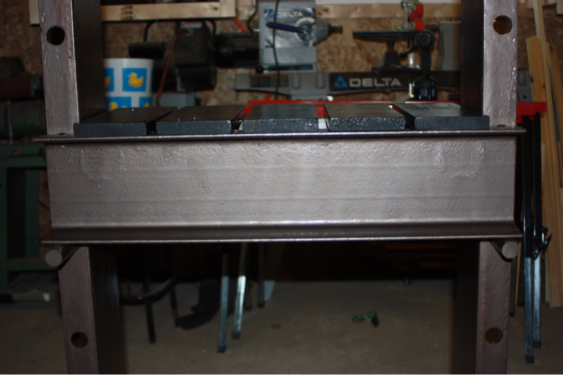

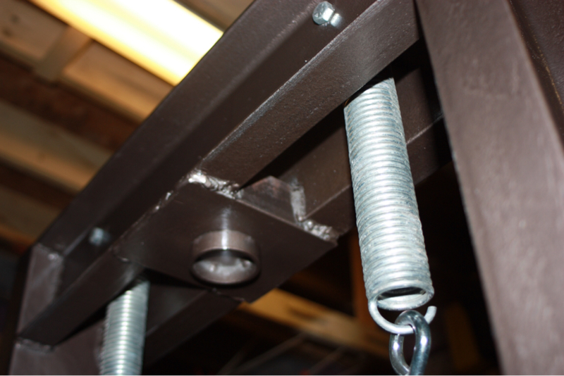

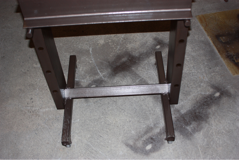

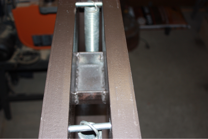

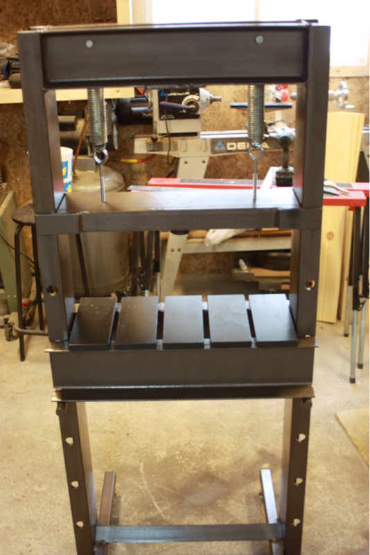

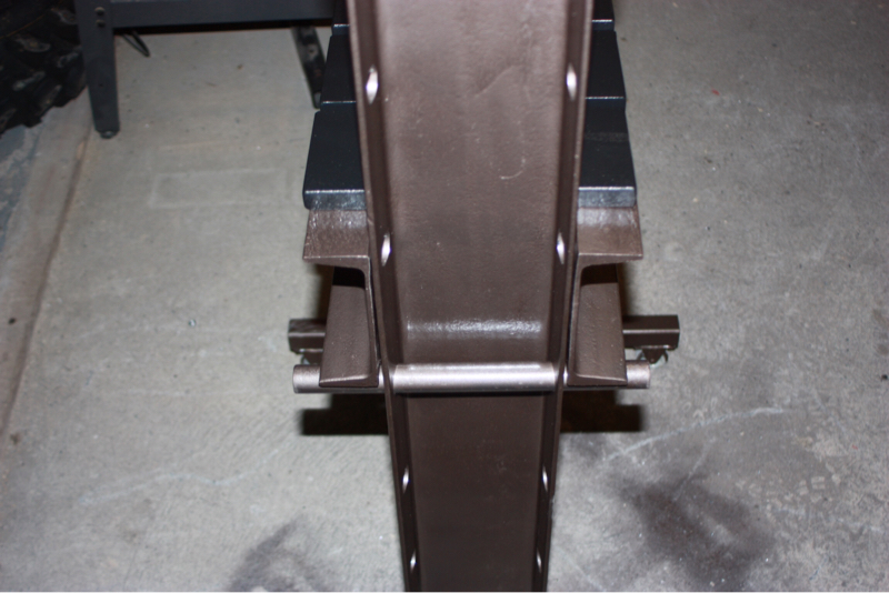

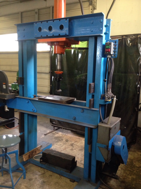

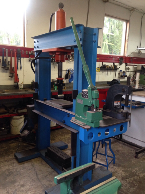

Here are a few photos of the press I built a few years ago.

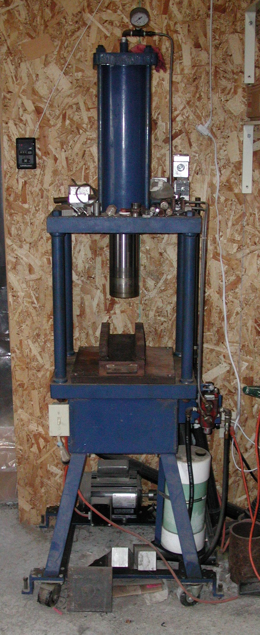

Built this one 30 years ago.
Terry

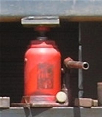

I made this one about 25 years ago. I wanted a welded tubular beam to prevent flexing and storing energy when pressing tough projects. I have a 20 ton jack in it till it blew up, now have a 12 ton. Beams work awesome at preventing energy storage. Also made a few attachments for it over the yeats including this smaller bar bender. As you can see it's been abused pretty bad over the years. Probably time to make a new one.
/ Hydraulic Press #9
I wanted a welded tubular beam to prevent flexing and storing energy when pressing tough projects......Beams work awesome at preventing energy storage.
This is an excellent point about structures. Just because something doesn't permanently bend at full capacity doesn't mean it's a good design.

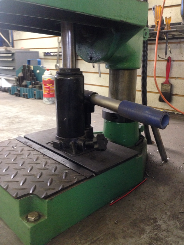

Didn't build it, bought it at an auction about 28 years ago for $75. 30 ton jack in a 40 ton frame.
I fastened the castors to two 2x12's and bolted them to the frame.
Put a knob on the valve :thumbsup:
/ Hydraulic Press #13
Xfaxman, I think I copied your knob idea to use on the jack on my drill press last year. Thanks!
Terry
/ Hydraulic Press #14
Terry
You are welcome, yep I have posted it before.

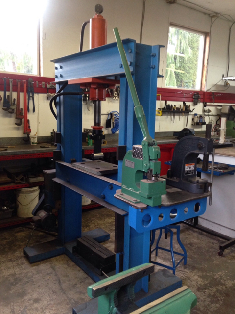

Here's my 35 ton. I made it so I can bolt in small die sets and use it as a punch press.
