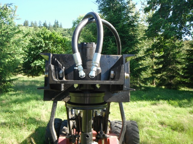

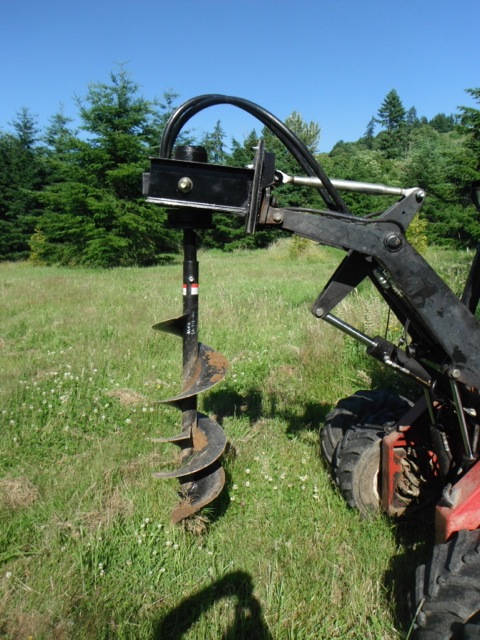

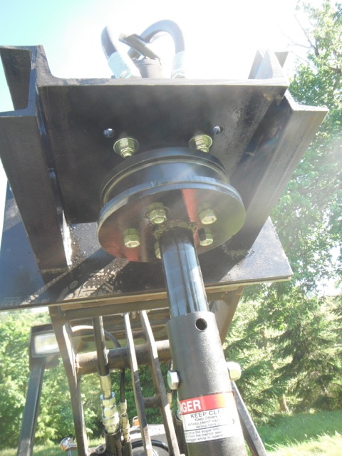

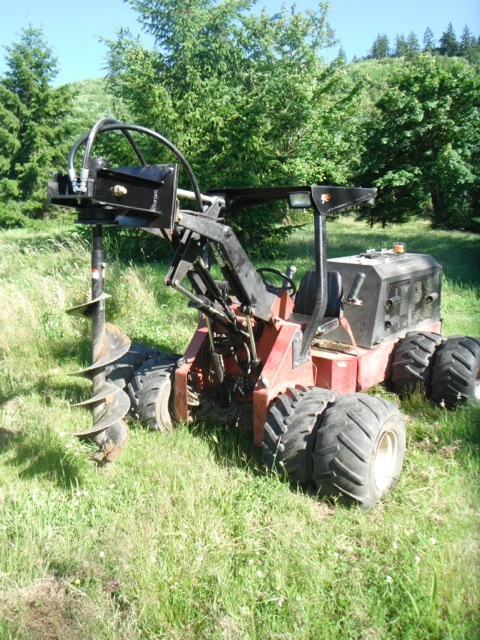

Here ya go.
All in with hoses, connectors, it was $1000. I had all the steel cut and drilled, did my own welding. Got a good bit that set me back more than I expected. And the hoses and connectors were brutal. The bit is 12" but I am sure I could spin a 30 in my dirt no problem. Just don't have the 1200 for that bit.
It eats up roots, I don't really have rocks. About the only thing that has stopped it was when I drilled into my double walled culvert by mistake. That was a mess....
For reference, I am 18GPM at 3100 PSI and a 65HP engine backing it up

Are you referring to my build Rio?
I kept the wheel motor hub, basically I plan to put a log splitter on it later...
I then had a round peice of steel cut, appropriate holes drilled, and a pole welded to it. Bolted it on. Now I can take any 2" round auger bits.
