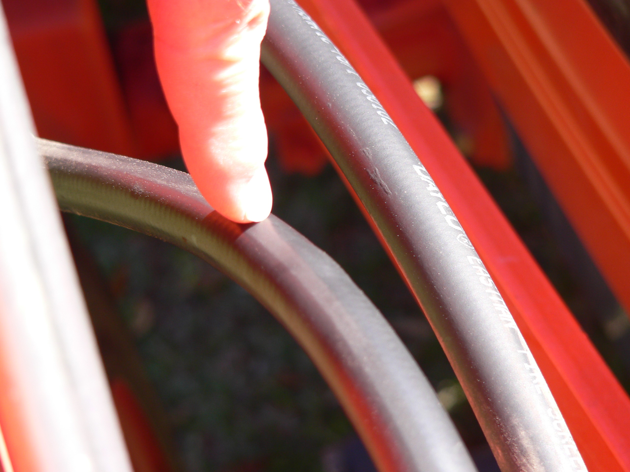

I just noticed that on four of the hydraulic lines going to my loader bucket there are what appear to be blisters. The attached picture shows one, it's in front of my finger. They do not bulge when the loader is operated and can be pressed down with your finger. It is on an LA 482 loader on an L3010 Kubota, about five years old. I never noticed them before yesterday when the sun hit them just right and some were obvious. Is this a fatal flaw where I need to get new hoses or just let it ride.

I would replace them ASAP, you dont want 2000+ psi hydraulic fluid squirting out all over the place.

I have seen the same sort of thing on auto tire sidewalls. I would guess that you are not in immediate threat, yet. Otherwise, hyd fluid at a high pressure would have already shot through the thin rubber hose wrapping, if it were a real leak. I think some fluid migrated, (osmosis?), thru the hose and is caught under the final layer of rubber. What would I do?...I would measure the longest hose on the loader and buy that size to keep as a spare on the tractor-just in case. I am interested to see what the "been there done that", folks say...

A bubble in a hose doesn't mean it is about to bust. Like the man said above, if it were leaking it would have gone through the rubber coating no problem. If you are concerned I would take a garden hose big enough to put the line inside of so if it did blow it wouldn't spray hot oil on you. We use old fire hose a lot to bundle hyd lines in especially in the engine compartment and where chaffing is a problem.

Believe it or not, this is a common problem in certain brand hoses which have a certain cover. Well, it's not really a problem, but many people end up replacing hoses unnecessarily because of it. If this were fluid under pressure, you wouldn't be asking if it should be replaced or not. It would already be done. Certain make hoses have a sealed cover. All, and I mean ALL brands of hoses weep fluid thru the hose. Some brands deal with it better than others. Gates and Dunlop are a couple of hoses in particular that does this. The hose in the picture has a very airtight cover which won't allow built up gases to escape. If you take a razor and make a small slit in the bubble, you will release the harmless gases. May be oil also, but nothing to worry about. If it makes you feel better, get them replaced and save these for spares. My advice, take the money you would have spent on replacements and take the family out to dinner.

5. Problem: Hose cover blistered and
pulling away from carcass. Gas has
effused through the tube and become
trapped under the cover.
Solution: Use perforated, pin-pricked
or fiber cover hose.
Page 28 in my copy....

Thanks for the replies. I'm glad to hear it is fairly common and I don't have a real problem. I appreciate all the advice.

Working as a construction mechanic for many years I was many "blisters" on the hyd lines. I do not remember ever having one that had oil in it. I would poke a little hole so that the blister did not grow. I always just figured that it was air in the processing that got trapped between layers.
