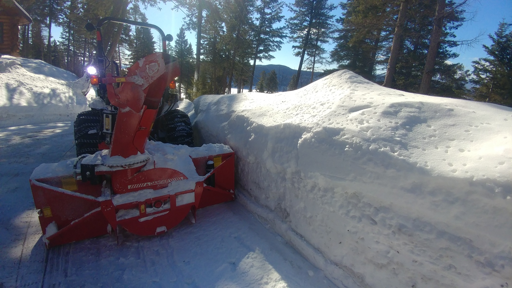

3/10 of a mile, gravel driveway with hills and 2 (90) degree turns, annual snowfall 144”. One area drifts. I been using the plow for 4 years and then moving piles with the 35 hp mule. I bought the mule with a backhoe for a build project and am done with the build. My thing is why have 2 different snow machines? Sell the truck with plow.

My experience is that a 62” front mounted snowblower takes two or three times as long as. 7’6” truck mounted plow for nuisance snowfall of, say 6” or less, but is invaluable for moving the banks back and clearing snow next to the raised deck. Your winters seem relatively mild, though, with only 144”, so I don’t know...
I previously used a skid steer to move the banks back, but the snowblower mounted on the tractor is a more efficient machine for that task.

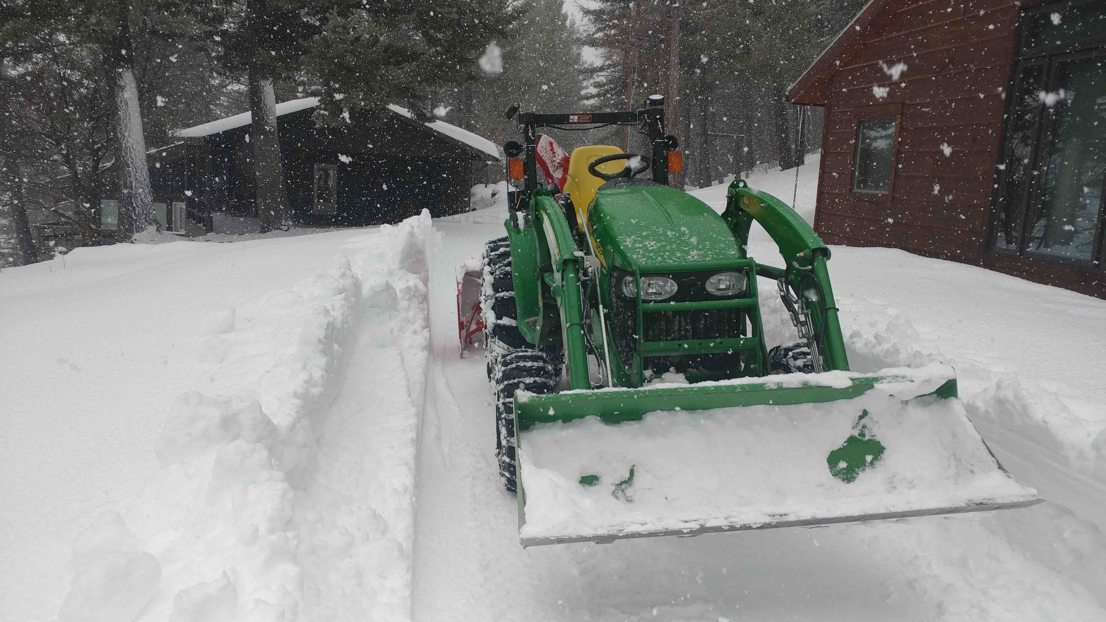

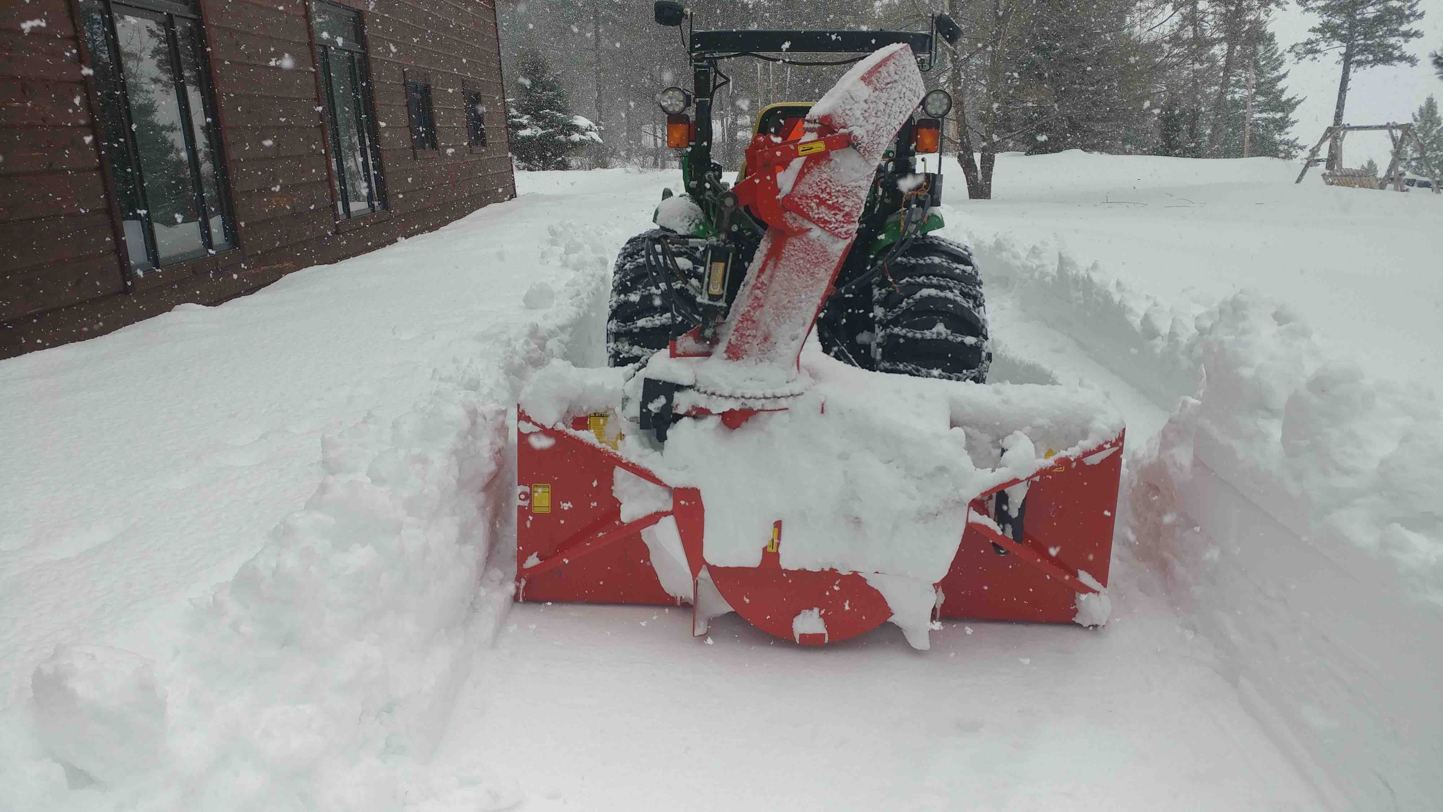

Witbread, I agree that the blower is the correct tool in some situations. Much of our snow comes in daily dumps of six inches or less that can easily be pushed aside with a truck mounted blade in a few minutes. It does a better, and faster job than the blower.
After a few weeks, or a two foot dump, the blower shines. An hour or so of occasionally moving the banks back with the blower beats spending 45 minutes daily on the tractor, when the truck clears the drive of a light six inch daily snowfall in a few minutes.

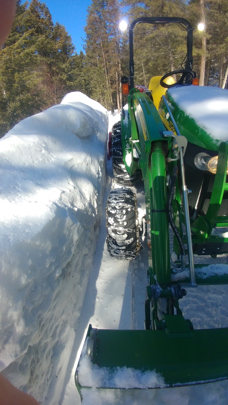

I have the uphill driveway issue too. Small snowfall is no problem, but uphill plowing is an issue with heavy snowfall.

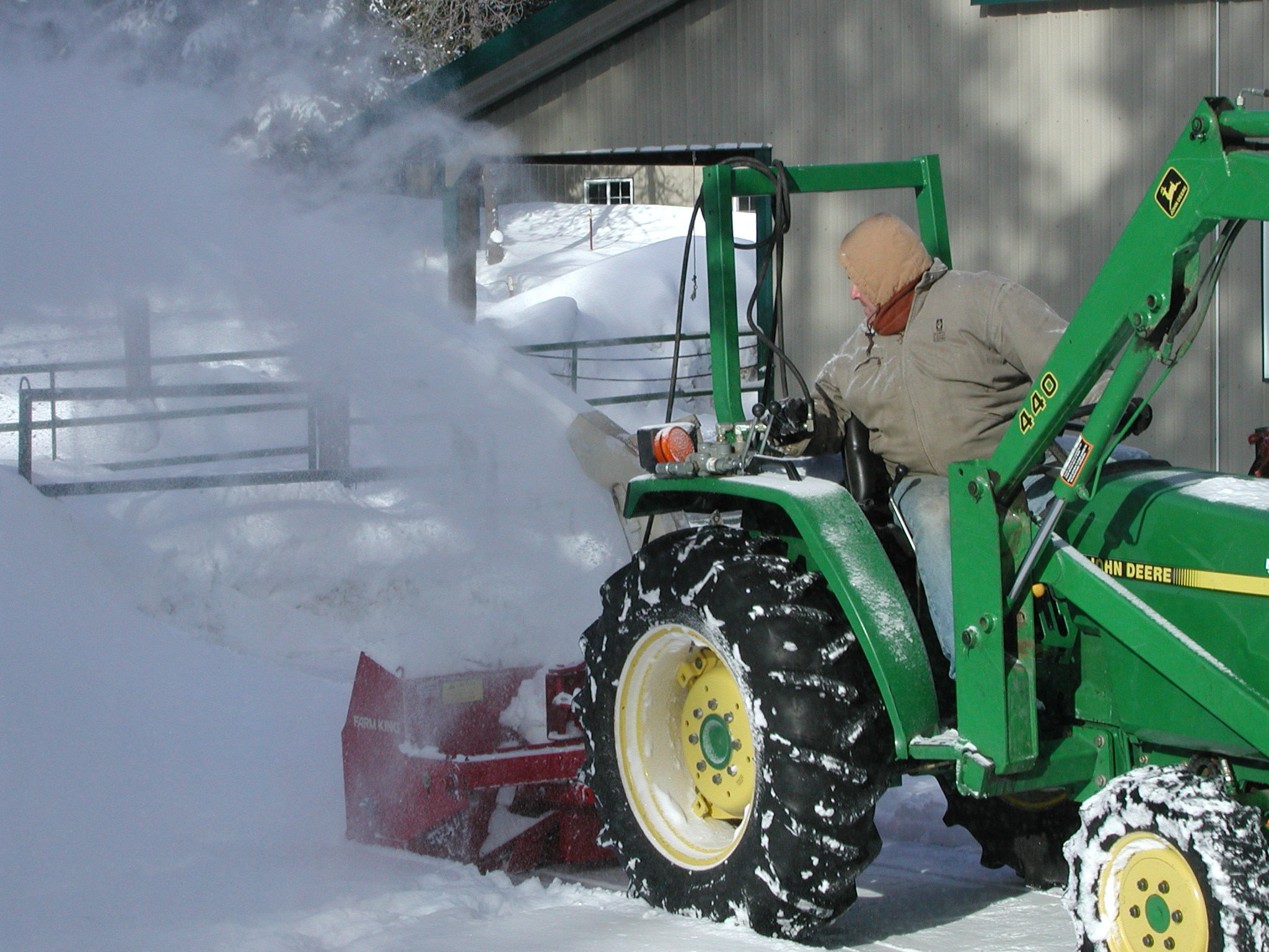

Here is the setup we have on our L3830 with a 7' Loftness front snowblower.
Rear gearbox:
First rear to front PTO section:
Second rear to front PTO section and mounting frame:
Front frame and snowblower:
It was originally on a larger NH, but I adapted it to our L3830 and it works well, have to go slow in heavy stuff though.
