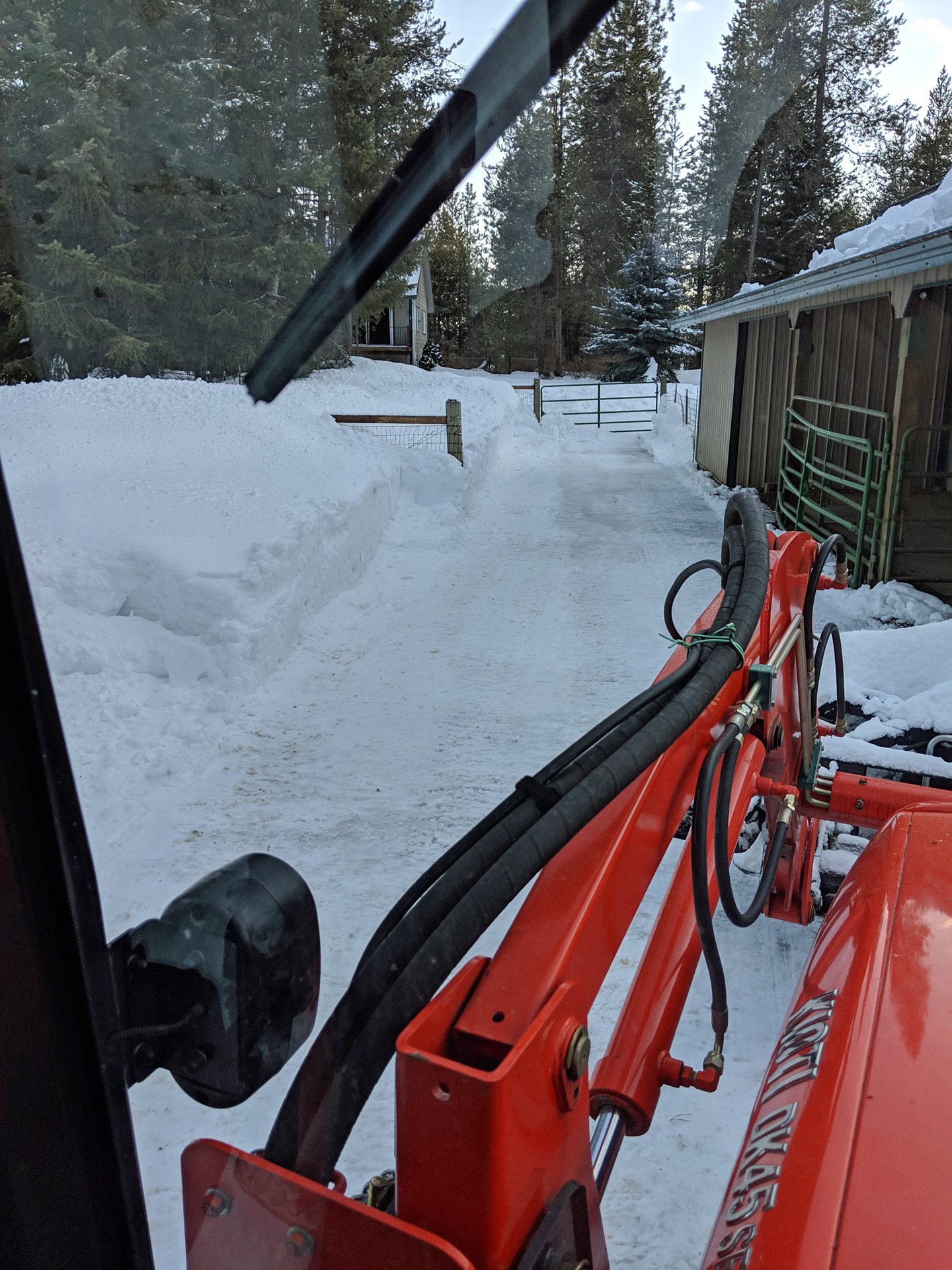

3/10 of a mile, gravel driveway with hills and 2 (90) degree turns, annual snowfall 144”. One area drifts. I been using the plow for 4 years and then moving piles with the 35 hp mule. I bought the mule with a backhoe for a build project and am done with the build. My thing is why have 2 different snow machines? Sell the truck with plow.

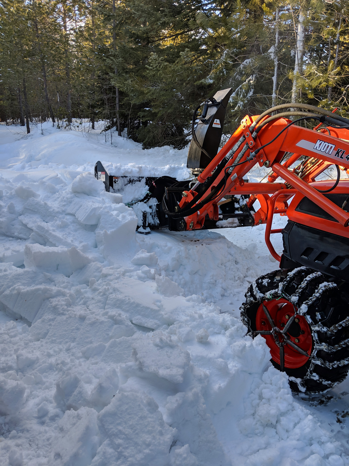

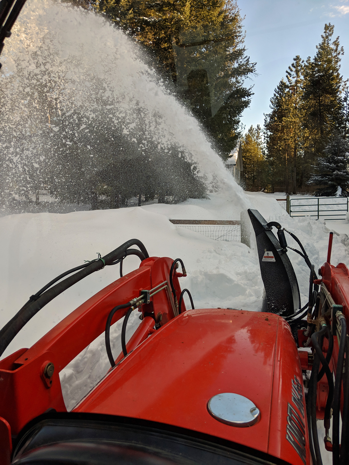

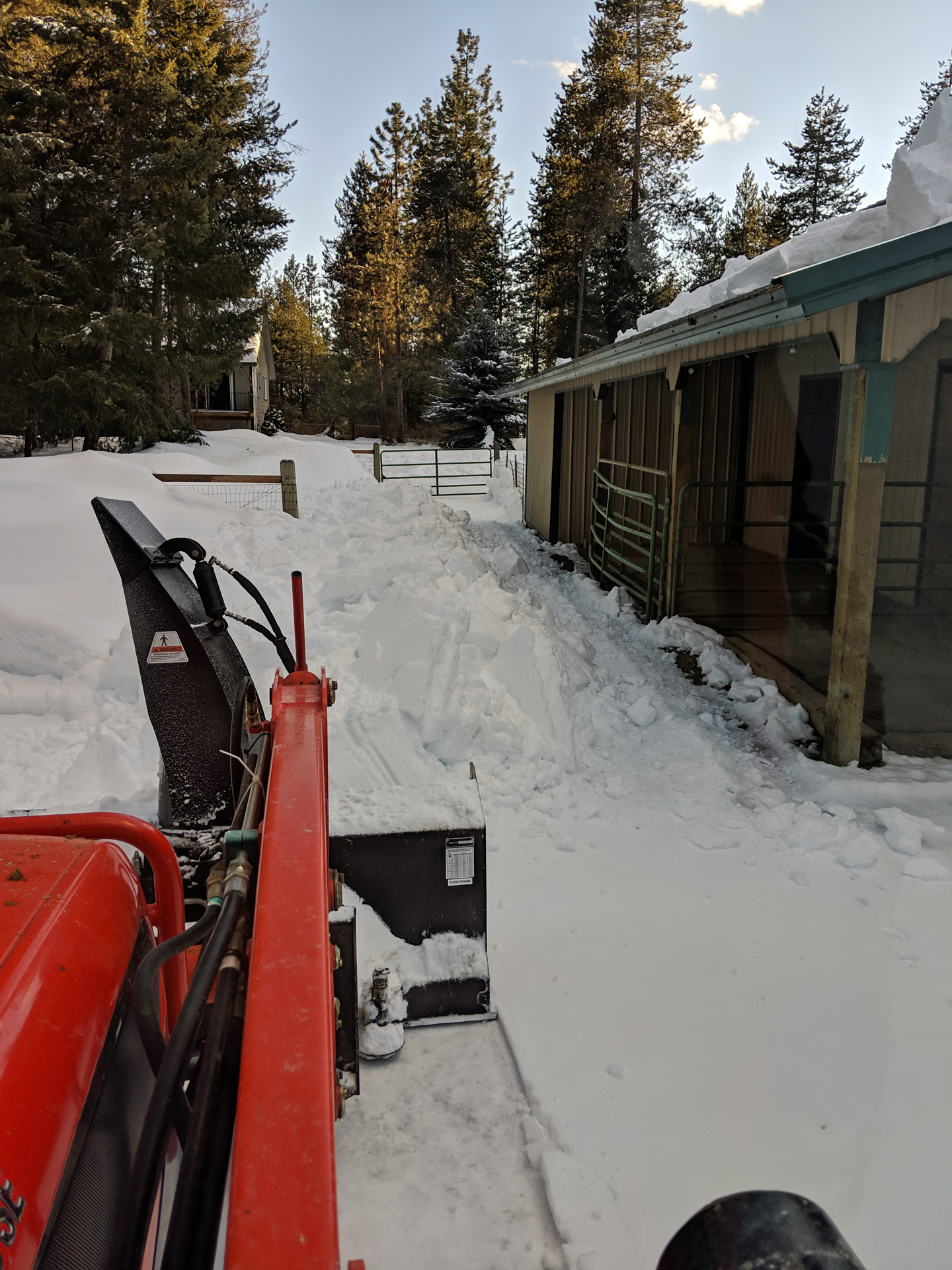

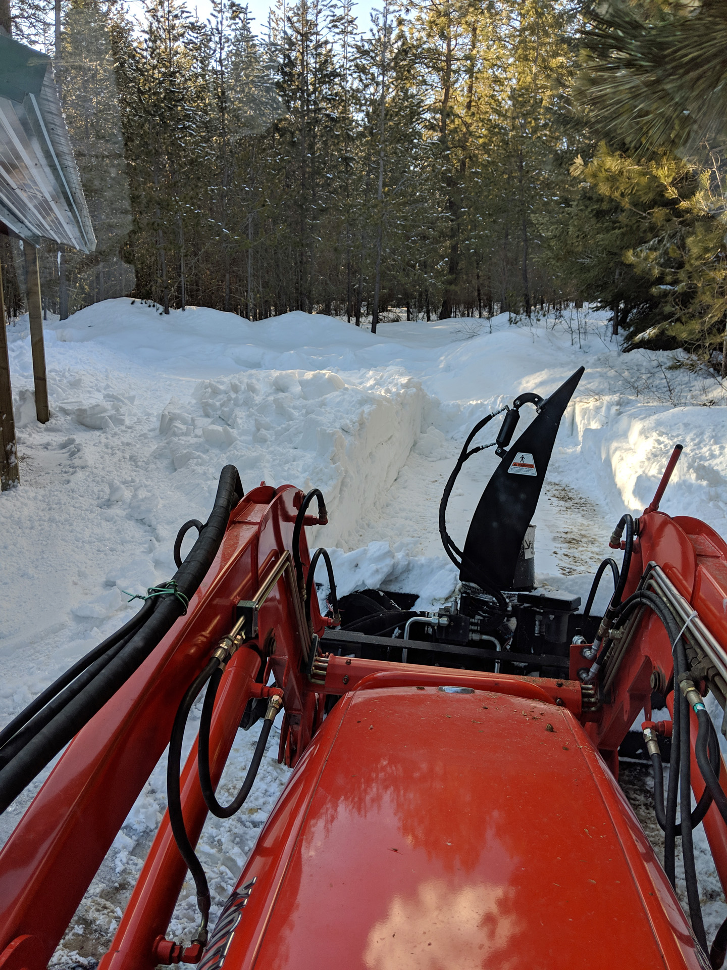

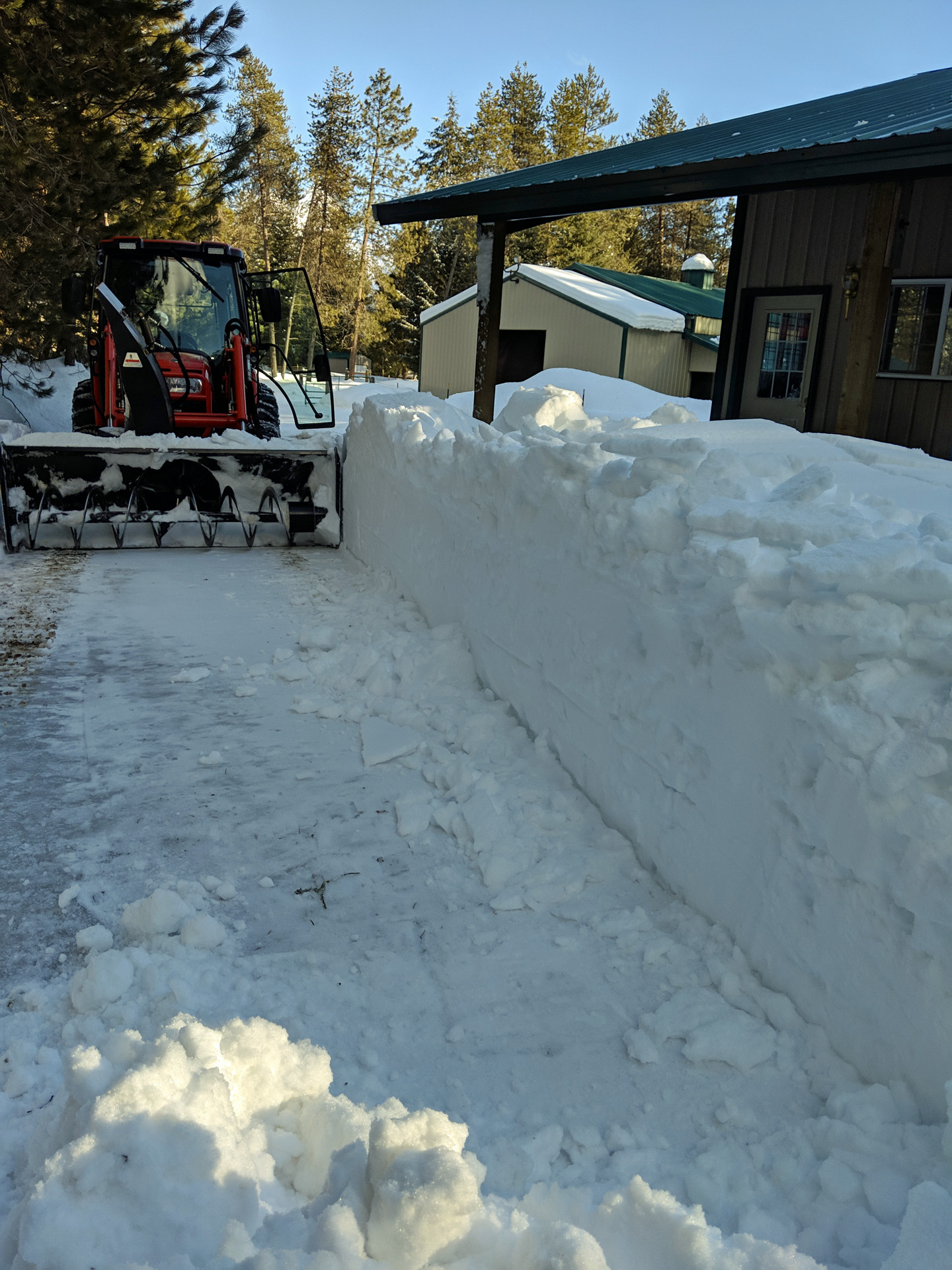

I have the opposite sentiment of truck vs blower. My driveway has a steep grade and tightly winds through the woods. Plowing it for the last 3 years was a giant PITA. Couldn't plow uphill many times, had to push banks back between trees in 10 different places, and I ended up with massive piles all over. Now with the blower on the tractor, I can blow uphill easily, don't have to do push offs all along the drive, and I'm done in the same amount of time or less. That was before the turbo addition over the weekend, I'm willing to bet I'll save an easy 5-10 mins now not having to worry about bogging it down.
It's a 5' blower driven by mid pto. I'm running at full speed in low range into 10" of fresh powder. Could never do this before. New Holland 1620 turbo - YouTube
As an overall use tool, I also vote for the blower also as a plow would never let you clear drifts like this. This was 14 hours of drifting last week BTW, I'm in the middle of a road making a path to a fellow firefighters stuck pickup.
