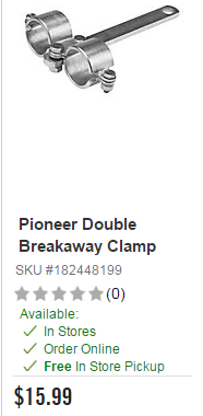

You may want to think about using something like this, it provides a breakaway point if a line gets snagged. This is from Tractor Supply but it should be available at other locations.
/ hydraulic fittings
looks good may just have to get one thanks 1064
