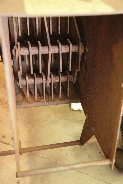

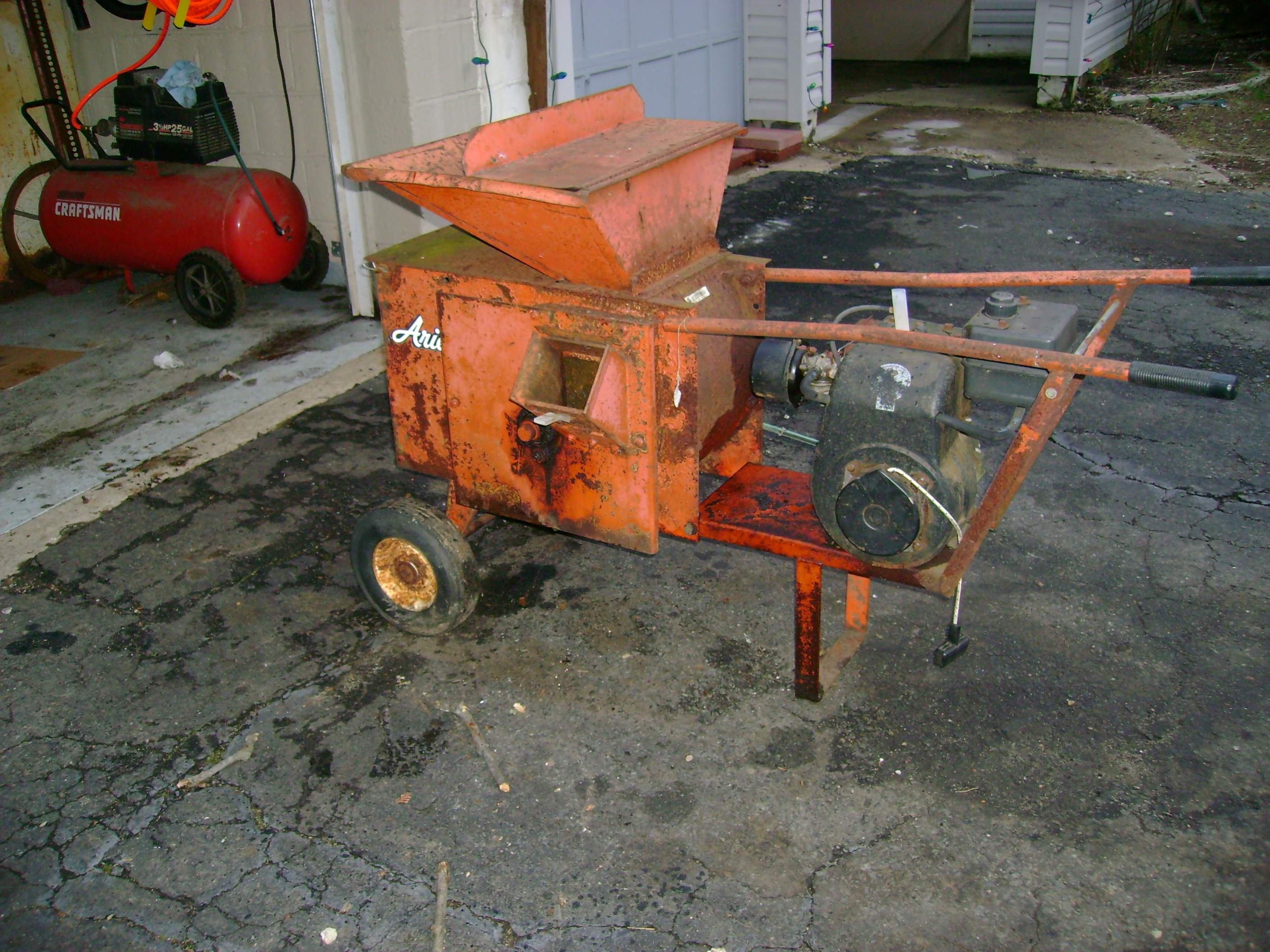

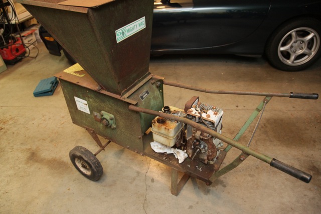

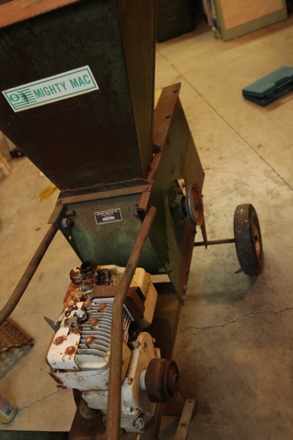

Hi guys,
Well, I picked it up. Here are some photos. The 5HP Briggs and Stratton gas engine is just toast. I bought a few parts and tried to resurrect it, but I really don't think it will be worth it. I've already spent $25 on parts, and it will probably take another $50 before I finish IF I can get the gas motor working again. As you can see by the photos, it's a wreck. I don't think I've ever seen so neglected an engine. It's clear it sat outside for years before I picked it up today. Water in the gas tank, rust everywhere, ick! When I pulled out the 'foam' air filter, it was like styrofoam, and was falling apart in my fingers. Ugh! It's so corroded that the pushrod for the ignition points is rusted and stuck inside the engine - that's why there's no spark - the points don't have anything to ride the camshaft and break the points open, if you are familiar with how these engines work. A mess. I could buy the breakerless ignition and work around this problem, I'm not convinced its worth it.
Anyway, I picked up the whole contraption for $70, and despite the neglect, the shredder itself is quite sturdy. It is made of sheet steel with hefty steel hammers and a thick steel filter grate. It's sturdy, like a PT! A similar item from MacKissic today runs around $2000, although newer units have a chipper as well as the shredder.
You can see that if I take out the gas powerplant, and put in a hydro motor with the centrifugal clutch-pulley on it, then it should work. I'll need to fabricate some kind of sliding mount for the hydro motor (the v-belt tension is adjusted by moving the gas engine back and forth on its engine platform.) and I'll need to drill off the pulley (it's rusted on the gas engine) and tap it and reattach to the hydro motor.
The photos speak for themselves.
I admit it looks pretty rough, but it's all surface rust, and the mechanics are sound. The bearings on the shredder have no play and spin freely. The hammers actually don't look very used. The wear is completely due to exposure to elements.
Your input is solicited.
-Rob :)

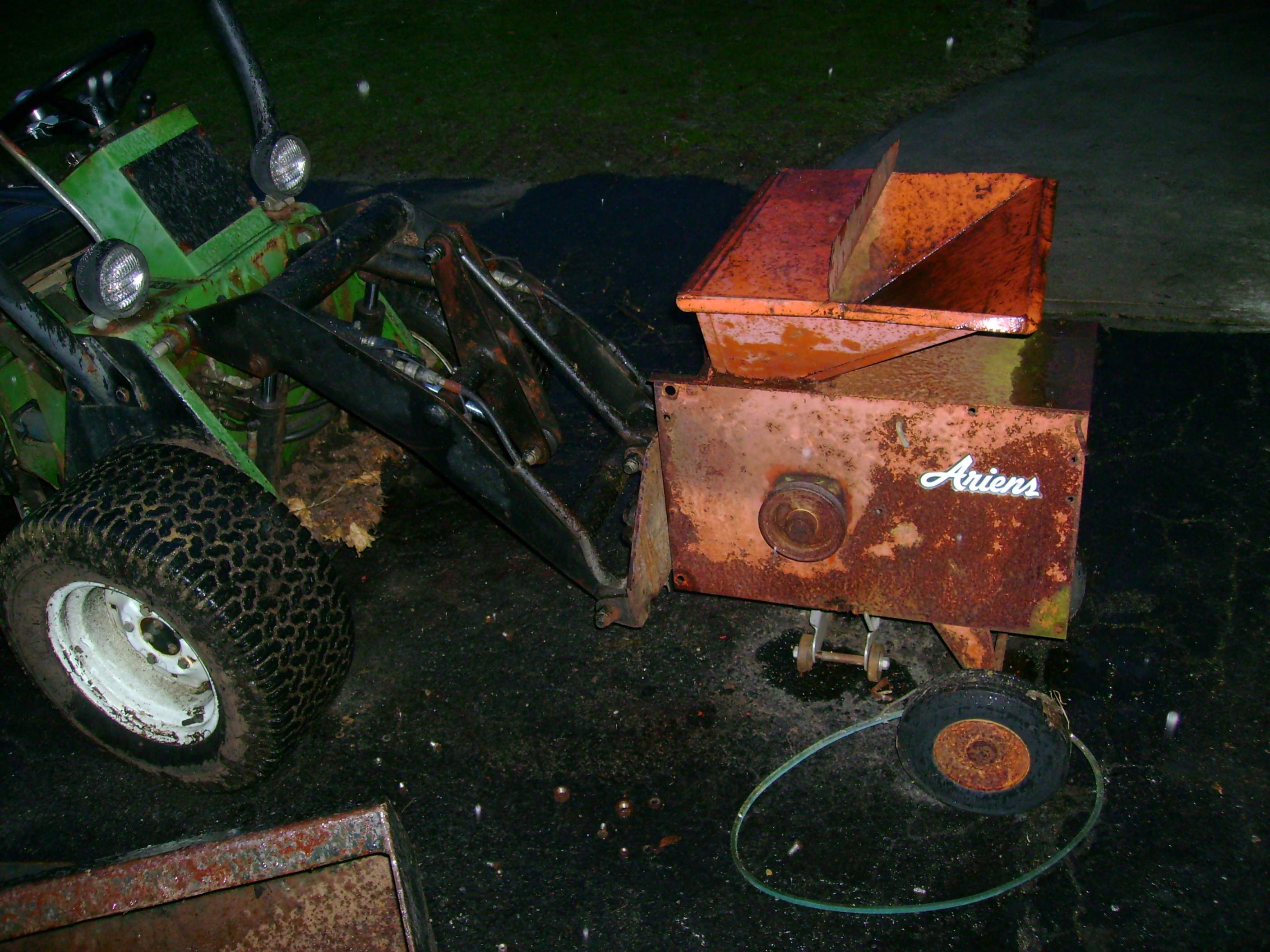

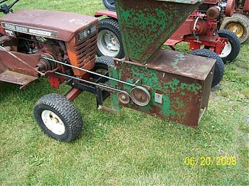

/ Hydraulic Chipper/Shredder Project #29
I am following this thread with great interest. As you can see I have the same project going on and I am happy to let Rob figure it all out for me.:D;) Actually I have been thinking about mounting it on a Garden Tractor like the last pic. Not sure. Either way it is one less engine to worry about.
Unfortunatly my project is a little low on my list of things to do. So I am not going to be working on it for a little while.
