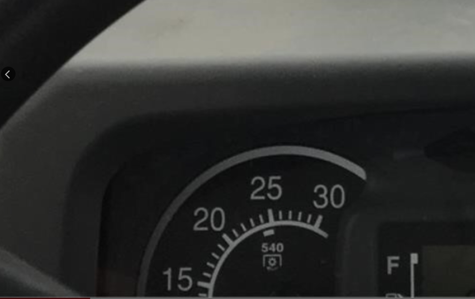

OP isn't treating the hydro pedal like a gas pedal.....right?
(i.e. don't push pedal down more as tractor slows down, instead lift pedal for the "shift to lower gear" equivalent.)
He wouldn't be the first.
THANK YOU
I have mentioned that several time on here and never seen an response

Good points about the linked throttle and the HST pedal not being an acceleration pedal. It took me a bit to realize that the transmission needs higher rpm to work properly and to get the feel of using the HST pedal. When working it hard I have the throttle set at PTO rpms and monitor the tach to control the HST pedal position. When the rpms start to drop I back off the HST pedal until the rpms get back to PTO speed. It's a balancing act and I have that figured out.
With the HST I can keep the rpms up but have to watch the HST pedal position in order to maintain the rpms
As you can see I have already addressed the Hydro pedal position.:)
There is no red line or PTO info on this tach. Basically it just shows the rpm's. I checked the owners manual and can't find the max rpm info but this tractor will only rev to about 2510 max and that is where I run it when working it hard.
FredH thanks for that link. As D2Cat suggested there must be a misprint about the drawbar HP. I wish it were true though because if it was I wouldn't have any problem dragging my little boxblade.
