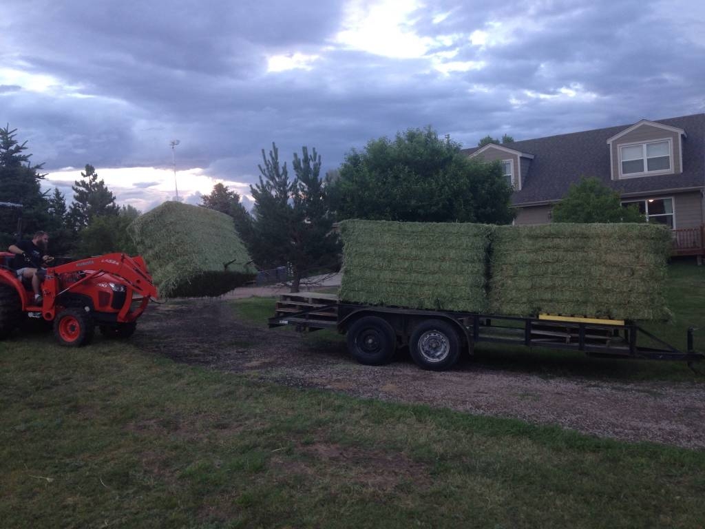

I nearly rolled my L3200 lifting large bails helping a friend I had a rotary cutter on the back & 2 50 lbs sacks of something on the back of the cutter. Lots of ballast weight with even more ballast leverage due to the cutter length. I think I had loaded rears by then too. It would barely lift the bales, so lack of hydraulic pressure was my concern. Right up until the back end got light & things got squirrely. Bale fell off & I didn't roll. A while later under warranty the front axle seals started leaking. Dealer changed out the seals & bearings.
I can't say the bales caused the front axle issues, but I'm sure it didn't help.
HP & hydraulic pressure aren't the only limits on these machines. I'd much rather have my hydraulics go into relief than my contact between the tires & the ground or front axle go into relief. Much cheaper & less likely to kill me View attachment 3158532
That tractor looks too small to be lifting those bales.
Part of the reason I replaced it with a L4060hstc. Not that I've really moved any bales in the 6-7 years I've had the new machine.
