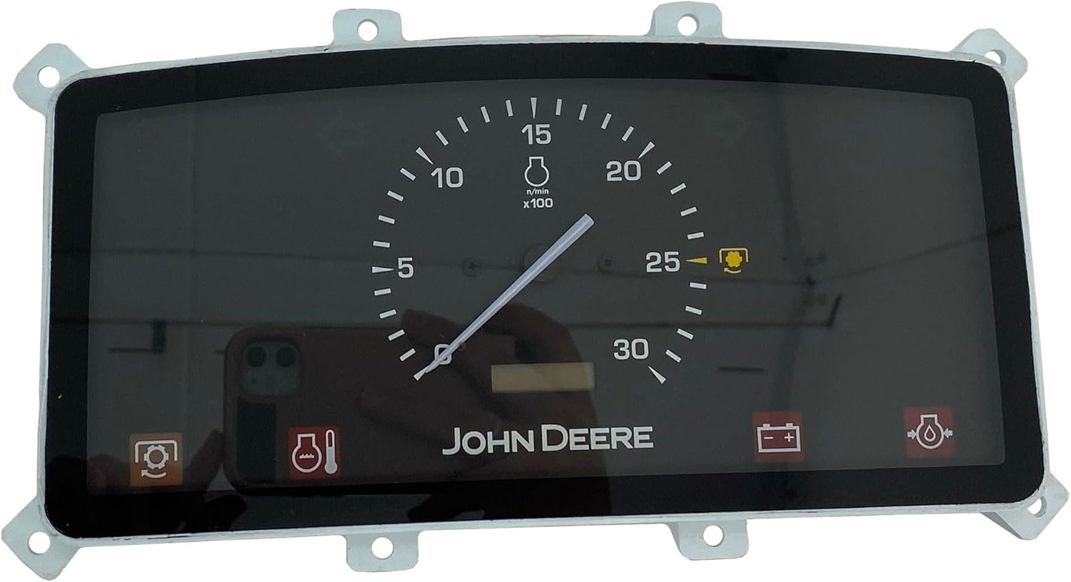

I always thought the yellow gear thingy was the 540 PTO indicator. Always learning something at TBN
Ok...I stand corrected. Optimal cutting is 540 rpm which is 2500 engine rpm (roughly). I was trying to make an example...my mistake.
If I have light duty cutting IMHO a bit lower tractor and PTO rpm is okay. Otherwise why even have a throttle. Everything should simply have a solenoid switch. Start tractor, flip switch and it's at 2,500 rpm.
My point is the module increases power. Fuel usage remains to be seen.
It's not for everyone and everyone does things differently...right or wrong.
