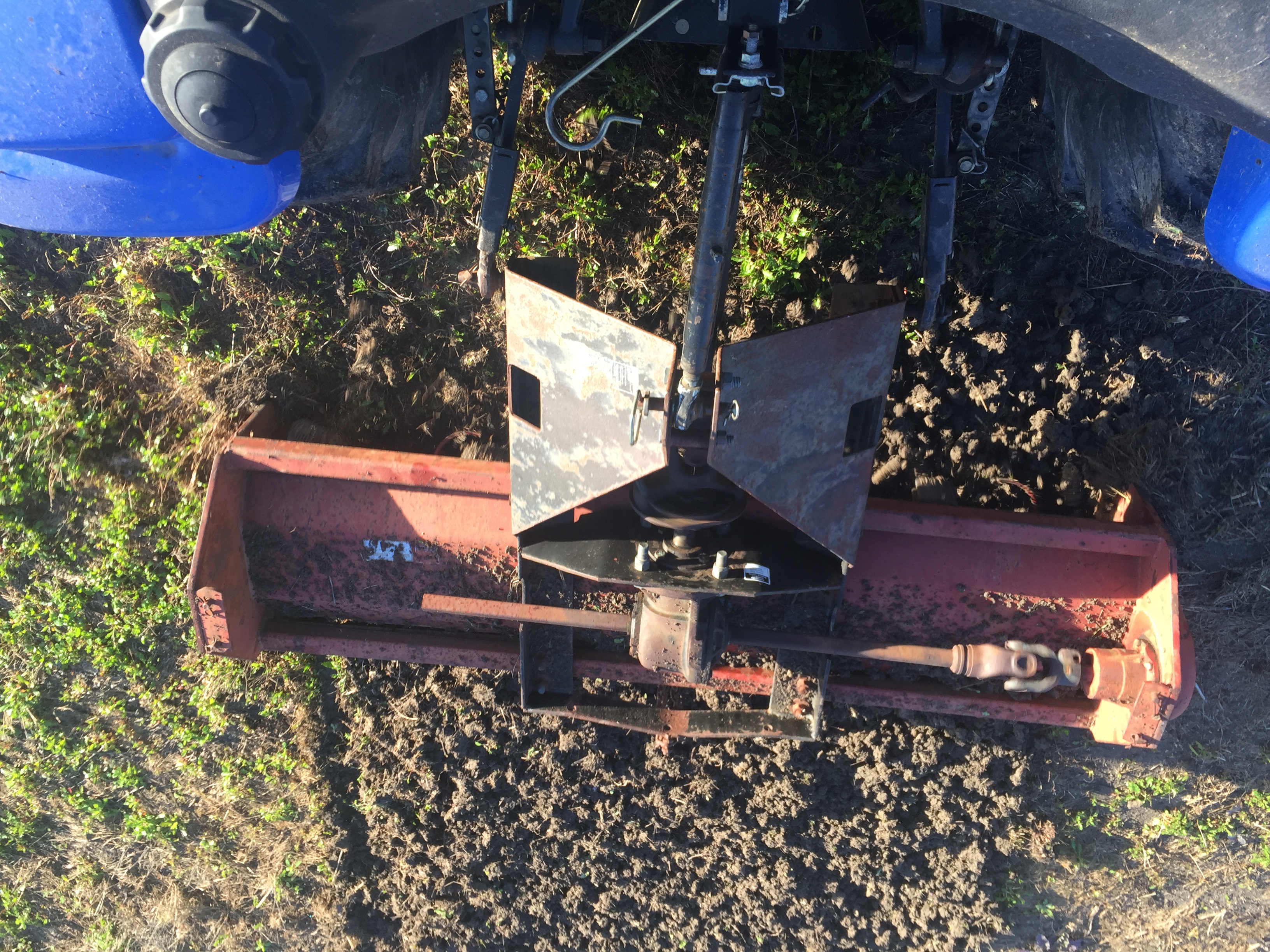

Received the replacement u joint from Howse Implement in Monday's mail and put it all together Monday evening. Rebuilt PTO u joint works perfect.

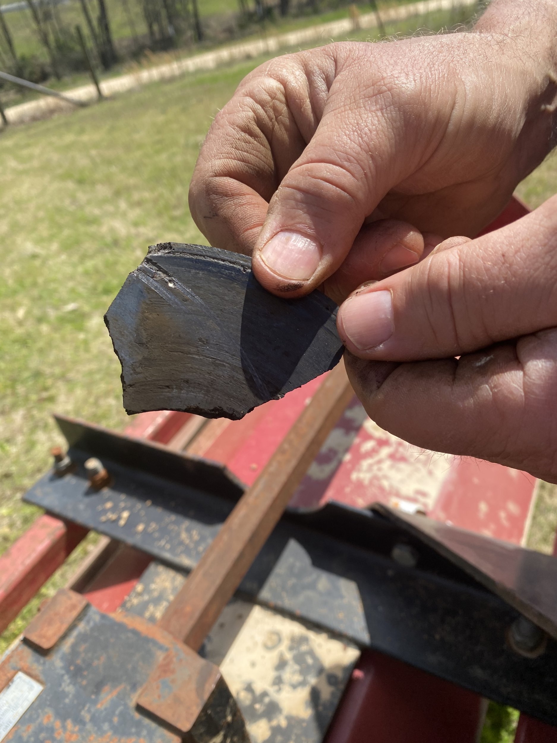

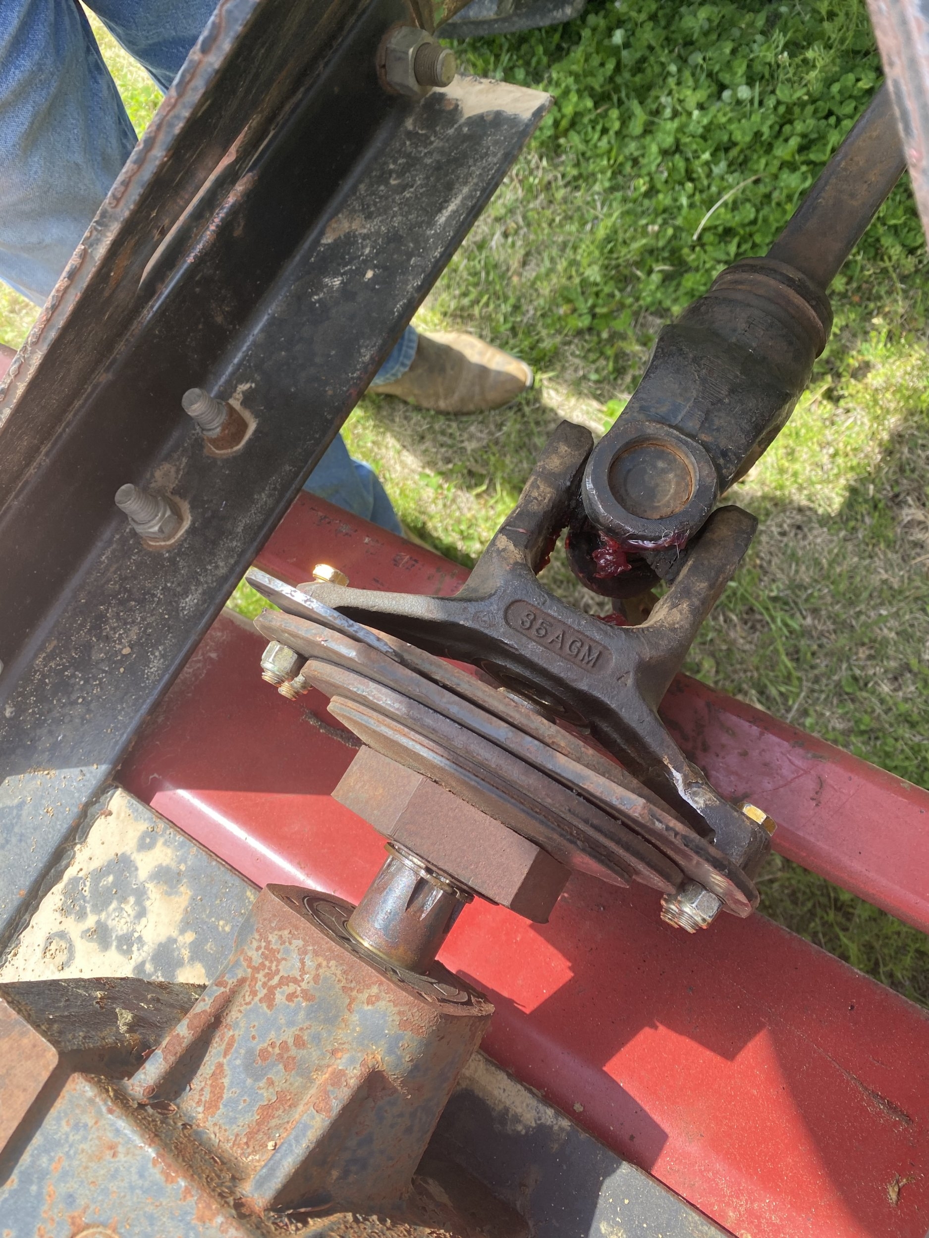

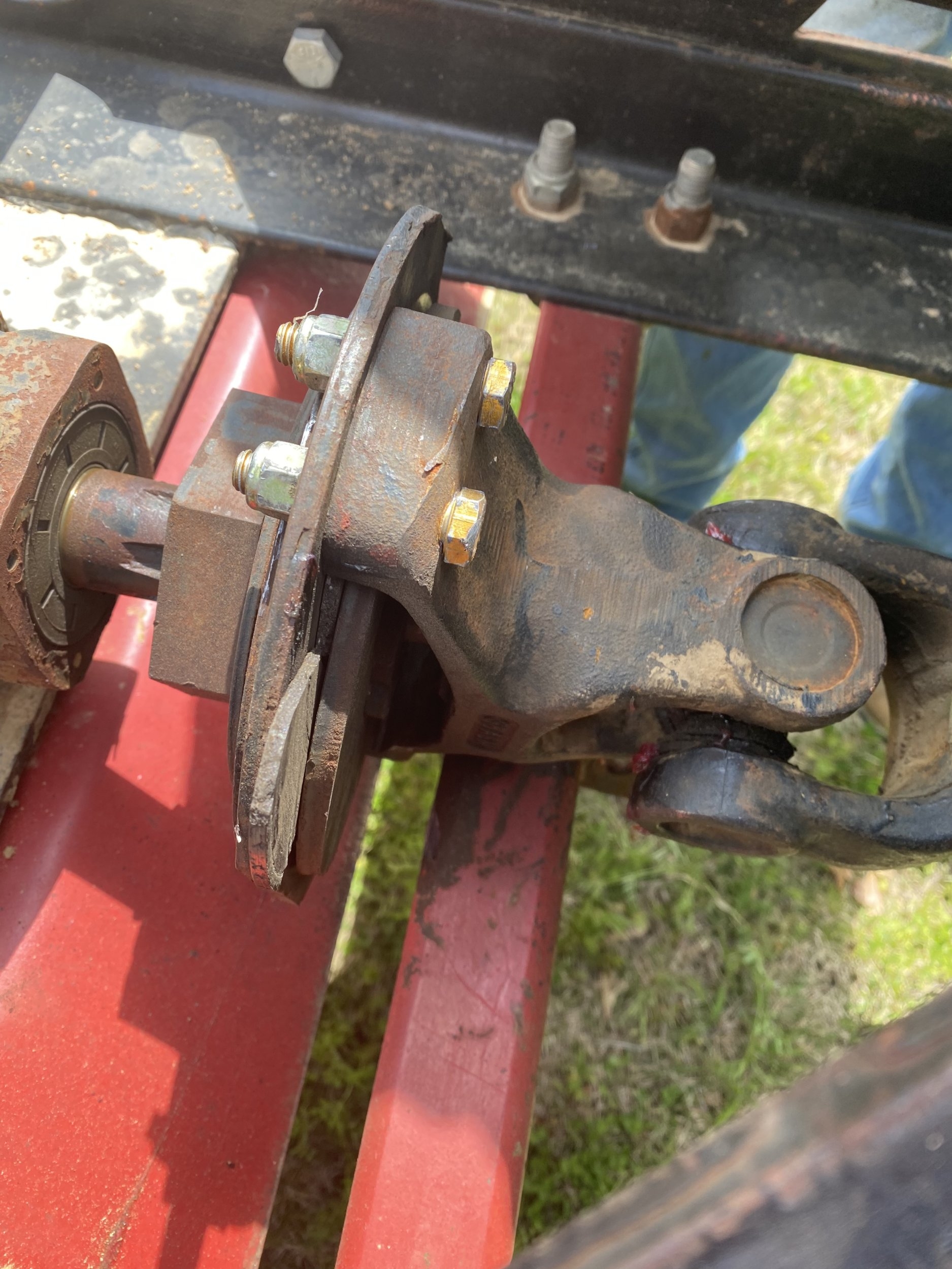

Good Afternoon. Question to see if you may know since it seems like our exact same tiller. I’ll post a picture of the part that broke out. I think it’s friction plates but not 100% sure.
NurseFarmer, I don't have that tiller but the piece in your hands sure looks like a broken piece of friction plate from the slip clutch. Should be an easy replacement part if you have a dealer somewhere.
   / howse 70 wide tiller - rebuild or replace rusty pto knuckle #15
Yep that is the clutch so if you hit something hard it will slip and not break the gear box or something else.

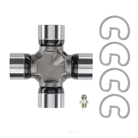

Tractor supply has some the snap rings are included
willy
   / howse 70 wide tiller - rebuild or replace rusty pto knuckle #18
That's what is usually inside the yoke and when they are
rusted out or wore out that item is needed to replace the
old one. I have done enough of them
