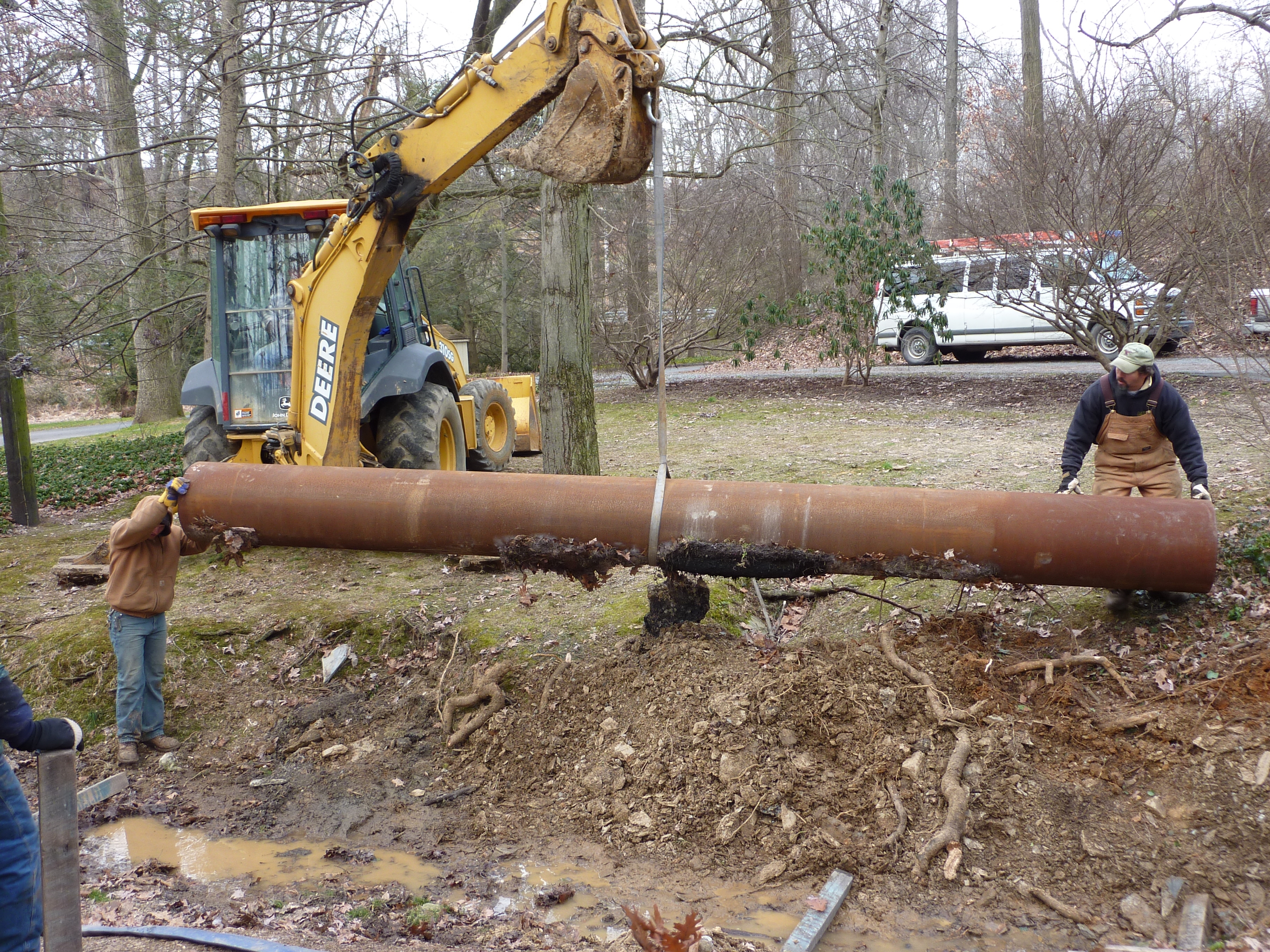

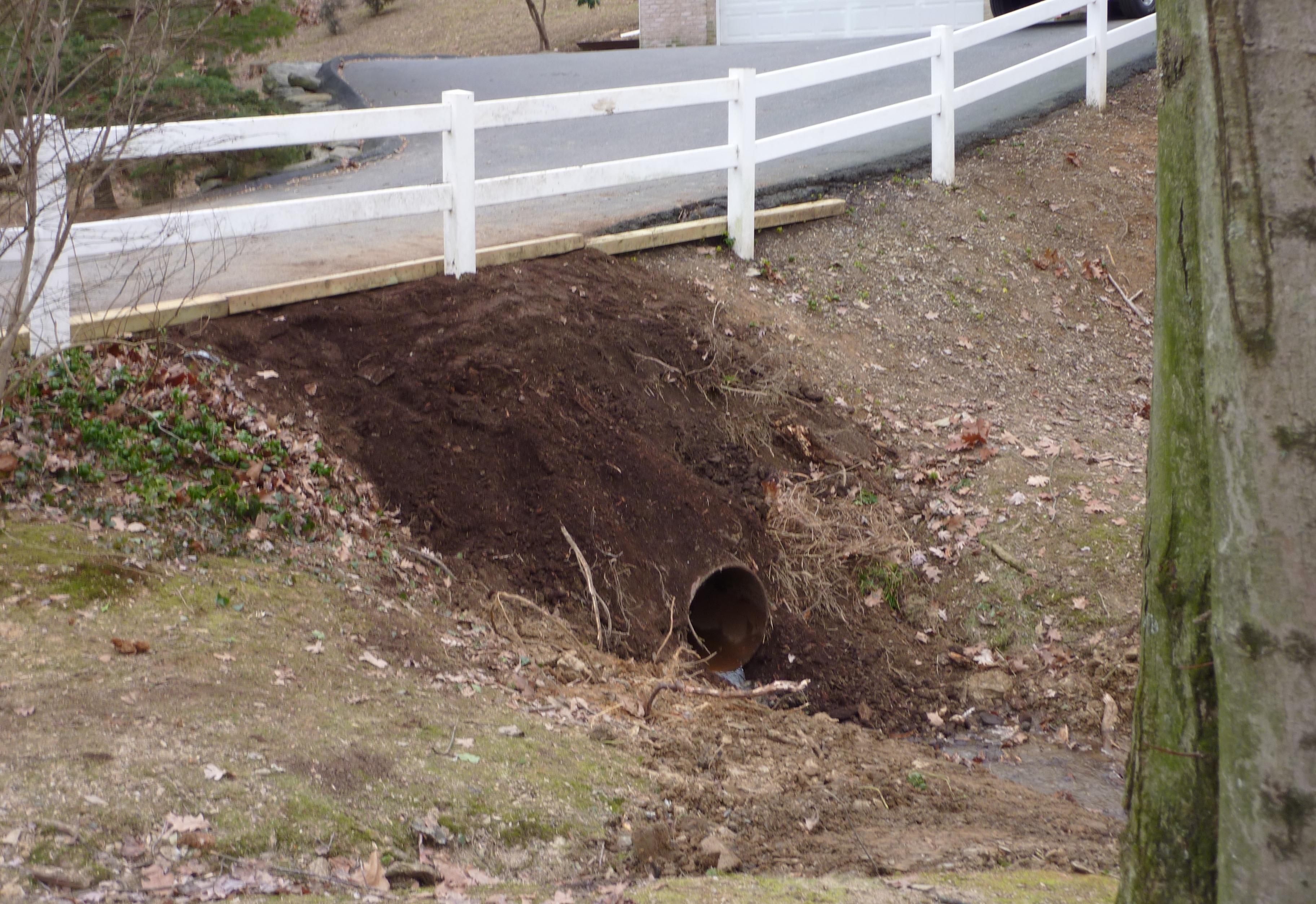

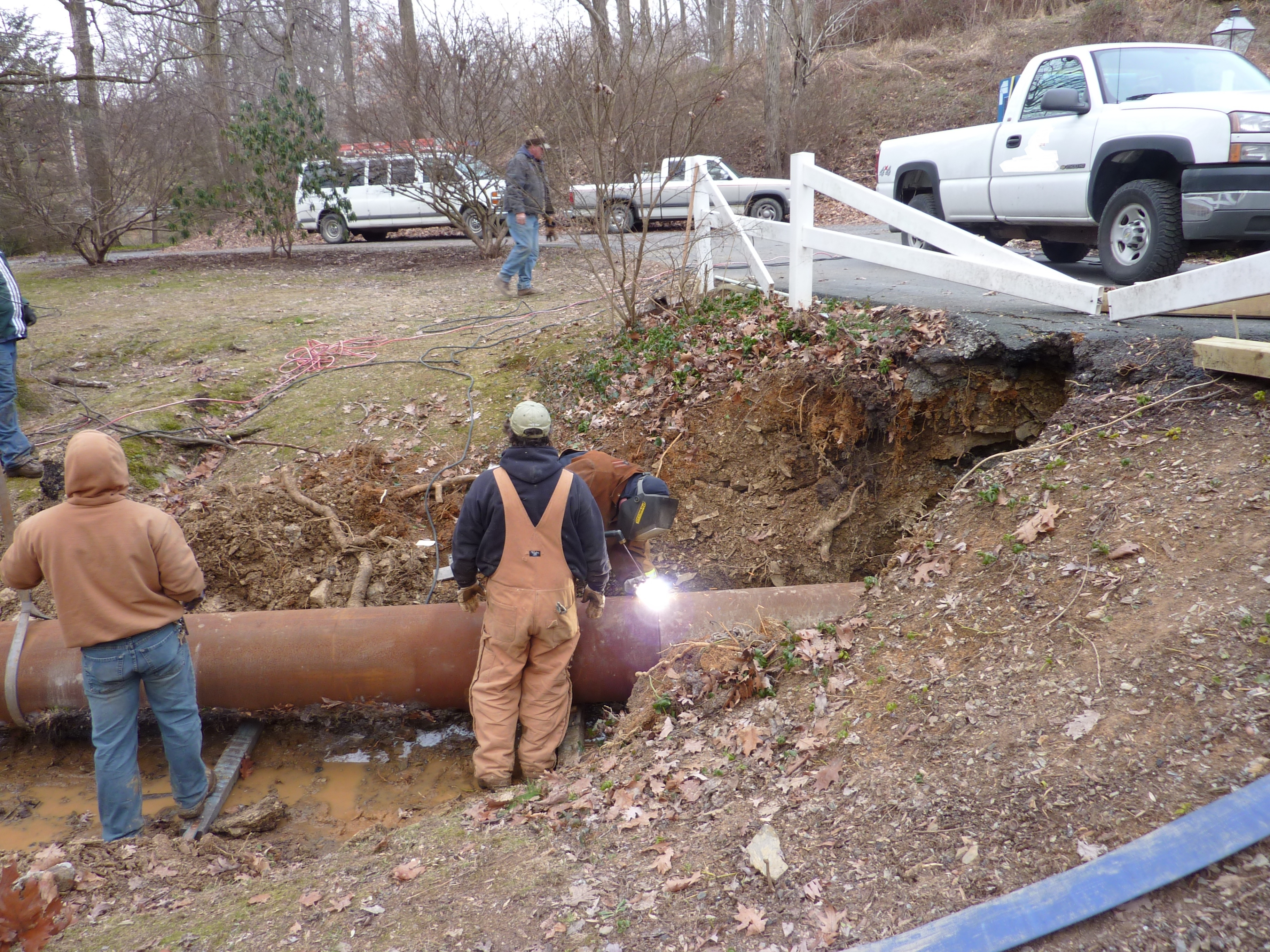

We did something on a much smaller scale. Someone we wanted to help out had a pipe under the driveway that was deteriorating. We gathered SCH40 steel pipe, some equipment and a few good guys. We had to clean debris out of the old pipe, which wasn't fun in the cold weather. Then we pulled the replacement pipe inside of the old pipe. Since the length of the run was more than one length of pipe, we welded the two sections together. It was easier to maneuver the separate pieces and get them into position than to manhandle (Deerehandle?) one long piece.

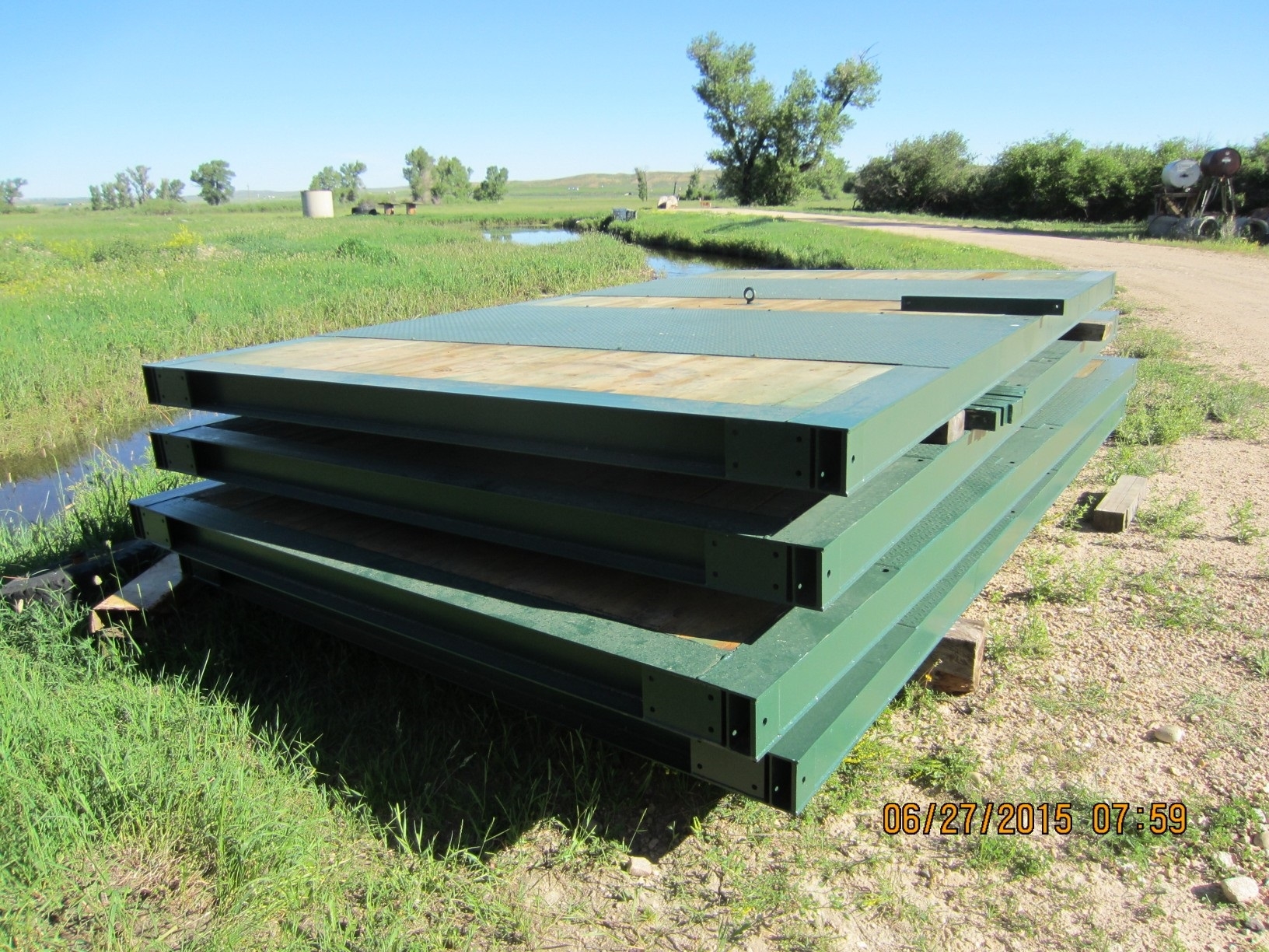

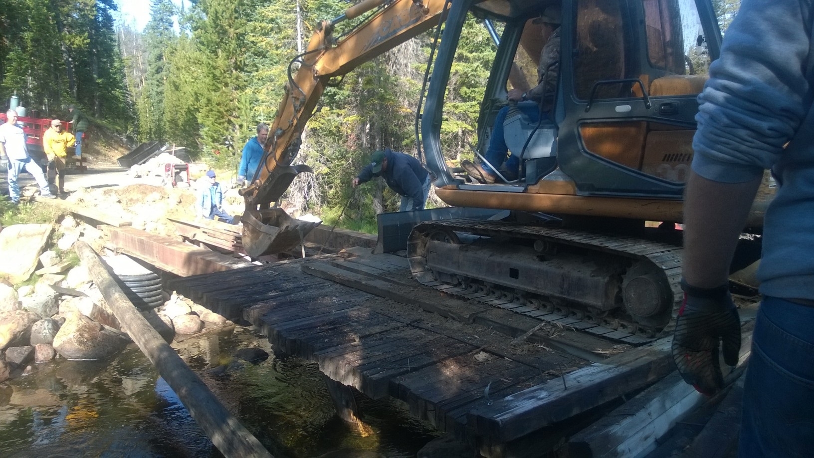

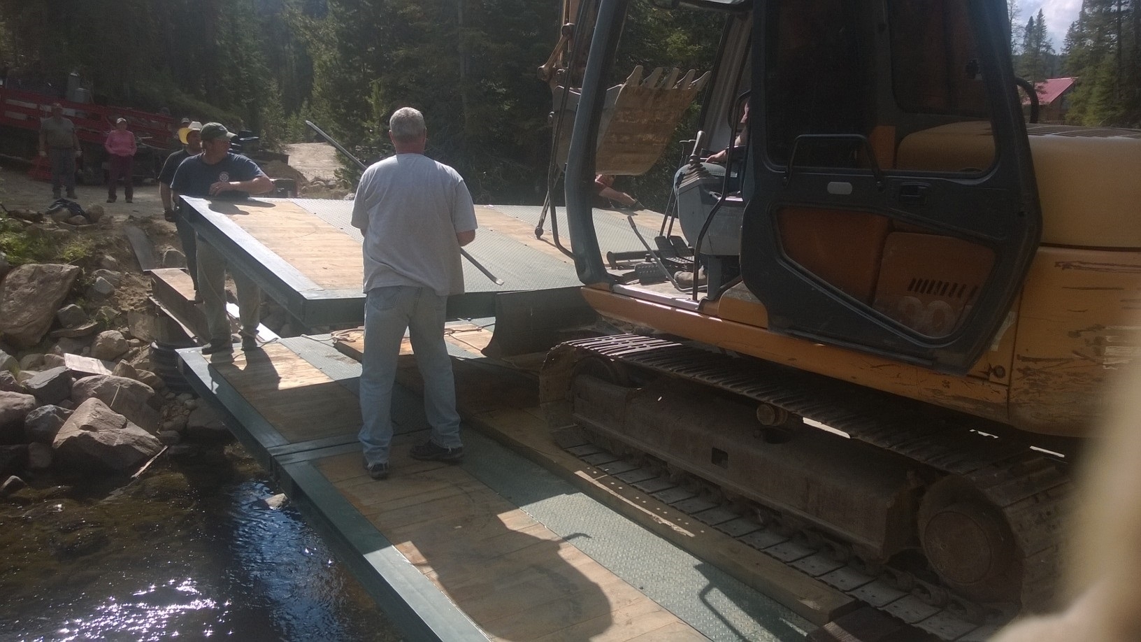

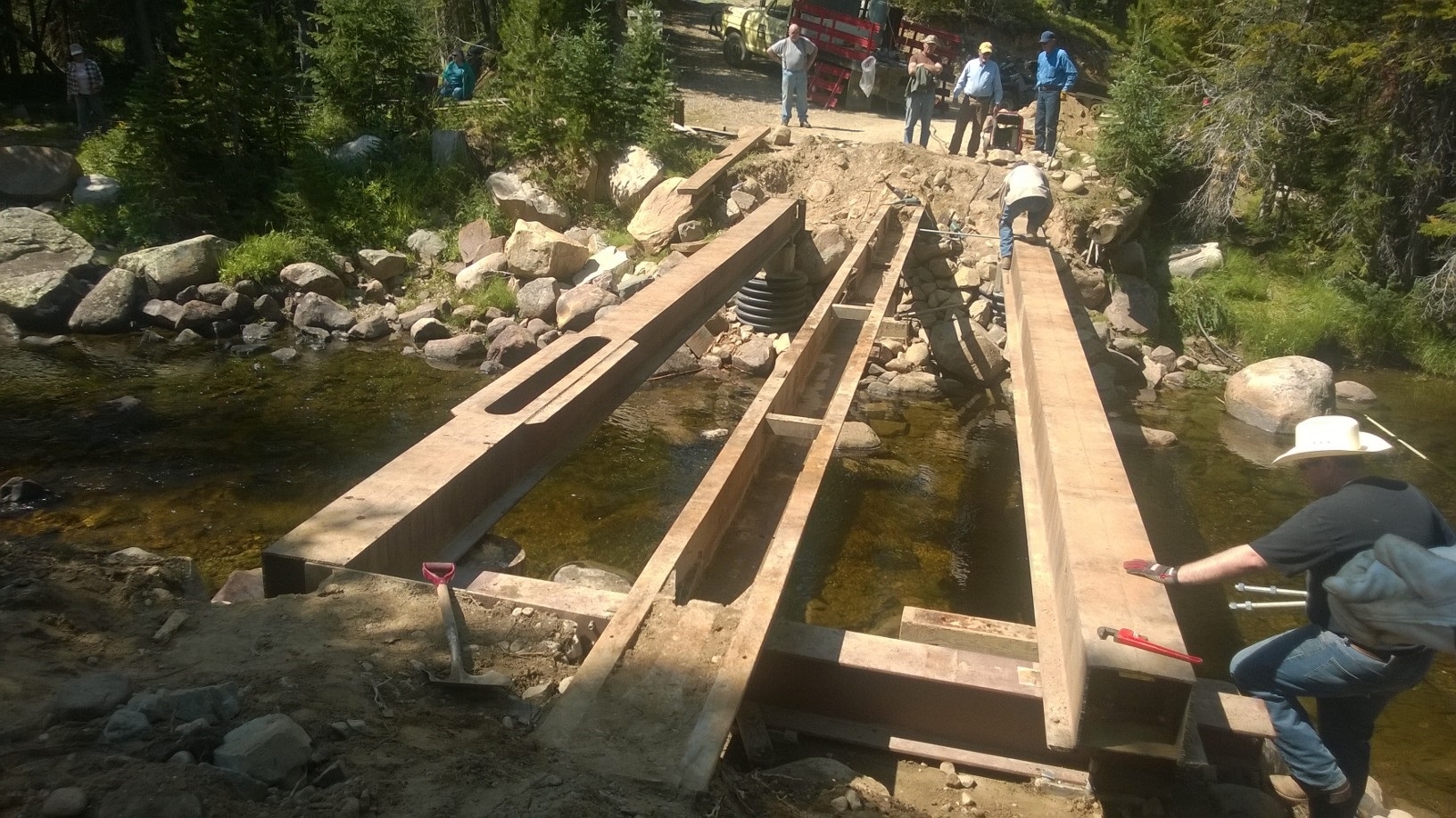

I have a cabin in the middle of the National Forrest here in Wyoming. In order to get to the cabins, we have to cross a river. In the 50's, they put an old rail road car to act as the bridge. The steel back then had a lot of nickel in it and prevented it from rusting out, making it still good today.
We had to redo the abutments and we had a mechanical engineer that made a system to float the bridge if the spring run off got too high. Ingenious. Basically it was not rigid mounted to the abutment and was held in by a serries of cables that let it float.
We reinforced everything and put in new bridge decking. Still working good about 10 years later. Has not washed out with the big spring run-offs.
