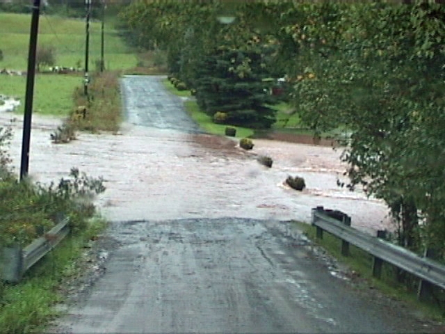

How wide is the stream, bank to bank upstream and downstream? Also how deep is the channel? Looking at your picture it appears that there is a fair amount of water going through, and the flow has been restricted at the bridge for quite some time. (113 years?)
While others mention regulations, I'd be more concerned with the new bridge blowing out. Paying to do it half assed twice is going to cost more than fixing it right once.
Concrete waste blocks are relatively cheap. Rent an excavator, go two blocks high if necessary and then you likely could go with the RR car. I've also seen them made with the steel from log truck trailers, and we trucked over them with 100,000 lb loads.

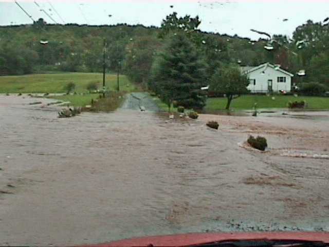

The stream (Navajo Creek) averages around 8' wide and 1 - 2' deep. The flow varies with rainfall. During high water events, the 6' pipe runs full.
What you can't see in the picture is, the bridge is sloped upward toward the left of the picture. The right side is only 2' above stream level. When the pipe obstructs the flow, the water backs up and flows over the roadway on the low (right) side. This acts as a "safety valve" and is likely why the bridge has lasted so long.
The most severe event happened during Hurricane Ivan in 2004:
