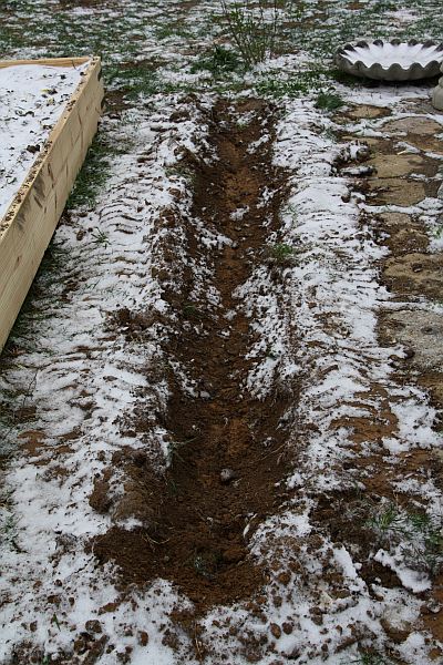

I figure if I'm breaking new ground, I can tear it up with my middle buster and then till.
It appears that my middle buster won't be much good in anything but decent topsoil... two passes pushed the 4" of topsoil out of the way and just scratched the clay underneath.
I think I'll put a 12" bottom plow on my 2 year implement list.
Ian

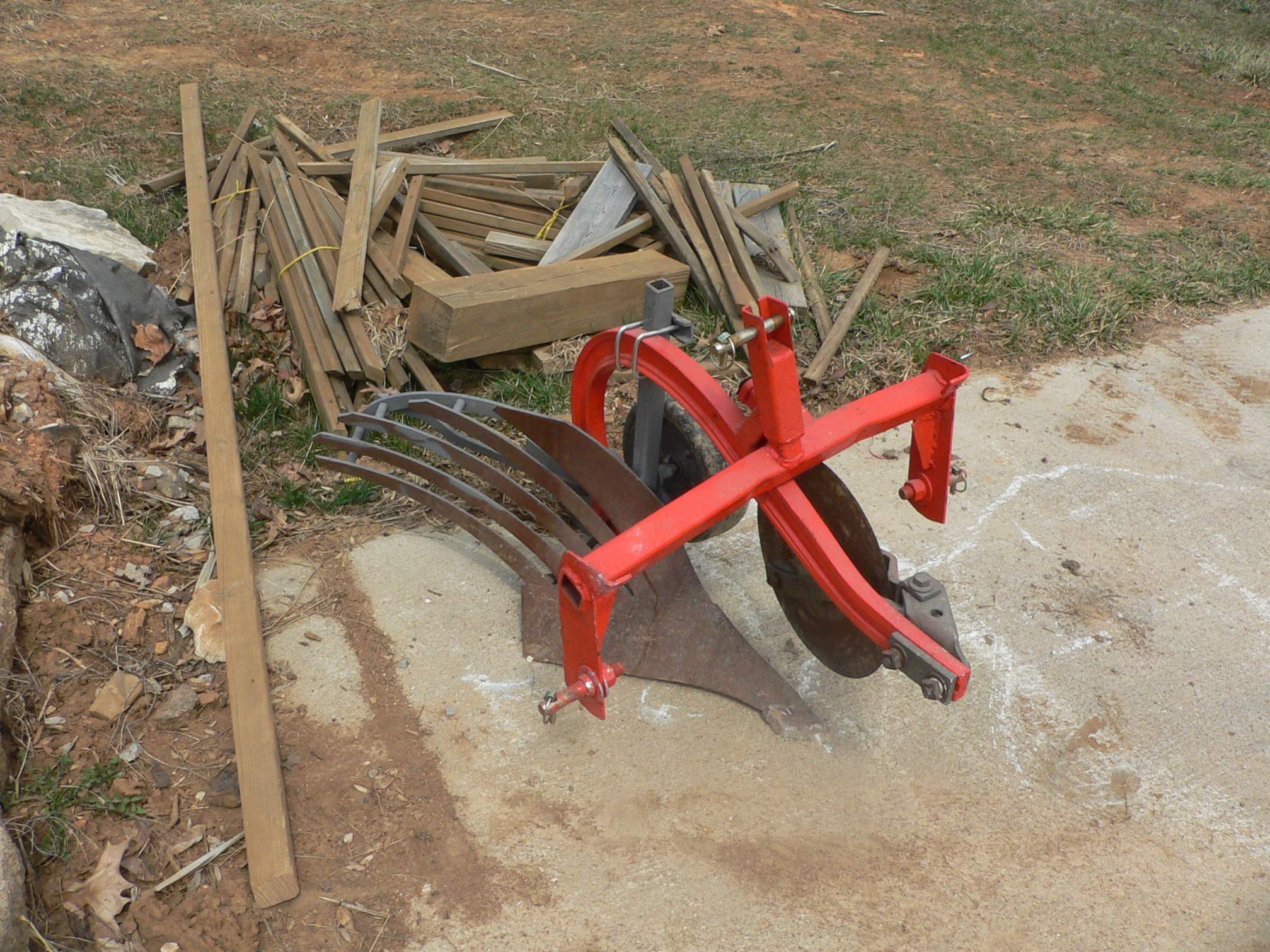

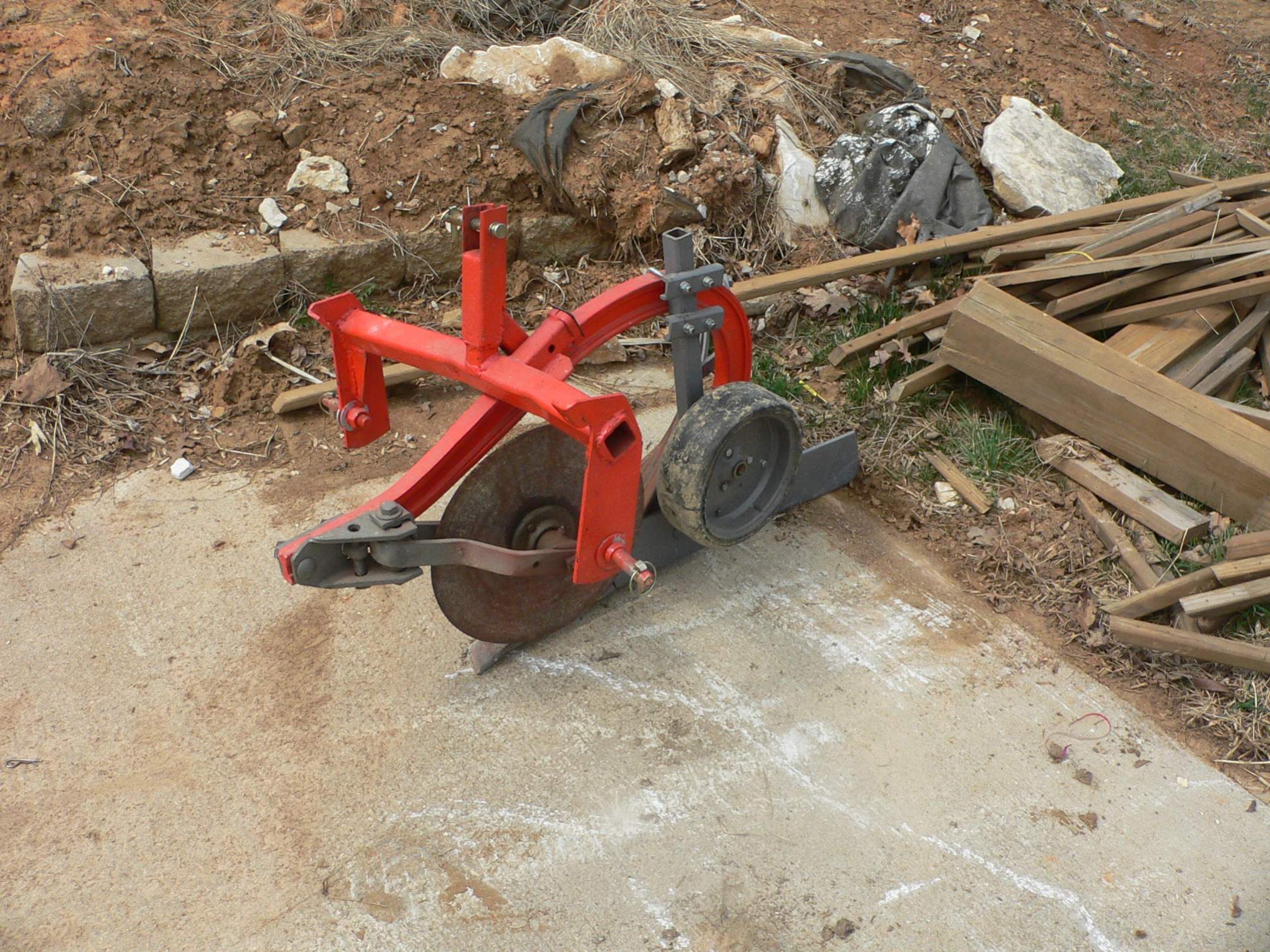

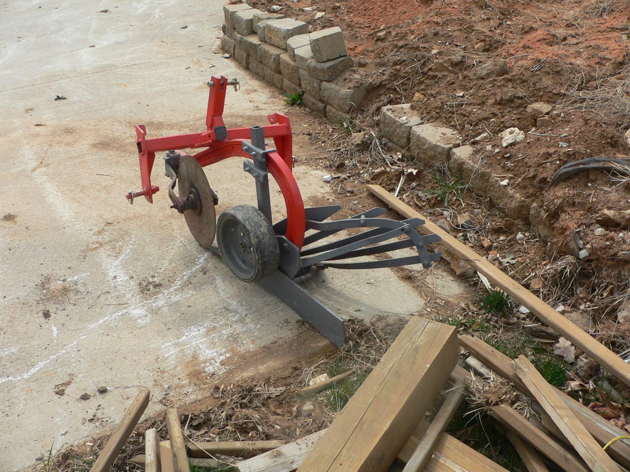

I've went to Barlows at least twice to buy a disc. Steve keeps asking me why I want it and twice he has told me it won't be very good for what I want to do with it so he has talked me out of buying it from him twice. I now have a single bottom plow that I bought/traded Milkman out of and I may try using it this year to see what it will do and then use my tiller.

I don't believe a lightweight middle buster or moldboard plow will work well in that hard clay, I know it won't in mine. We do use a moldboard plow, but it is a heavy three bottom, with the BX, we use a tiller. Even with the tiller, it takes a while to chew down into it. Last year, I ran my L5030 with bb and scarifies down before tilling to break it up.
