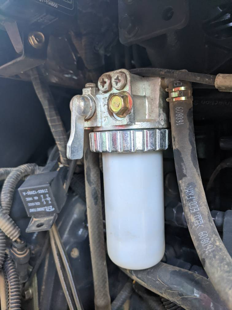

I would be afraid of the screwdriver slipping and possibly damaging something. I have a large pair of channel locks that I would try first.
It is such a light tap that even when it slips off it does not hurt a thing. I use that technique on many things that is in a tight spot. On the tractor in the video it would take 30 minutes or more to disassemble enough stuff to use pliers.

A larger 16“ pipe wrench will fit over the hose and give enough grip on the ring to remove it. Smaller Chanel locks should fit inside of the hoses. Larger ones should fit over the hoses. The screw driver or punch method will also work well. Strap wrenches will also work. The retaining ring really does not need protection from wrenches!

It looks so nice and easy until you realize the two rubber lines run right down the ring making spanner or channel lock fit nicely. How'd you make out?

I'm guessing the textured ring is unscrewed - is there a tool for this or do I just grab it with some channel-lock pliers?View attachment 712437
Channel locks 1/4 turn counter clockwise. Loosen by hand from there. The cup will likely stick in the housing because the o ring is old and compressed. Don't forget new o ring when reinstalling. Leave the aluminum ring a little loose and turn ignition to prime fuel through the cup. The you can probably hand tighten
