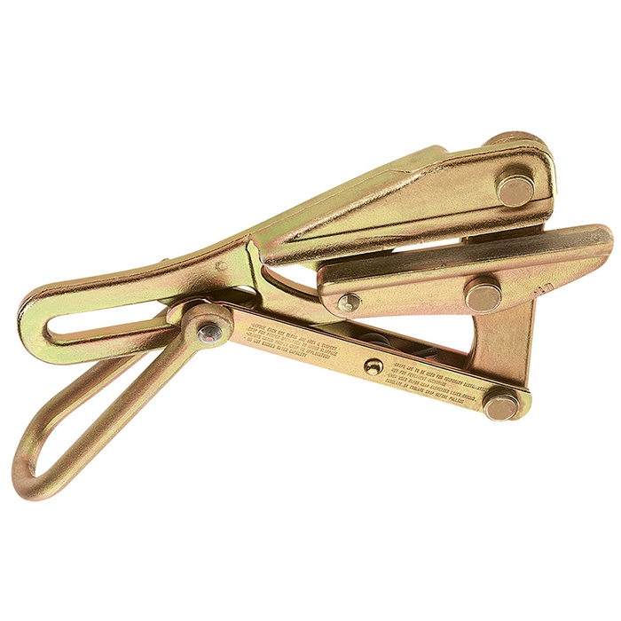

Well it turns out, one of the wires I see 10' down in the casing is the end of the steel retrieval cable. It was the clamp that attached the cable to the casing that rotted off. The cable itself appears to be 1/4" galvanized steel and looks to be in pretty good shape. I should be able to grab it but it likely won't be long enough to clear the top of the casing. I would have to hold it taught and try to get a come along clamp on it:
It should make it easier for the pro's but just another tool I'll have to get. The consensus of posters seem to think it would be best to let the pro's handle it. So far, I'm inclined to agree.
