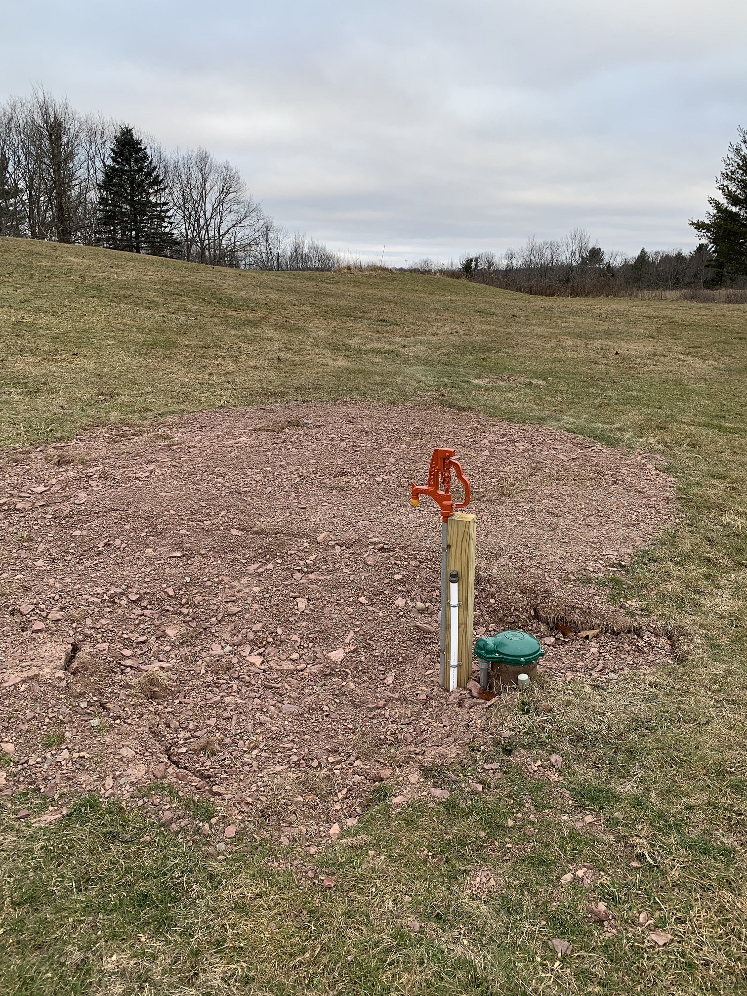

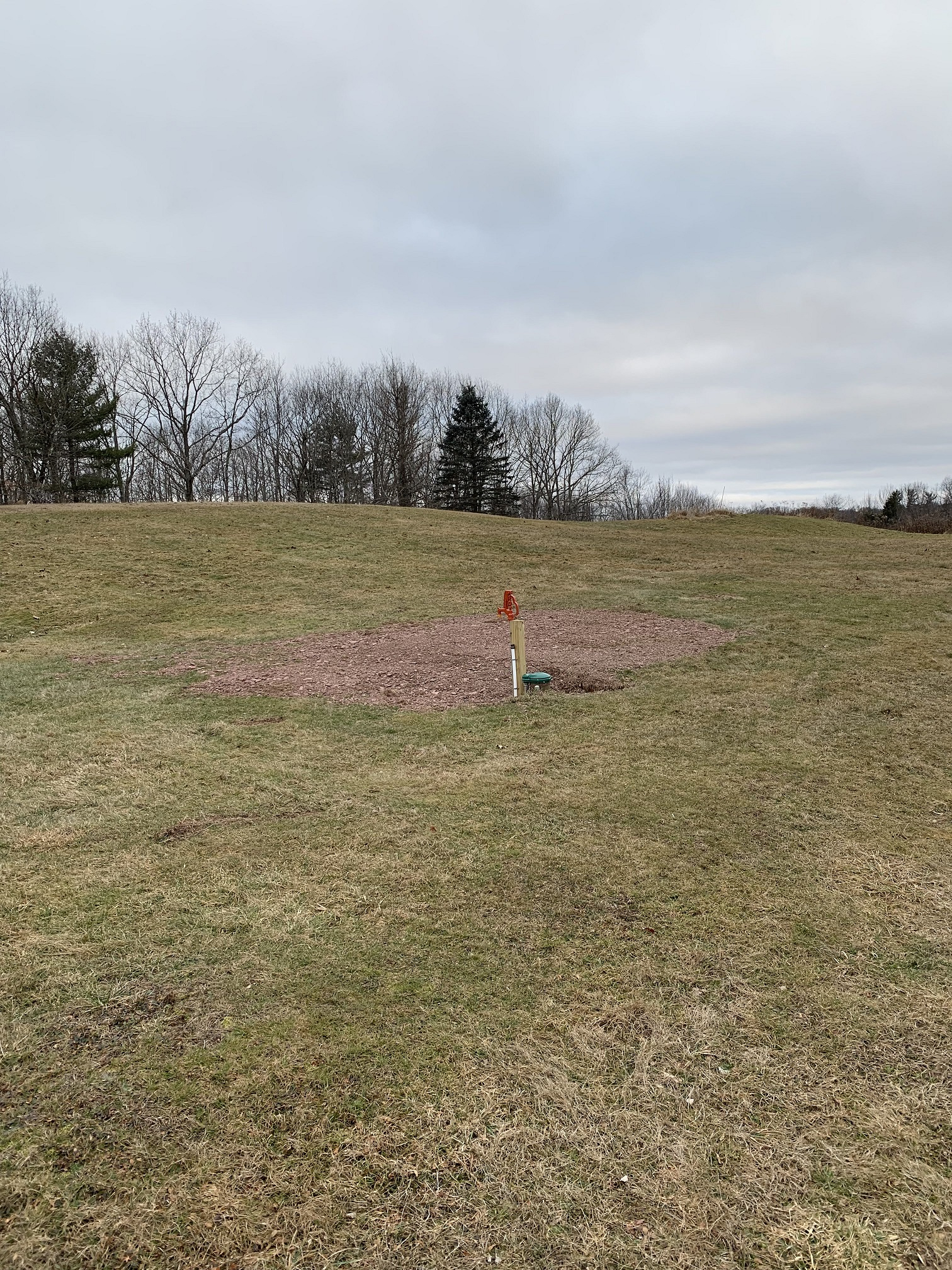

The excavation's been backfilled for a few months now. I'm waiting for spring to regrade and spread some seed.
I also installed a hydrant at the well head for easier access to water in the field.
View attachment 779161 View attachment 779162
Not sure what to do with the 21 lengths of 1 1/4" treaded PVC pipe though. I'll try selling the brass couplers or scrap them if there are no takers. Otherwise, the old pump and pipe will likely wind up in the dumpster.
Thanks again to all who offered ideas & moral support!
AWESOME! Really happy to know you got it all fixed. That hydrant next to the well is a great idea!
Yep, I asked for one when they installed my well. I also asked for a 110 outlet there. That has gotten quit a bit of use.

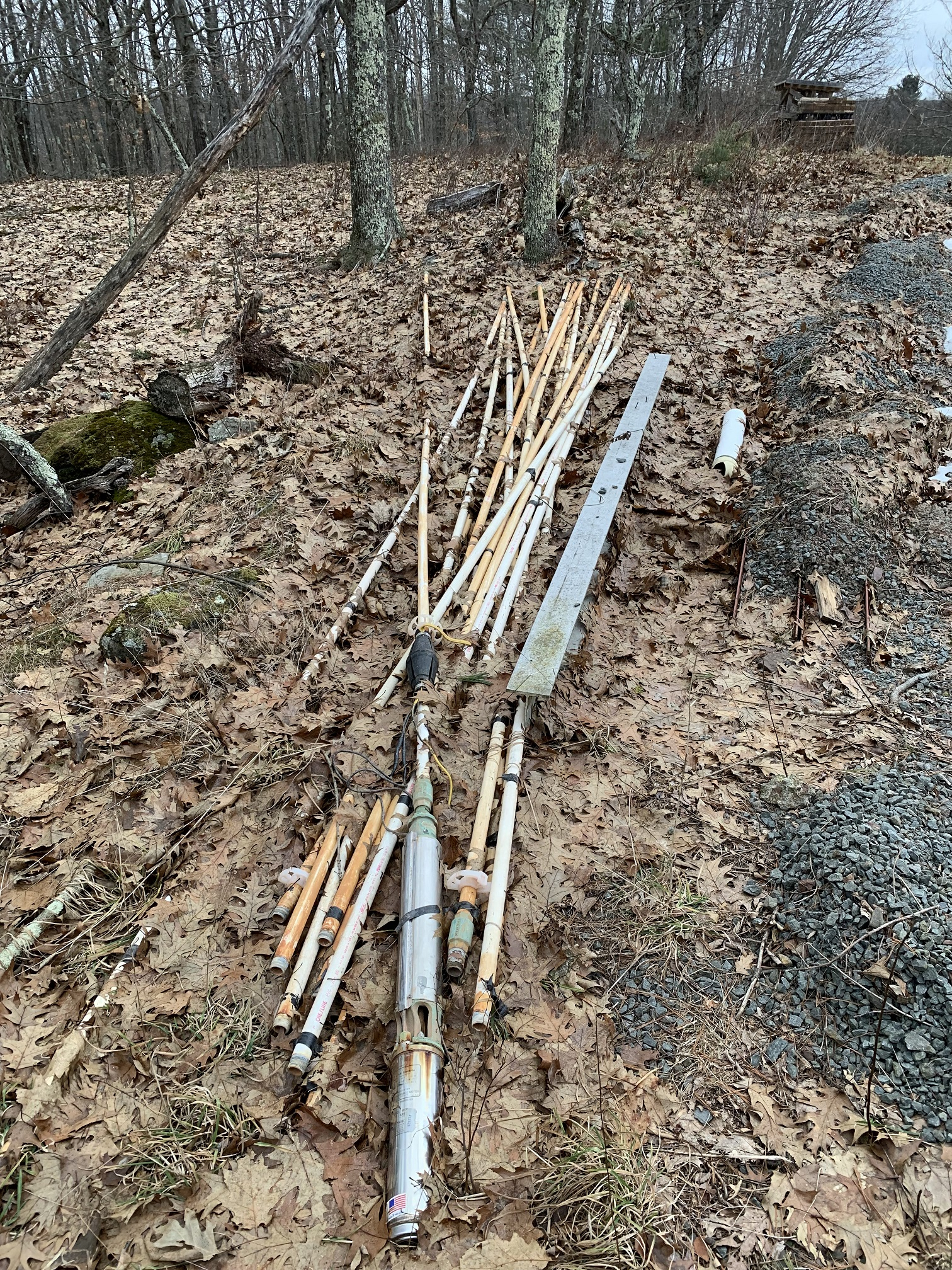

The snow has melted off here, exposing the 21 - 20' lengths of 1 1/4" PVC pipe pulled from the well. Any suggestions on what to do with them? The old pump is going in the dumpster but, considering the cost of PVC lately, I hate to chuck the pipe as well. Our local recycling center won't take PVC so that isn't an option
I sometimes use PVC pipe to make racks & shelving frames but this pipe appears to be an odd size that won't fit standard PVC fittings. The ends are threaded but won't help if the pipe is cut. I'm also not sure if ordinary PVC cement will work.
I suppose they could be used as conduit or an underground water line but I have no projects going that require it.
Any ideas?

Put it out by the street with a sign $5.00 per length. It will be gone by morning.

It might be heavier duty than the standard SCH 40 or 80 pipe, e.g. 120. Probably worth keeping, but it needs to be out of sunlight for longevity.
All the best, Peter
