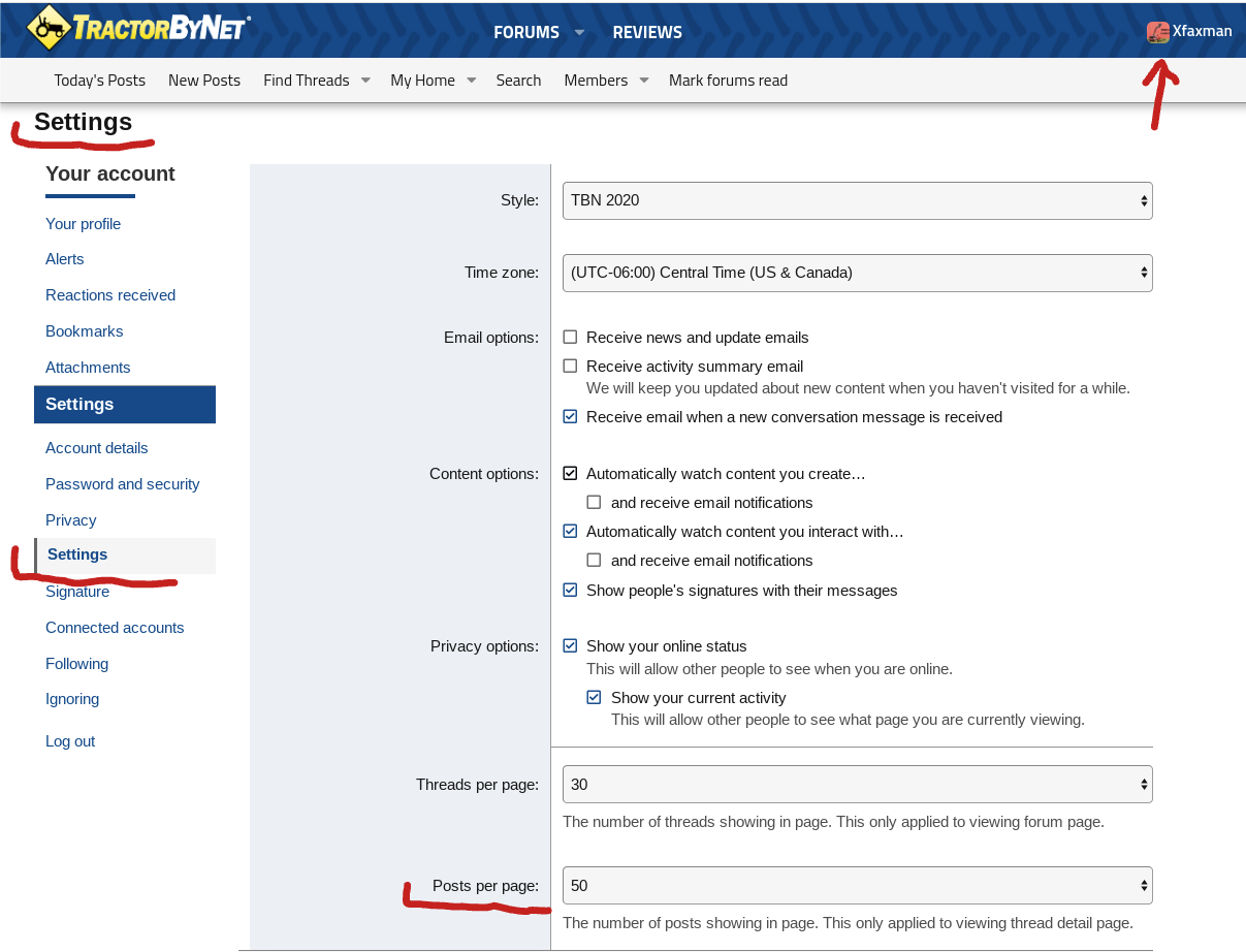

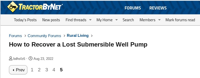

So, with 22 pages tallied up, that i didn`t want to read thru, did the OP ever get his pump problem fixed?
   / How to Recover a Lost Submersible Well Pump #214
Only 5 pages on the app.

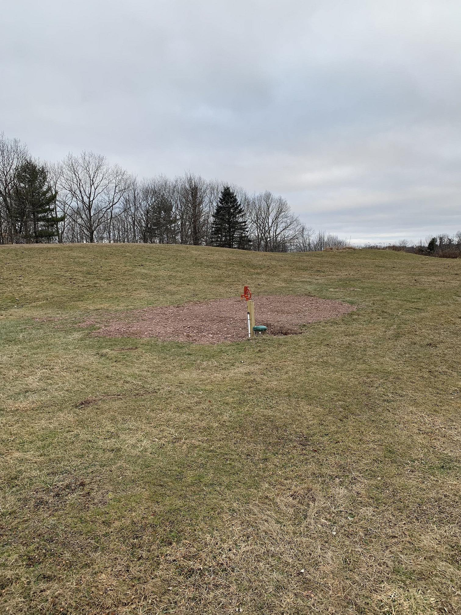

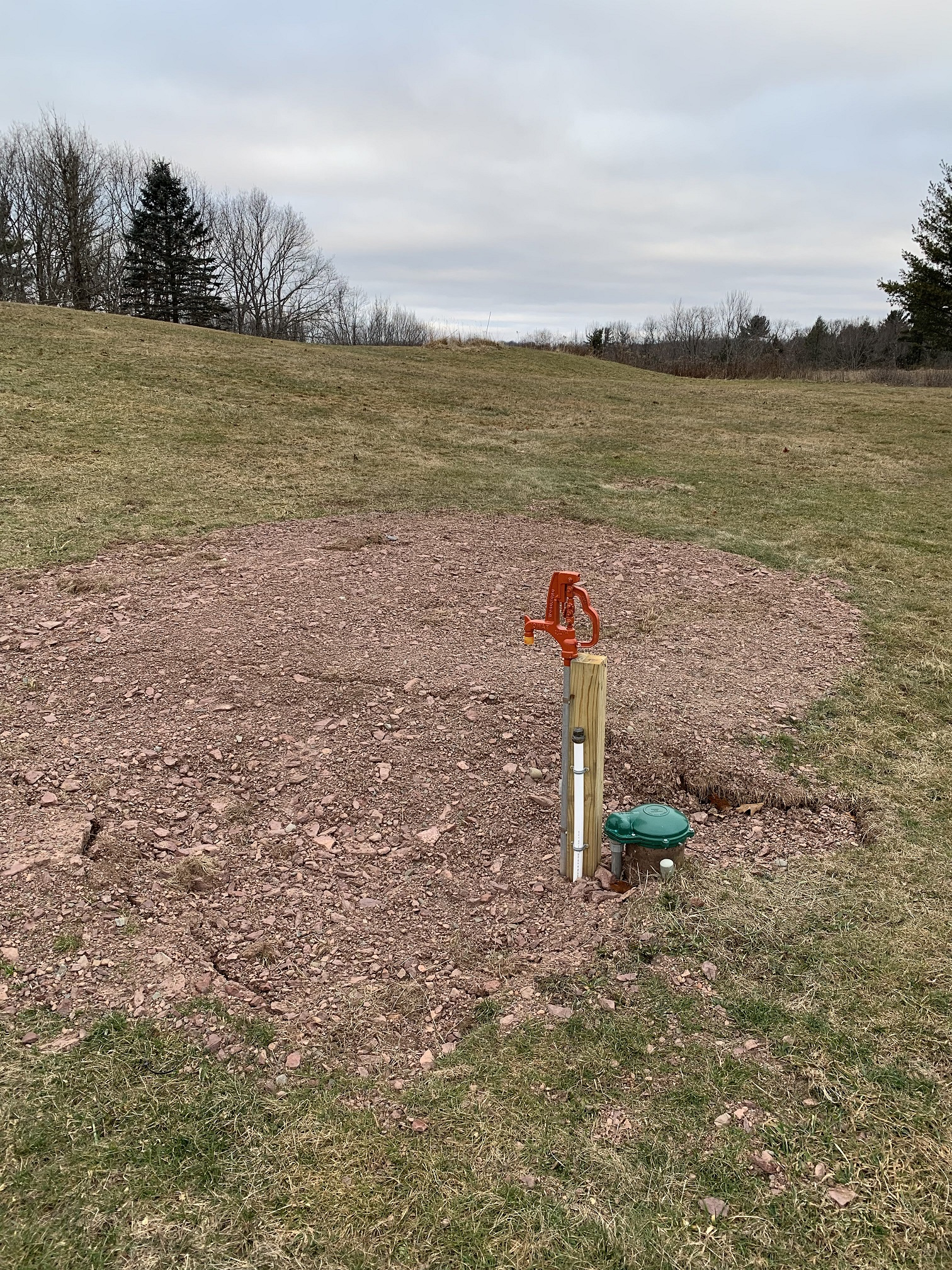

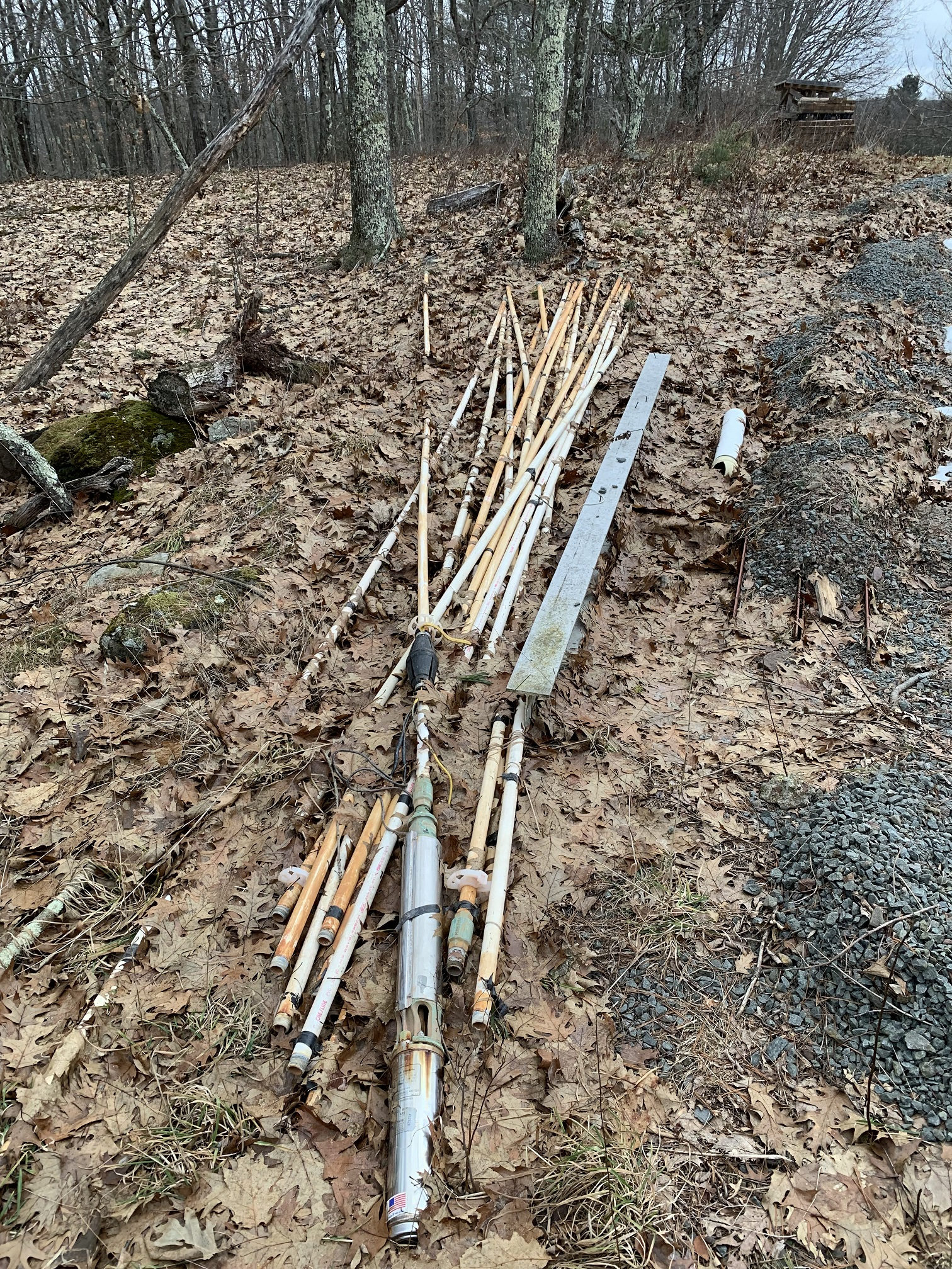

Yes!
See post #126 on page 13 and post #144 or page 15.
Thanks for asking!
The excavation's been backfilled for a few months now. I'm waiting for spring to regrade and spread some seed.
I also installed a hydrant at the well head for easier access to water in the field.
Not sure what to do with the 21 lengths of 1 1/4" treaded PVC pipe though. I'll try selling the brass couplers or scrap them if there are no takers. Otherwise, the old pump and pipe will likely wind up in the dumpster.
Thanks again to all who offered ideas & moral support!
