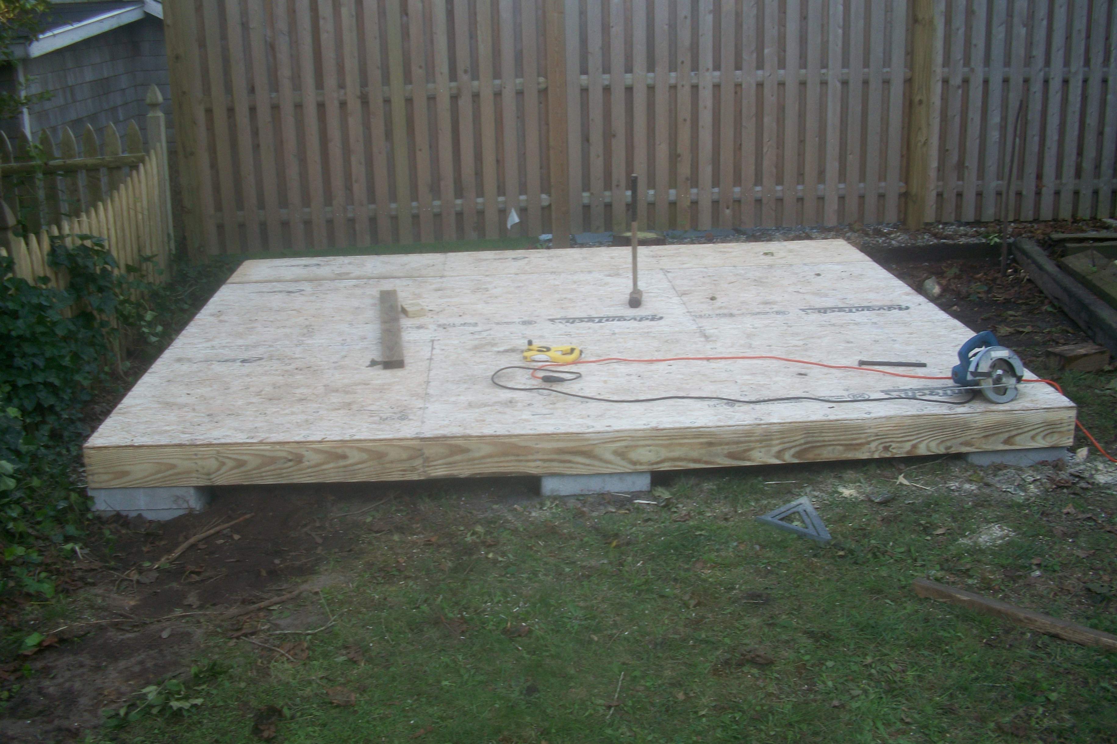

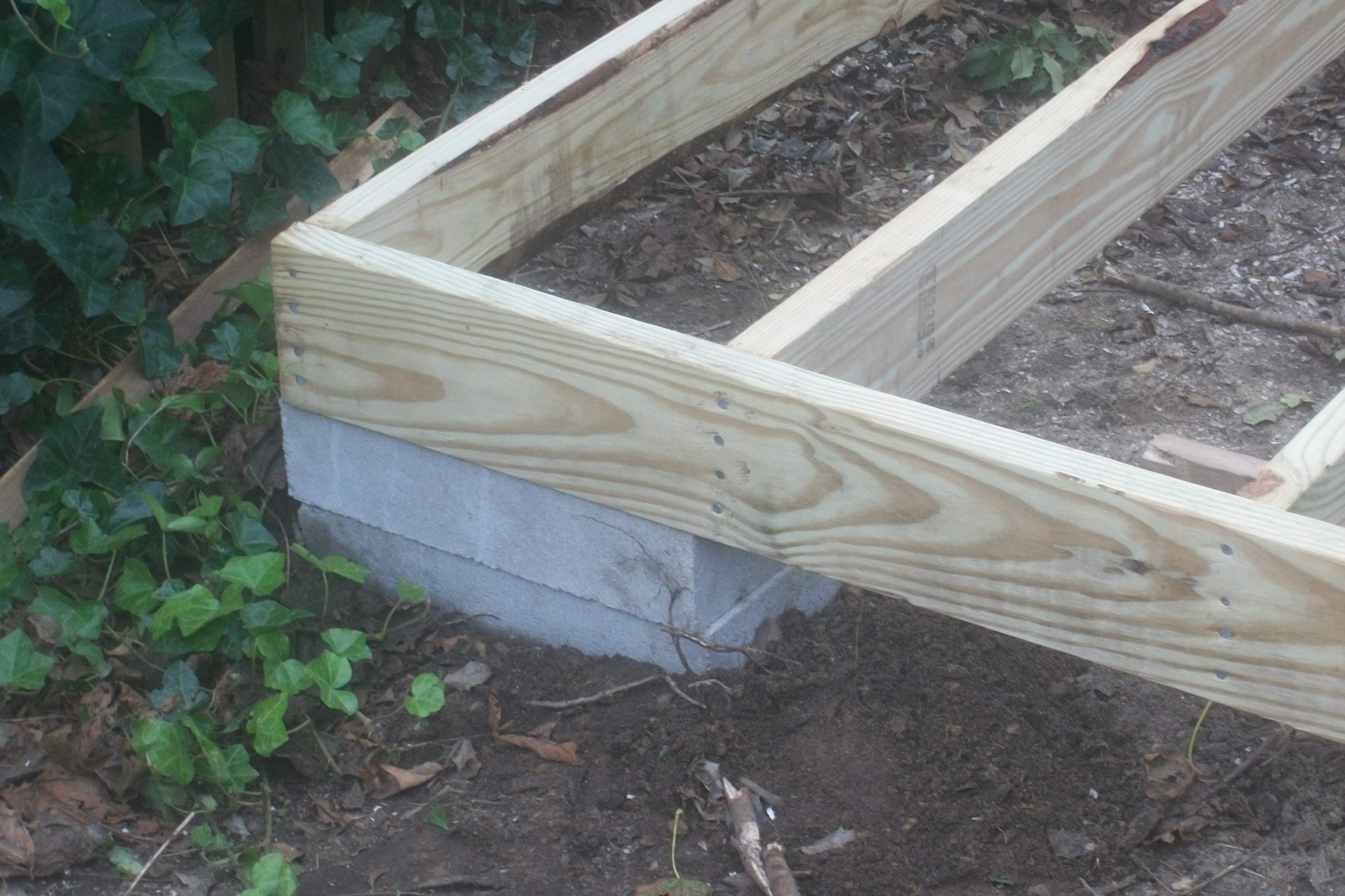

/ How to read a Span Table??? #36
Here are pix of what I did today. this is a 10 x 12 saltbox roof storage shed.
