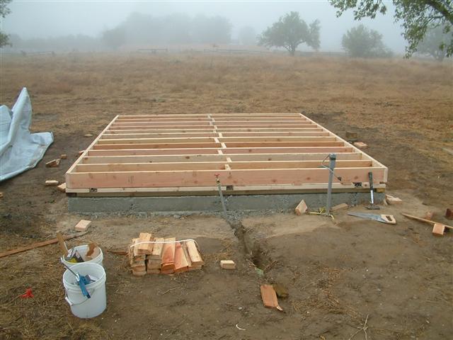

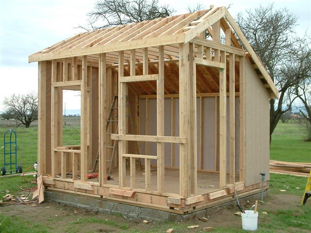

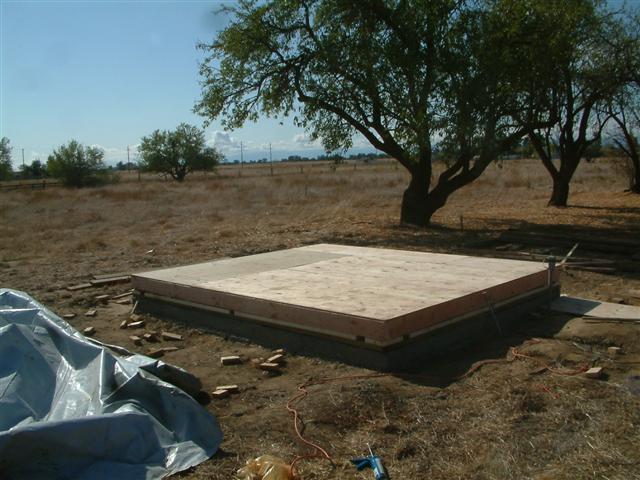

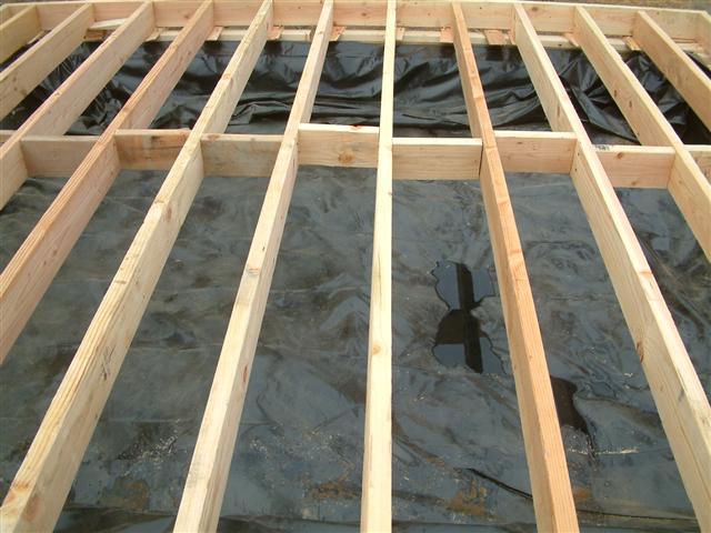

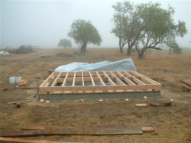

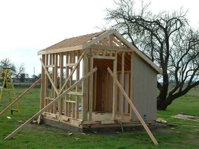

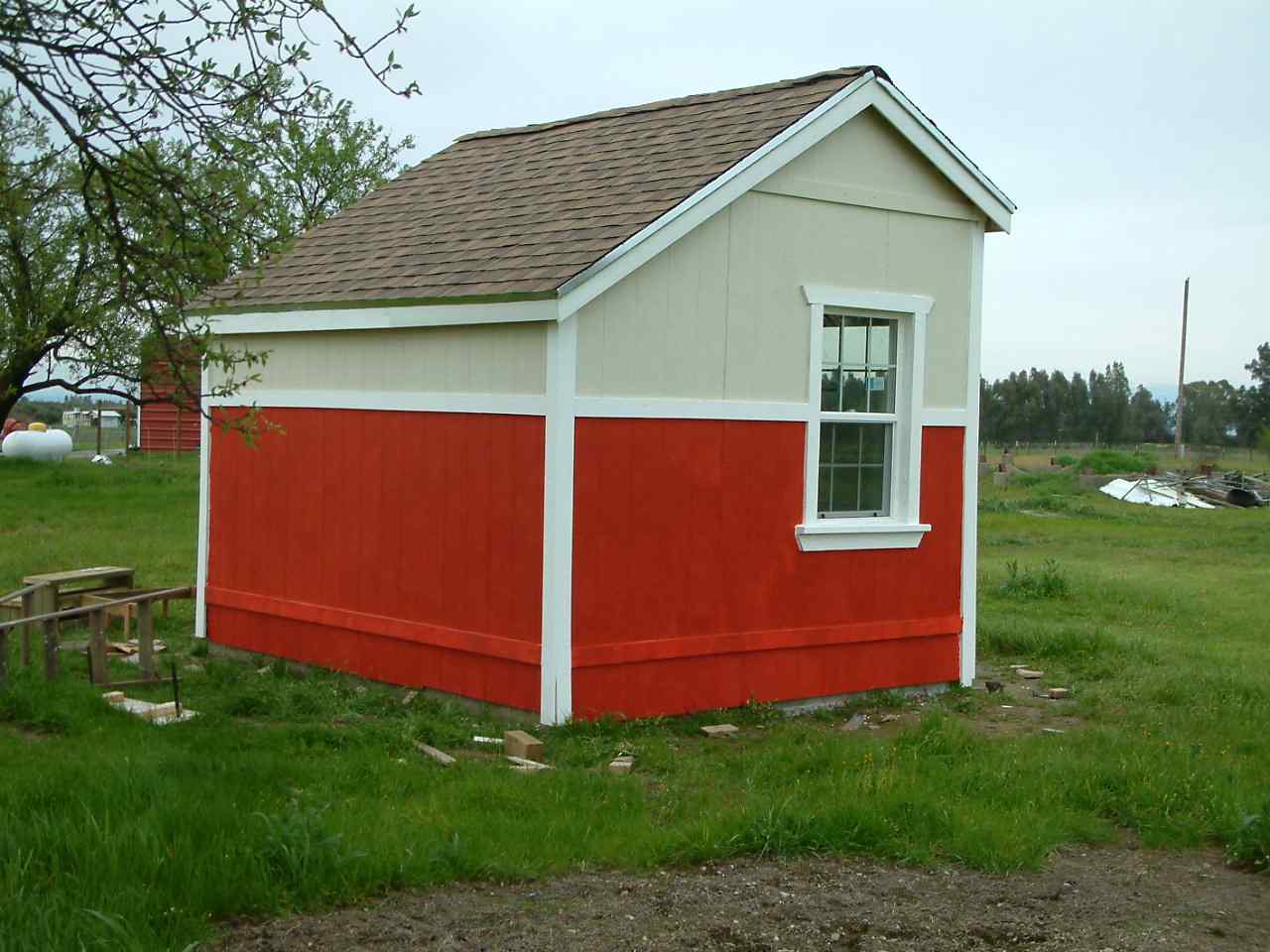

Here's some info on the 10x12 ft saltbox shed I built a few years ago. It's just a storage shed for garden tools and miscellaneous stuff--not a lot of heavy stuff. Used 2x10s on 12" centers to span 10 ft. Concrete perimeter footing 12" wide x 18" deep with about 6" exposure above ground. 2x6 PT sill plate held to the footing with embedded 1/2" dia anchor bolts. 3/4" plywood flooring. For heavy loads like you have, I'd add another footing at the middle of the joists for support.
DSCF0035 (Small).JPGDSCF0037 (Small).JPGDSCF0044 (Small).JPGDSCF0053 (Small).JPG

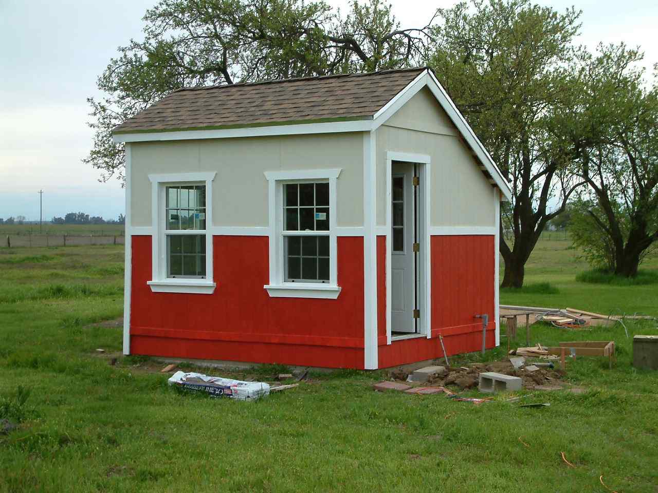

Here's the finished product.
DSCF0070 (Small).JPGDSCF0076 (Small).JPGDSCF0018-small.jpgDSCF0020-small.jpg
Hope this helps.
Good luck.

/ How to read a Span Table???
Hope this helps.
Good luck.
That is cute! Full on concrete foundation, wow! :thumbsup:
David

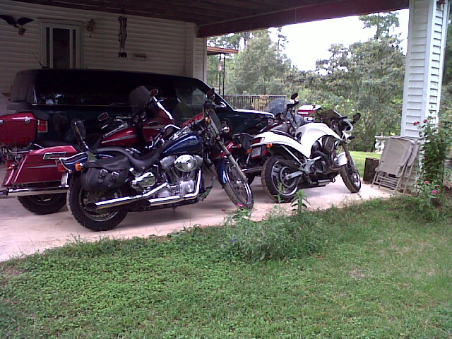

#4 - I currently have a non-level pad in th carport, complete with a giant crack and a low spot that becomes my 4th pond every time it rains... I do not want to repeat that on this shed.
