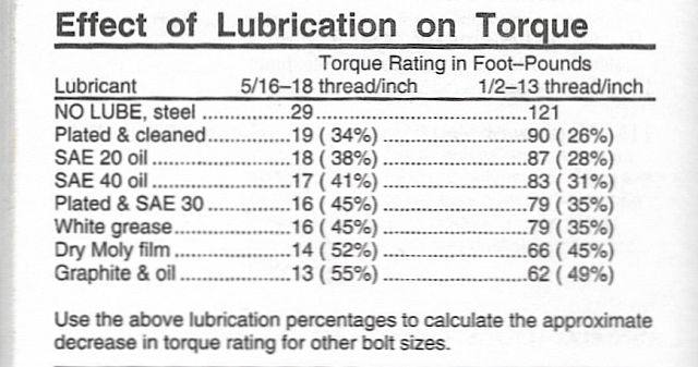

Do we want to open the discussion on lubricated vs non lubricated surfaces and threads? 🤣
Its actually very important, 450 lubed is 600 to 650 dry. Buy an impact gun that does max 700 and let it rip.
   / How the heck do you guys torque a cylinder nut to 600 ft lb? Rebuilding Bobcat combo bucket cylinder. #55
Do you really want to open up that can of worms....
