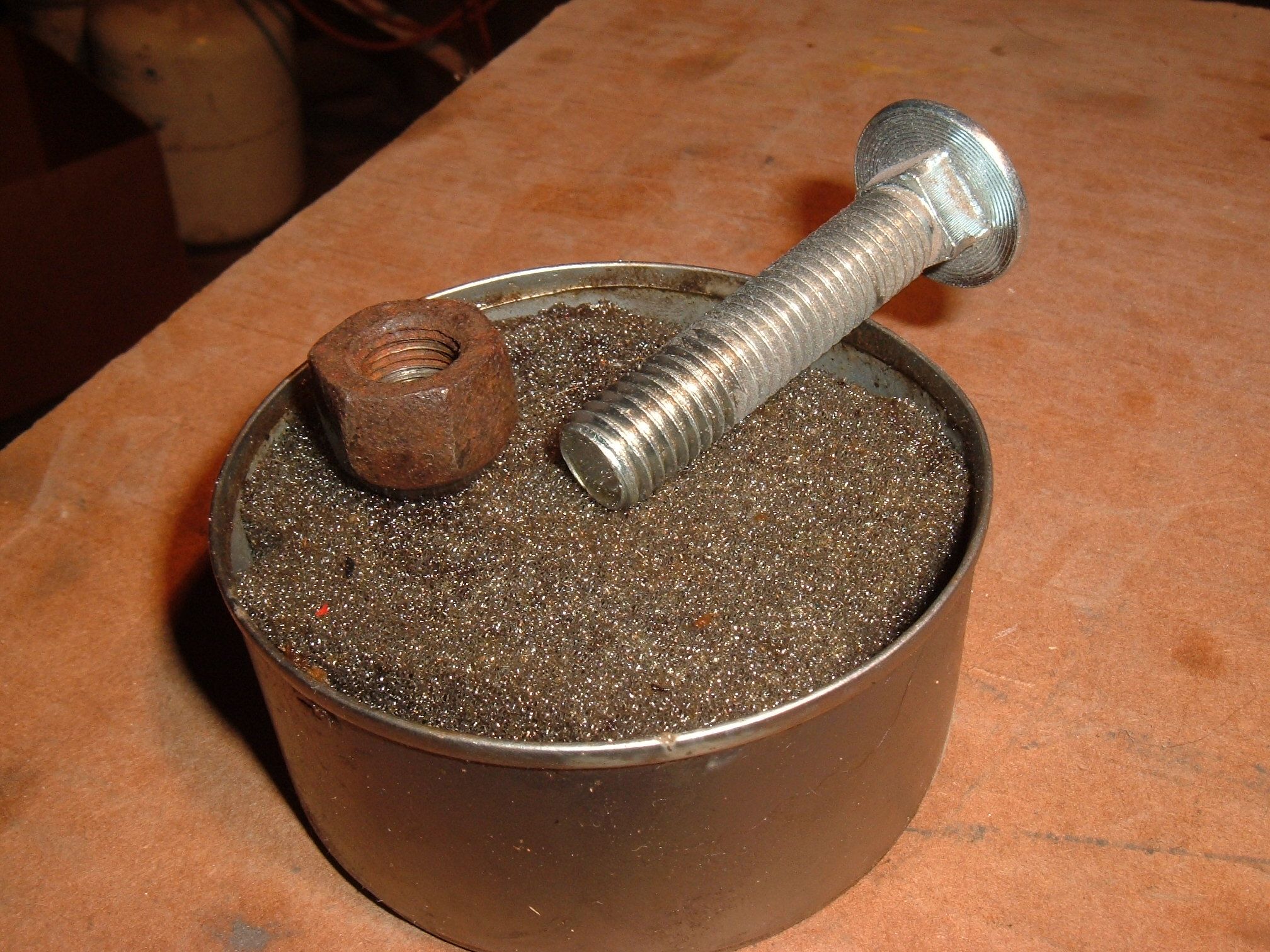

When a bolt is dry one never knows why it stopped turning, friction, pressure etc. John Deere has a tech book worth reading over this, a ;lot to consider but we spray every bolt we install, eliminated loosening and seized problems. Secondly,,, one of the m,ain reasons they went to dry,,, this is rather new actually,,, but is the advent of aluminum wheels, same for the torque wrench on them. Oil on the faces of them allow the nut to act as a wedge and fugg up the hole. They really get tight and impact makes it worse. Its not loose is the problem byut too tight and they are stuck, ruins the wheels.

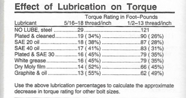

Ok lets try that again. Not only what Bobcat or Deere thinks. Rather, in general:
When thread locker is applied to clean dry threads, and looking at a chart of recommended torque for specific bolt sizes - which row in the chart below applies?
librication-jpg.707382

Maybe a little reading....
Thank you! That is a must-read.
For anyone who just wants to see a half-vast summary of the article:
Chris Manger of Loctite Western Australia ... results of the Loctite testing clearly confirmed that different brands and types of thread-lockers provide very very different amounts of preload/stretch when the bolt is tightened
Some (Many) thread-lockers simply act as an unreliable and non-predictable lubricant and most provide unpredictable, non-constant preloads. ... can and will result in excessive preload resulting in broken bolts if you actually tighten them to the required torque
...we were advised that the Loctite range of Thread-Lockers are designed to simulate as close as possible to a dry bolt torque condition.
and:
  • Zinc plated bolts require 40% more torque than Black (Unplated) bolts
  • Cad Plated bolts require 25% less torque than a Black (Unplated) bolt.
It's well worth it to read the entire article. Again, thanks.
