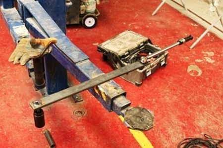

150 lbs on a 4' bar. Really not that difficult if you have a 3/4 drive socket set.
This is an application where you don't have to be dead nuts accurate. RickB's method will be fine.
I needed to set the bearing preload on the steering head bearings on a motorcycle. This required a spanner wrench which I had, but no way to use a torque wrench with it. So, I measured from the centerline of the spanner 6" and ground a groove. This held the hook of my fish scale. A pull of 3 lbs on the fish scale yielded the required 18 inch pounds of torque.
A little ingenuity and math will get the job done in many cases.

I am putting new seals in and apparently I need to get the bottom nut to 600 ft lb. I do not have that kind of torque wrench. How do most people achieve this? Thanks.
The bush hog nuts are "torqued" at 450 ft lb. I just use a guesstimated 80 # push on a 6 ft piece of pipe places over my 3/4 inch socket handle. A 600 ft lb value could be obtained with a 100 # estimated push. Don't think you have to be that accurate for these kinds of torques.

1.25 rod 2.5 bore. Thanks guys. Keep the ideas coming. I like the idea of maybe building something that I can put my torque wrench to. This way I can just use that in the future. I may be missing something, but then I don't have to stand on it. to stand on it, I have to position it in such a way. With the tool, I can bolt it to the bucket and just turn.

IF you don't want to use a "torque" multiplier", One can always make a torque wrench extension....
Example snatched from GOOGLE IMAGES (not my work)...
Suggest if you going to 600ft-lbs to go big on fabrication...
