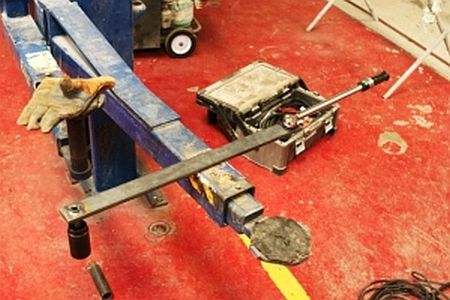

IF you don't want to use a "torque" multiplier", One can always make a torque wrench extension....
Example snatched from GOOGLE IMAGES (not my work)...
Suggest if you going to 600ft-lbs to go big on fabrication...
I'm amazed that this setup works but it apparently does. Seems like the torque wrench needs to be measuring "force" instead of "torque" applied to the outer end of the extension lever. I guess torque is the same as force in this case, I'm just not "seeing it".
