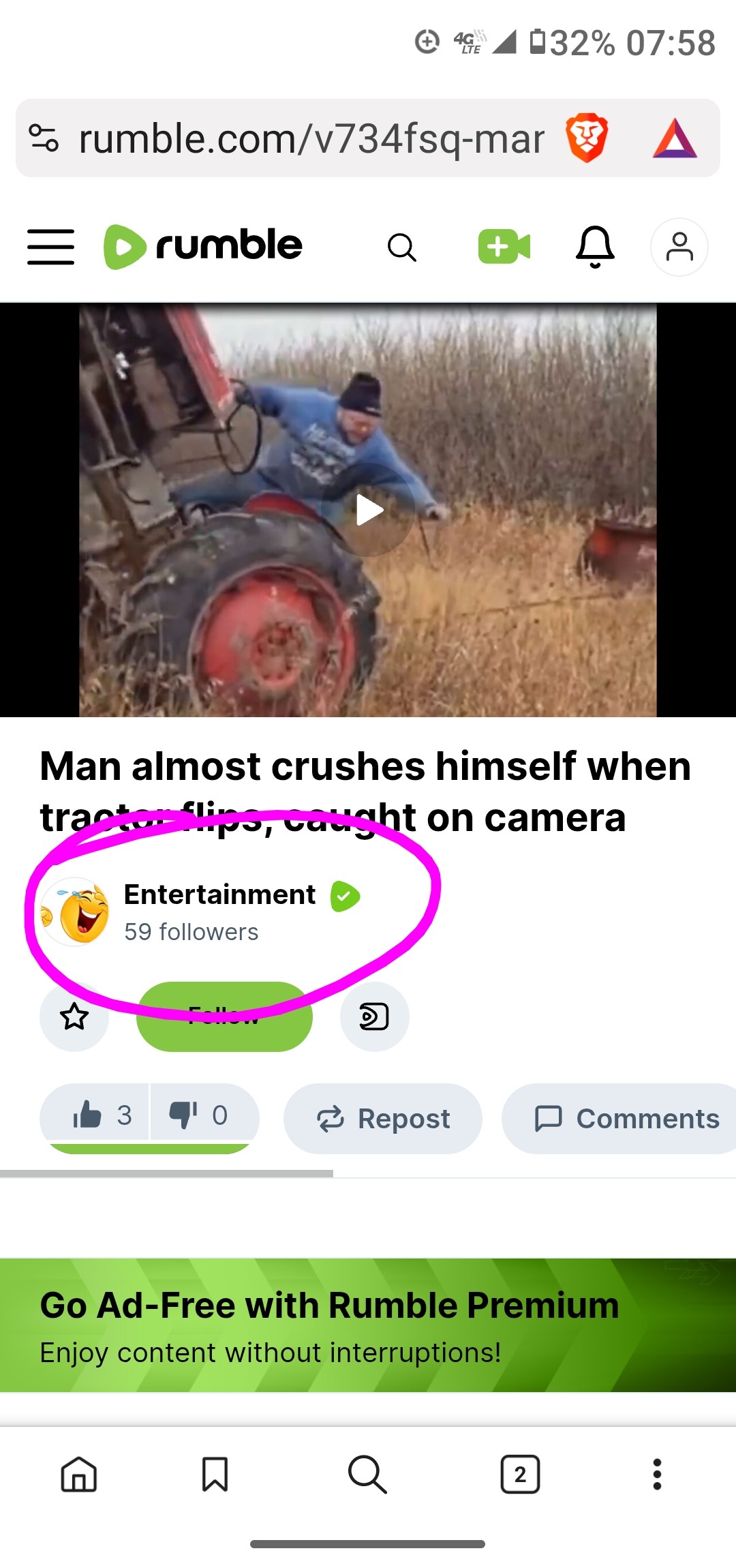

Or the engine stalled.
Watch the video again, turn up the volume, and listen.
The tractor engine dies well before the flip is complete.
I couldn't her the audio, to me it looked like the tire stopped rotating and the tractor started rotating, in the opposite direction mind you, at about the same speed that the tire was turning.
