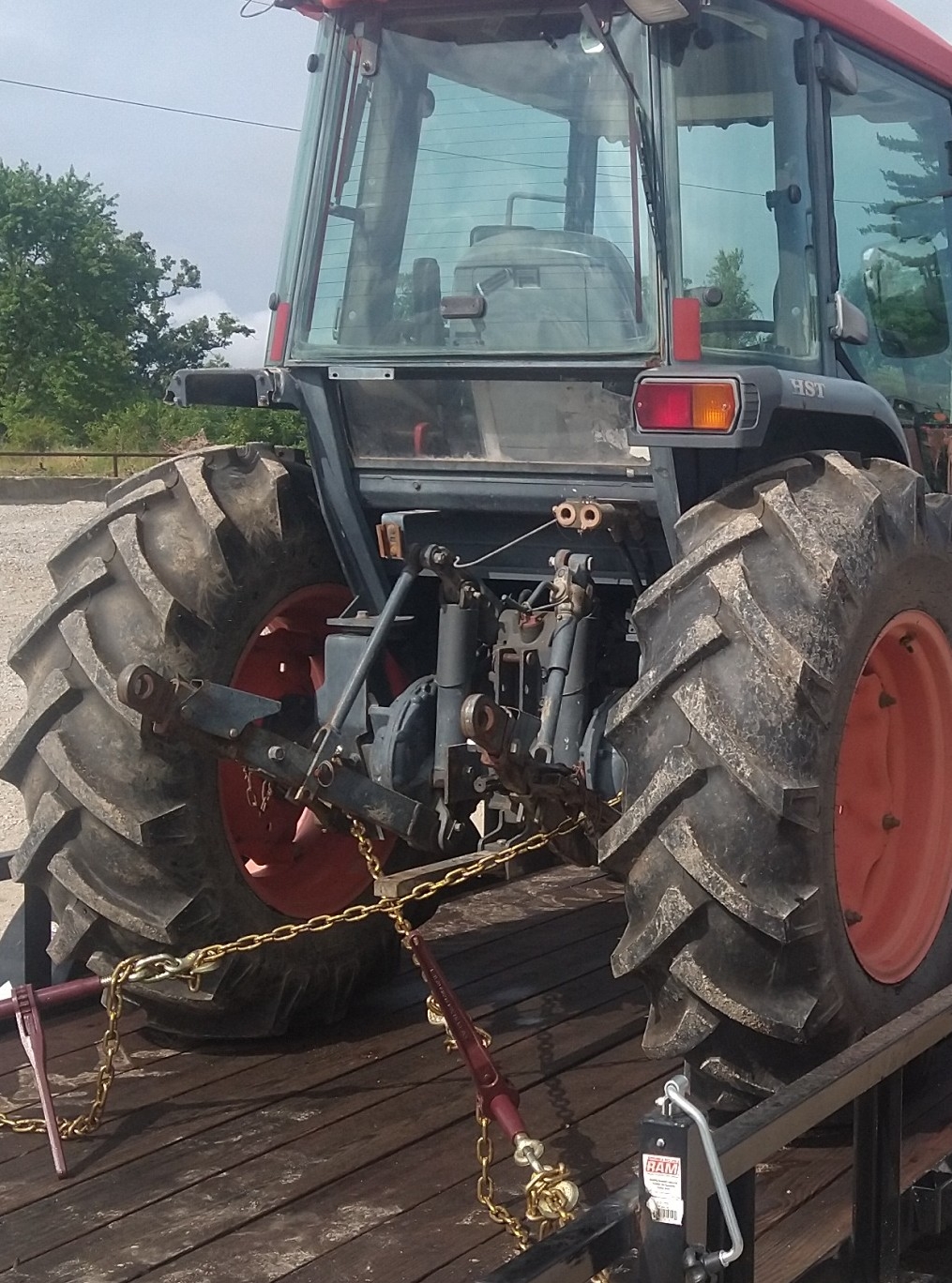

Front wheel Displacement on my 63 is Adj.. My Import Yanmar not so much. The Rear was easy the front doesn't give you many options. I had to reline the Org. Bridgestone Old and Dry cracks. Gempler had the full Nylon reline. While I had the tires off out of curiosity I checked them. The Disp. was closer than I thought. They was already swapped by the dealer so I never Knew. The fenders lined up Perf. and what they look like now with the wheel offset Swapped. The Disp. makes a huge difference. That was not the cause of Notorious rollover though.
