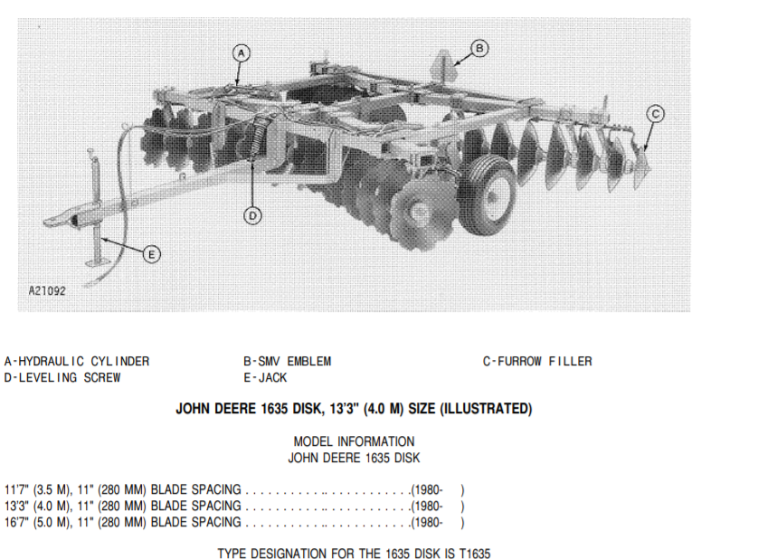

While I am occasionally surprised by 'exceptions' on T-B-N, few disc harrows with pans of diameter 16" - 18" - 20" - 22" are available outfitted with anything but notched pans front and rear. All these relatively light discs struggle to cut unplowed ground and only the notches make cutting through feasible. (( Dirt Dog and Monroe Tufline offer discs with notched pans in front, smooth pans in the back. ))
Discs with 9" spacing between pans penetrate better than discs with 7" or 7-1/2" disc spacing. Less important than notched vs un-notched, but a factor. Less "float" with 9" pan spacing.
When pan diameter increase to 24" - 26" - 28" - 30" there is enough weight to cut through almost any grass. You need a Utility Class tractor (6,000 pounds bare weight) to pull these.
May I ask what brand disk harrow has 28''-30'' disks???? Maybe a disk designed for building a road base for a highway such as a Rhome but I've not seen 28''-30'' disk for a farming/gardening disk harrow.
In reality the larger diameter disk requires more "structural weight" to penetrate soil due to larger disk circumference having more ground contact area than a 18'' disk.
Notched disk all other things equal such as soil moisture %, frame structural weight, gang angles & disk spacing will penetrate soil deeper due to less disk circumference area touching soil at any given time, Notched disk will also handle trashy conditions better than spherical disk.
I'm stating this from many yrs experience custom farming having plowed many acres of different type soils with different type/brand disk harrows plus having been employed by a equip dealer for over 21 yrs. Shown below is a plowing tandem that I've plowed many acres with a 11'7'' wide similar unit & 26'' disk is the maximum diameter that was available when it was new.

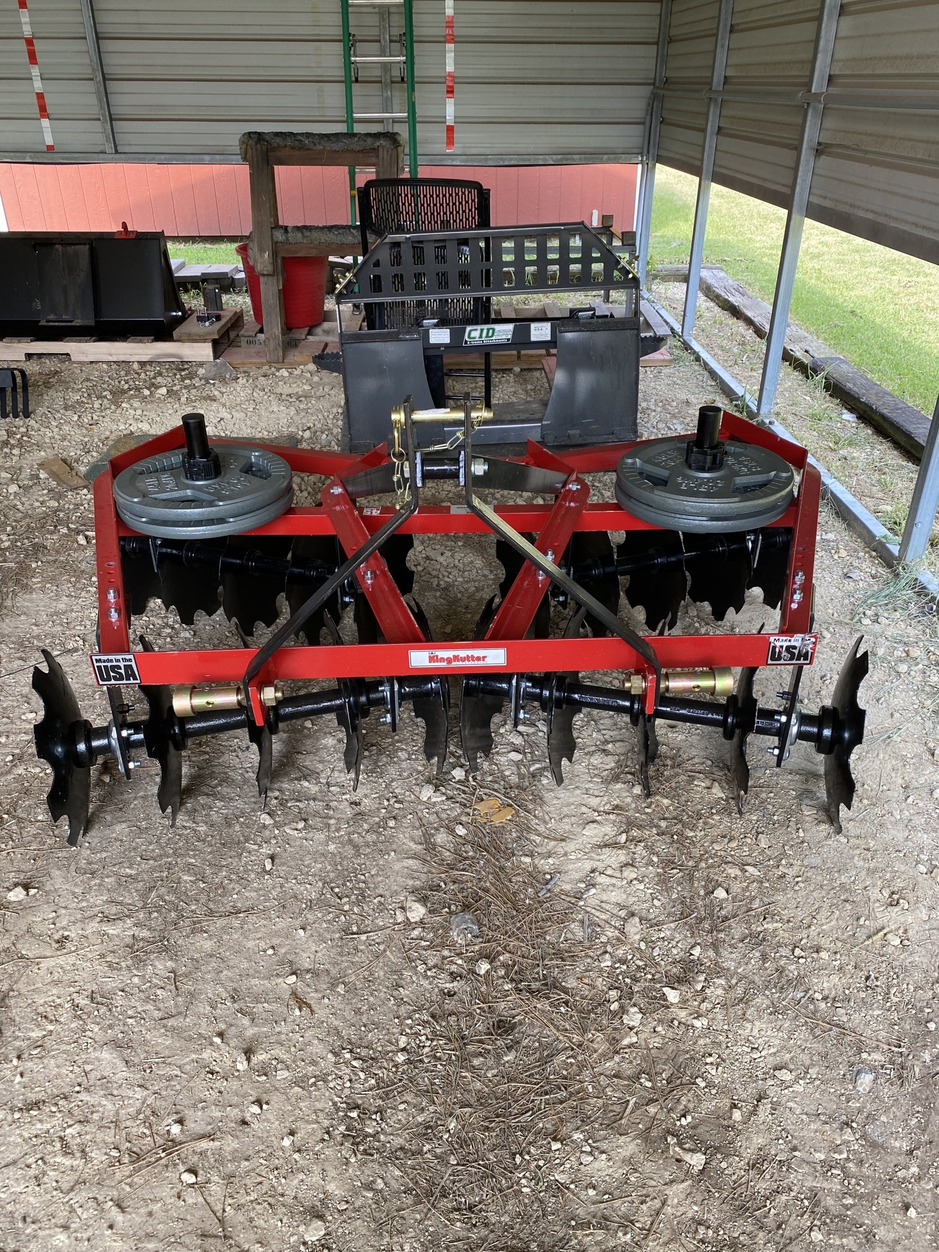

Amazon can be your friend with free shipping and all. Added 360 pounds to an angle iron disc harrow with 8ea. 45lb weight and two free weight wall hangers bolted to flat surface, center harrow (only 180 pound shown in pic). With free shipping, the cost was drastically reduced and weight can be adjusted as needed.
Harrow 560lbs as shipped, 360lbs weight added equals 46lbs per disc. Not optimal, but better than originally designed by KingKutter. Could probably add an another 90lbs to the stack(s) for 450lbs, but will see how this configuration works first.
