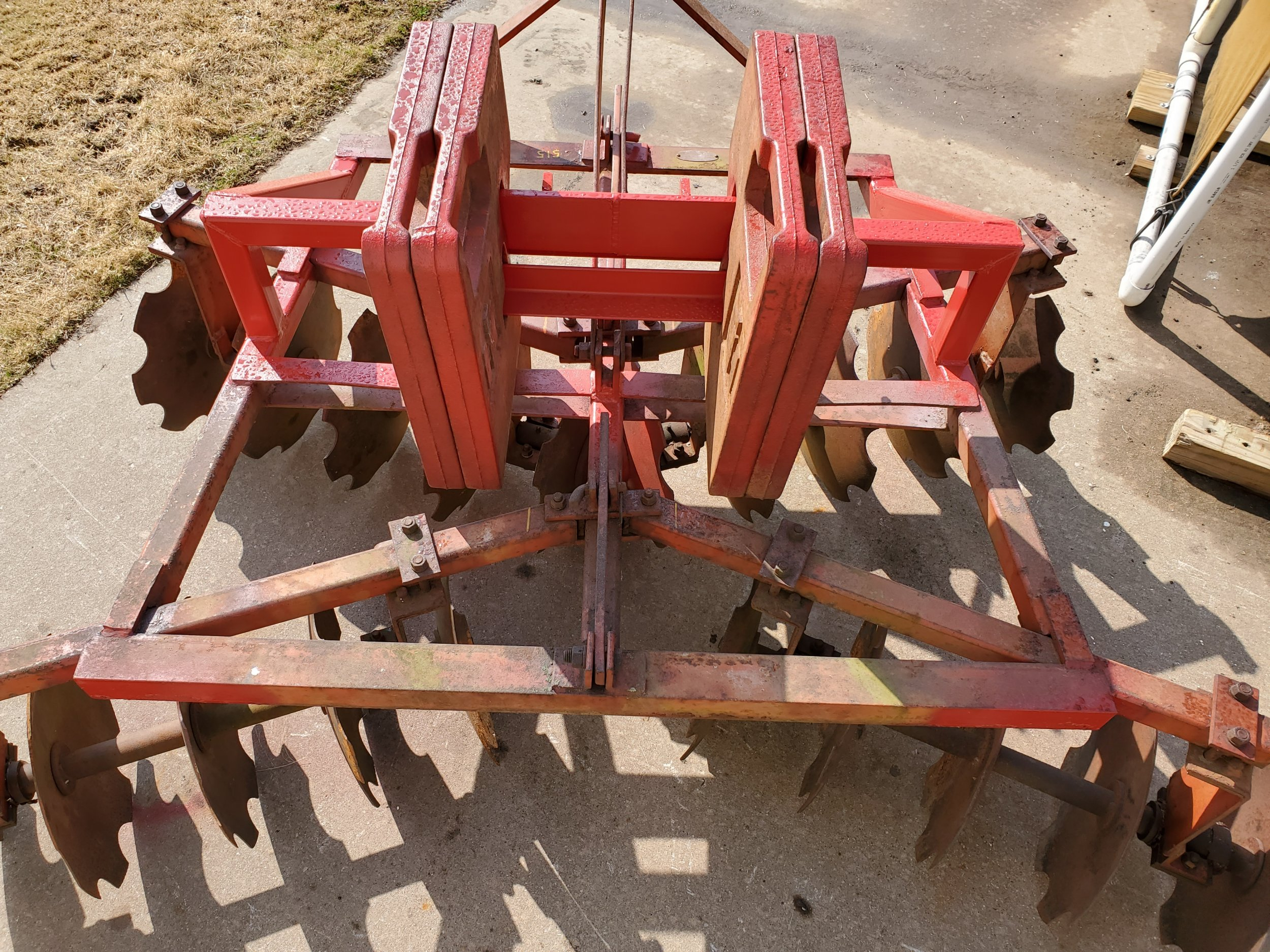

Almost every disk I ever saw under 8' wide had additional weight added on it so I decided to just do it right and not have to worry about it falling off or chains or straps breaking or rotting.
The Disc weighs 515lbs and I added 425lbs of weights.
I've only used it once for the food plot but it worked great chopping up most of what I brush hogged last summer. Having the hydraulic top link was a great help as I could level it perfectly on the fly or change the weight front to rear.
   / How much weight can be added to disc #13
I like the weight setup. You can mount them facing forward or rearward for a slight change in soil action.

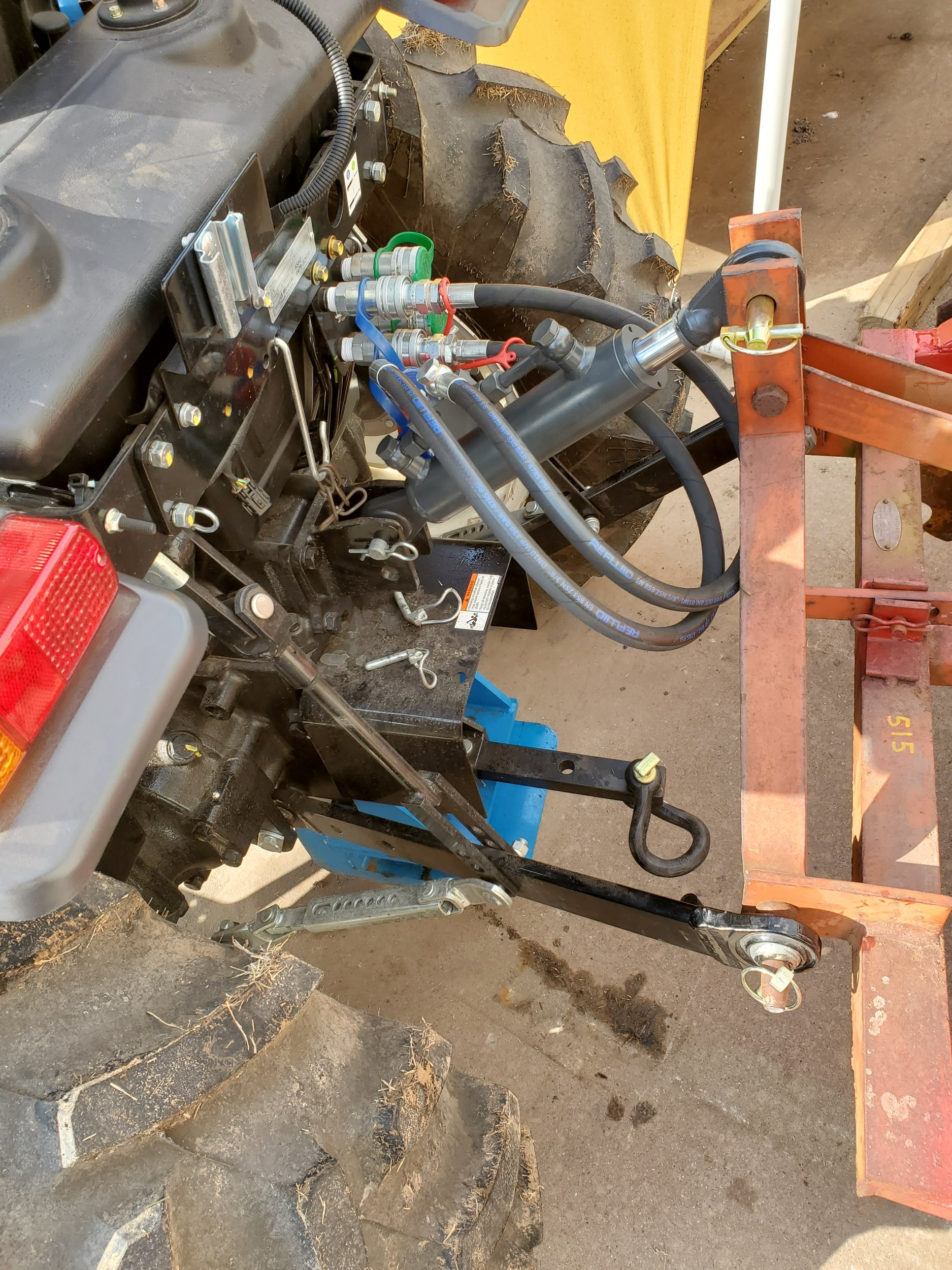

That is an awesome setup with the weight. Can't believe you was able to add so much. What size tractor do you pull that with? Hydraulic top link is new to me, you can control it up and down from a function? How much did that cost?
   / How much weight can be added to disc #19
I just added a hydraulic top link to my cat 2 tractor and my total cost with hoses and all was $400. I think on a smaller tractor it could be done for quite a bit less. I bought the components at agristore.
