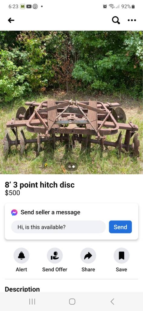

Only made it about half way through posts; but; why not an older, larger disc; remove outside most disc, and pay less money, have a heavier duty frame, and the option to add the outsides back on?
   / How much weight can be added to disc #32
For smoothing; attach a heavy chain, mattress springs, log, or rail road rail behind on the last pass. Not trying to talk you out of spending money, but there are a Lot of old 8-9 ft discs around from back when people farmed 40 acres with a MF165, and the impliments outlived the owner.

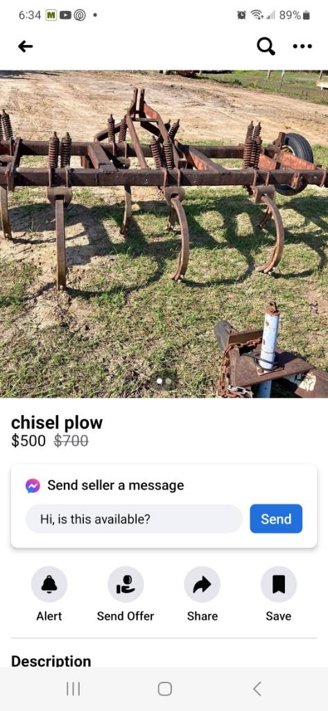

Another good option is a chisel plow, will break up some of the hard pan, and allow drainage; and can be followed with discs. Once again, we are dealing with a fairly low power machine, but you can remove some of the chisels, if your really bogging down.

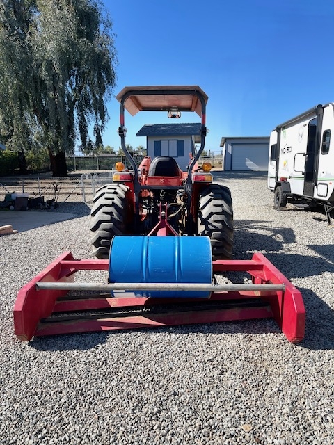

Read this thread. I have an old Towner 7x8 wheeled smooth disc. This is a drawbar attachment. The iron wheels were originally manually adjustable. I put a hydraulic cylinder on the machine so I can control depth from the tractor. I can also raise the whole thing off the ground for moving over roads or very tight turning.
Last year I put a 55 gallon barrel on it so I can add water weight. The barrel has the potential weight of 500 pounds but it is infinitely variable by volume.
This cut the near virgin field with 5ft tall mustard stalks quite well with the barrel 2/3 full (333#) and made the M5200 really work when fully engaged.
I put a water barrel on my land plane too which was not engaging to my liking. adding weight improved both of these attachments.
