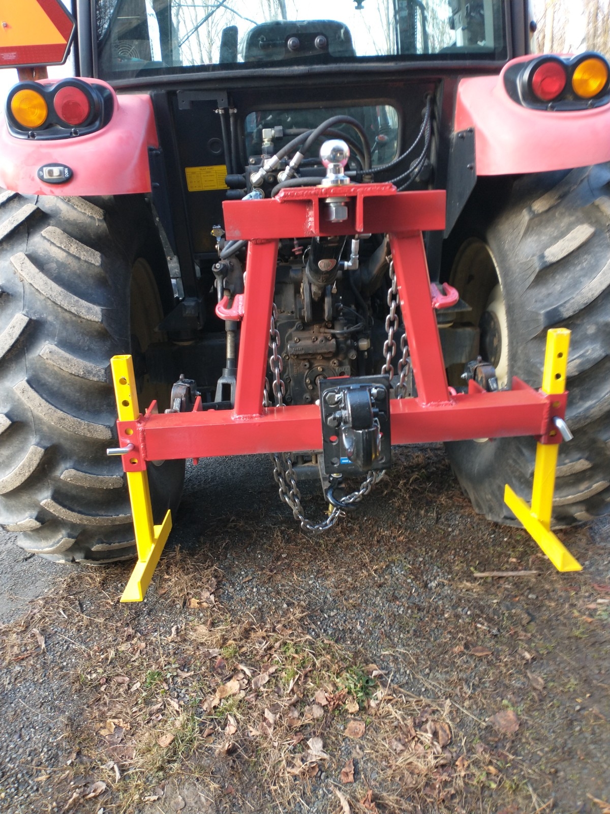

Don't apply to me at all simply because I use my modified rear hay spear with a GN ball welded on the top and the 3PH is always at full elevation when pulling the GN loaded. I rarely use the drawbar for pulling anything other than drawbar pulled implements like round balers and disc mowers. Even my Kuhn Gyro-rake is 3 point mounted which I much prefer because I can lift it at the end of a windrow and not leave a curved tail of forage that I have to 'chase' with the baler.
I like to keep my windrows straight always. Makes for easier round bailing.
I have used a considerable number and types of drawbar pulled implements over the time I've been operating a tractor, as well as some 3 point mounted implements and even a fair number of what are termed semi-mounted ( they just use the lift arms, and not the top link) plows and hydra-swing haybines being the most common for me.
I also move trailers and such around with a 3 point mounted hitch, actually have one over at the farm which is mainly used for the log trailer.
Now maybe YOUR Kubotas are different from every other tractor that I have been around that I worked with or on the 3 points because none of them had physical limiters to protect the tractor or implement from rising higher then designed too.
Best use I've had for a quick hitch.
Then my other 3 point to trailer hitch;
then this picture shows clearly the chain that I use to make sure that they don't rear up too high while being used or loaded,
as I have had them try and lift higher then the lift arms are powered up.

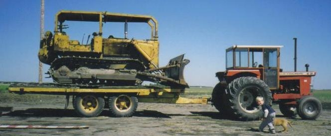

Seeing this picture got me thinking about some of the YouTube videos of tractors in less developed nations pulling heavy loads with extra guys hanging off the front and sides for ballast. I’m kinda thinking watching a little YouTube might reveal the answer to the OP’s question of how much his tractor can pull. Of course the final answer using this method may also depend on how many of his buddies want to come over to help.
