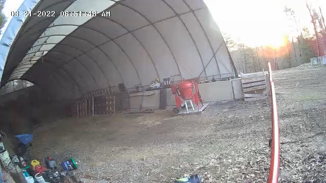

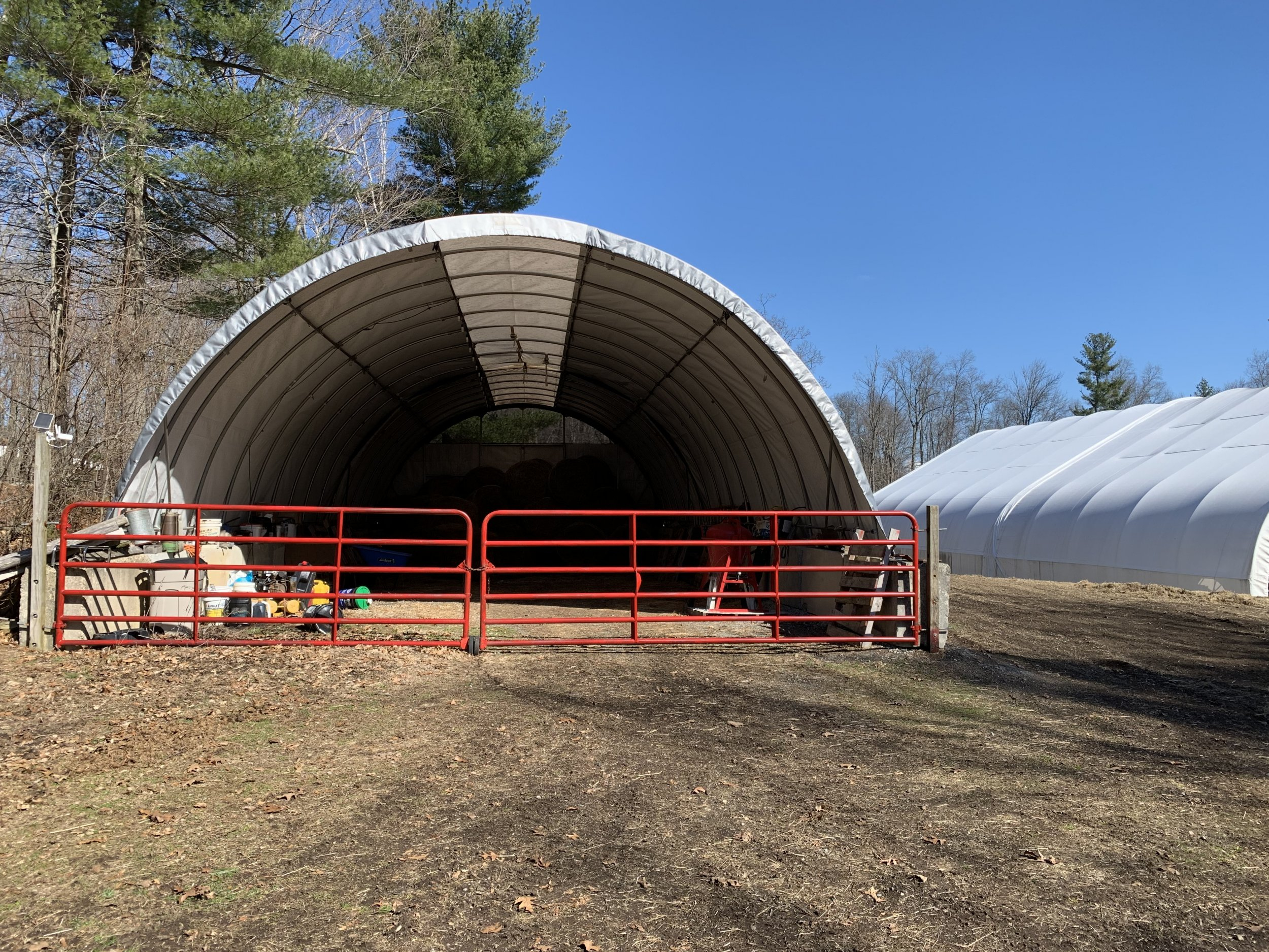

As an alternative. Did you look at pony wall structures from Clearspan. Look at their steals and deals. I put up a 24x26 with 16 ft of center head. I used 3000 lb cement blocks from leftover mixes from a cement plant but you could use pressure treated posts instead. Very quick to put up. Mine has been up 12 years and no problems. I also when back and added an additional 48’ 5 years after the initial shelter making 60’ long. Total initial cost was $7000 with breathable end panel at one end. The addition cost another $7000. It is used for round Bale hay storage and equipment repairs. That’s a 60x26 barn. Used gravel and Asphalt millings for floor. It stays very dry inside.

As an alternative. Did you look at pony wall structures from Clearspan. Look at their steals and deals. I put up a 24x26 with 16 ft of center head. I used 3000 lb cement blocks from leftover mixes from a cement plant but you could use pressure treated posts instead. Very quick to put up. Mine has been up 12 years and no problems. I also when back and added an additional 48’ 5 years after the initial shelter making 60’ long. Total initial cost was $7000 with breathable end panel at one end. The addition cost another $7000. It is used for round Bale hay storage and equipment repairs. That’s a 60x26 barn. Used gravel and Asphalt millings for floor. It stays very dry inside.View attachment 738359

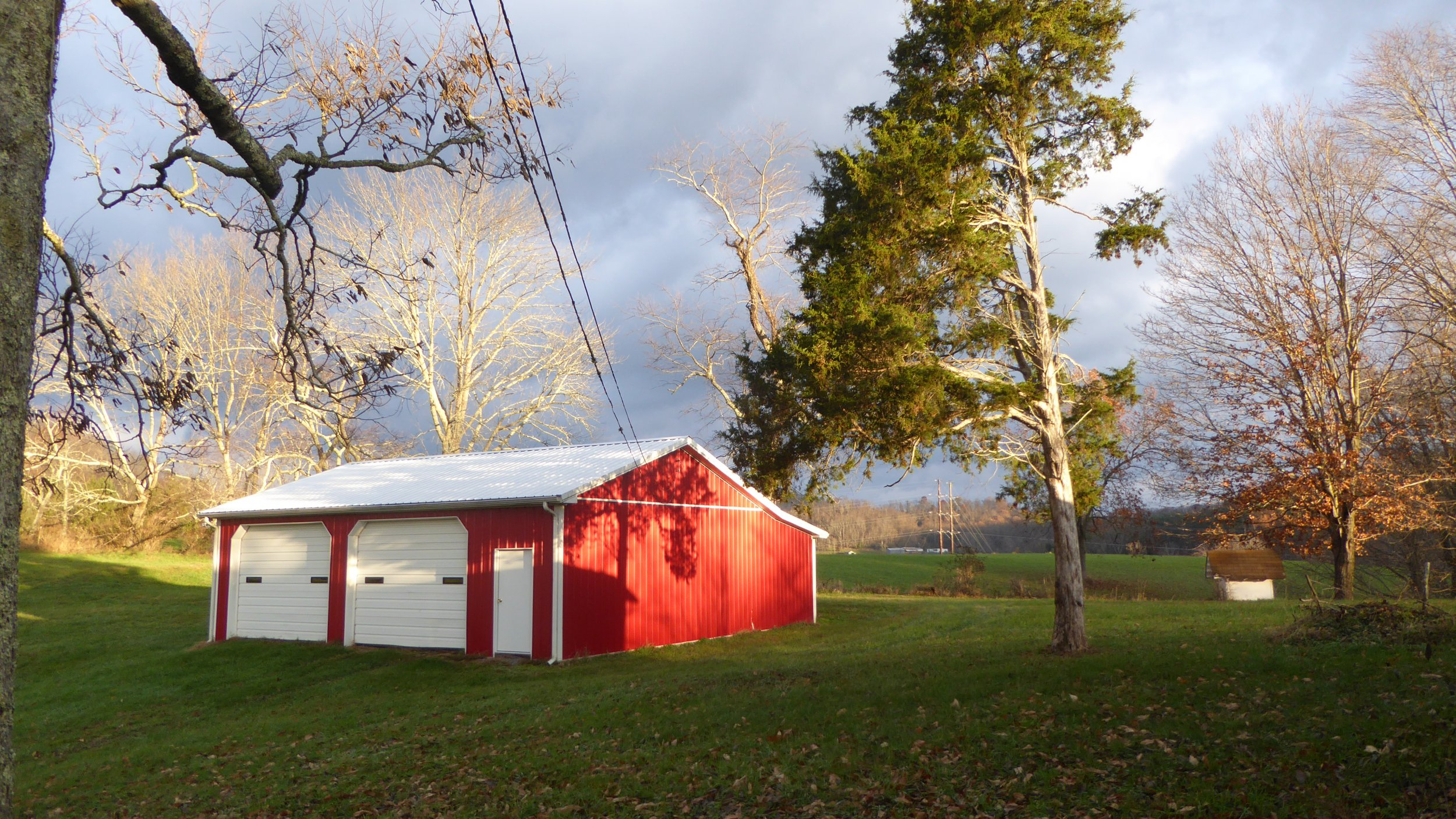

I caught the power company replacing poles in my area and asked if I could have some and they gladly gave me more than enough for the job. As I was setting the posts my neighbor stopped in and asked if I would like to have some steel for my project as he had taken down a large building and never put it up and would like to get rid of it, score. There was more than enough support beams and sheeting to do a 24X40 pole barn. My total expenses came to around $250 for bolts and screws. I used my TYM 234 with an extension on the bucket for lifting beams and did all the work myself. Pic is prior to putting up the trim but you get the idea.
